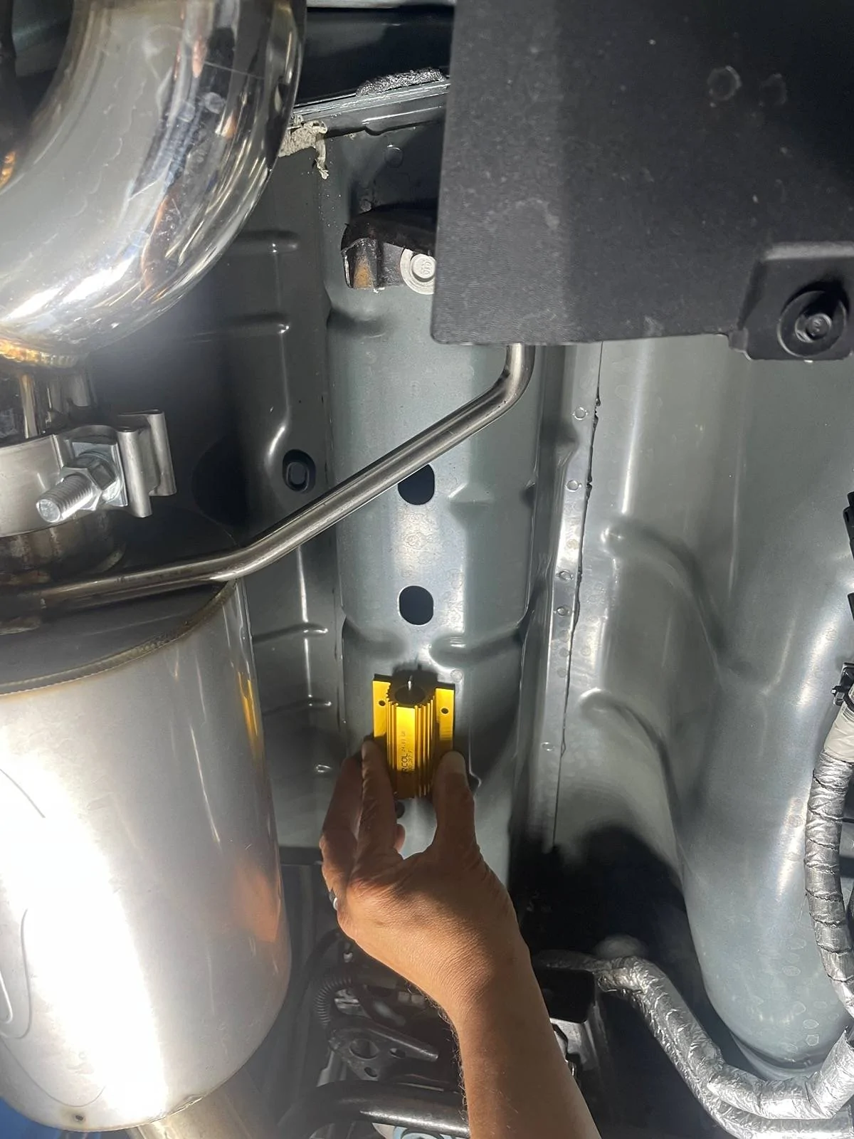

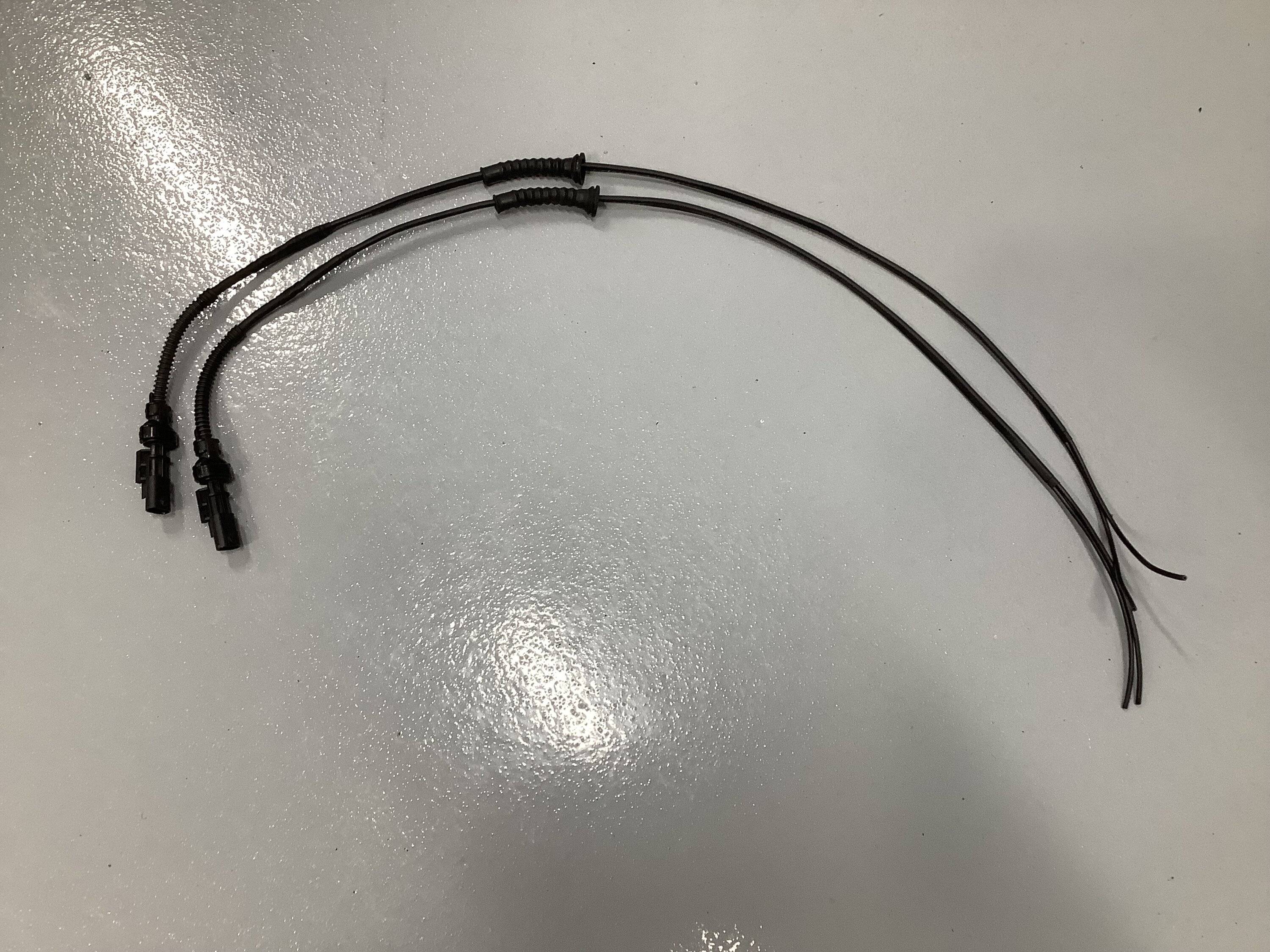

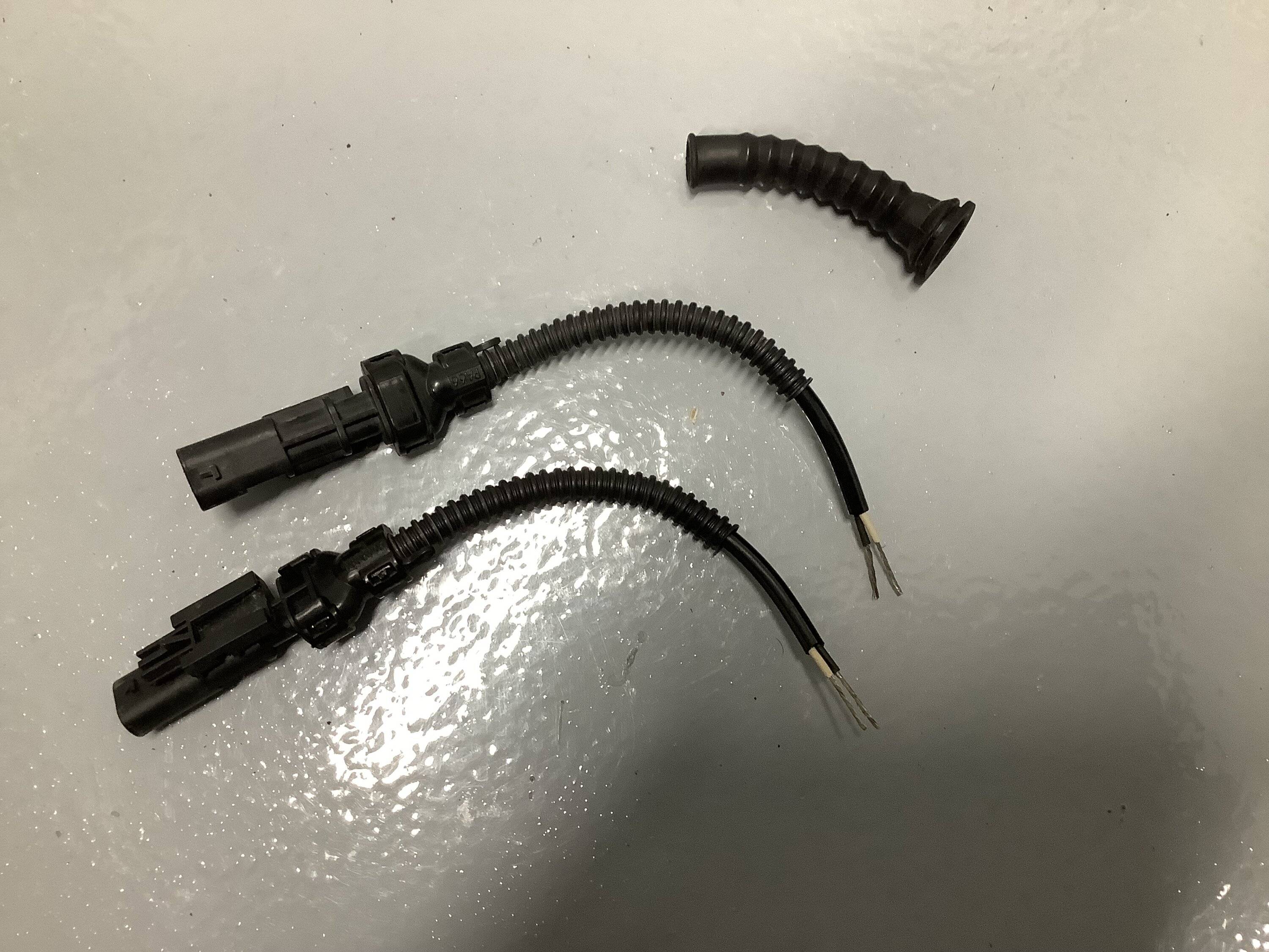

So far, I’ve cut the pigtails off of my factory Magneride shocks, soldered extension wire onto them and used heat shrink on them for a clean look. I slipped the rubber boots back onto the pigtails, in case I need to drill a 9/16 hole through the car, in order to mount the resistors on a panel inside that is away from the elements and to also serve as additional heatsink. I should have the resistors in hand, later in the week and can button things up and see if it works.

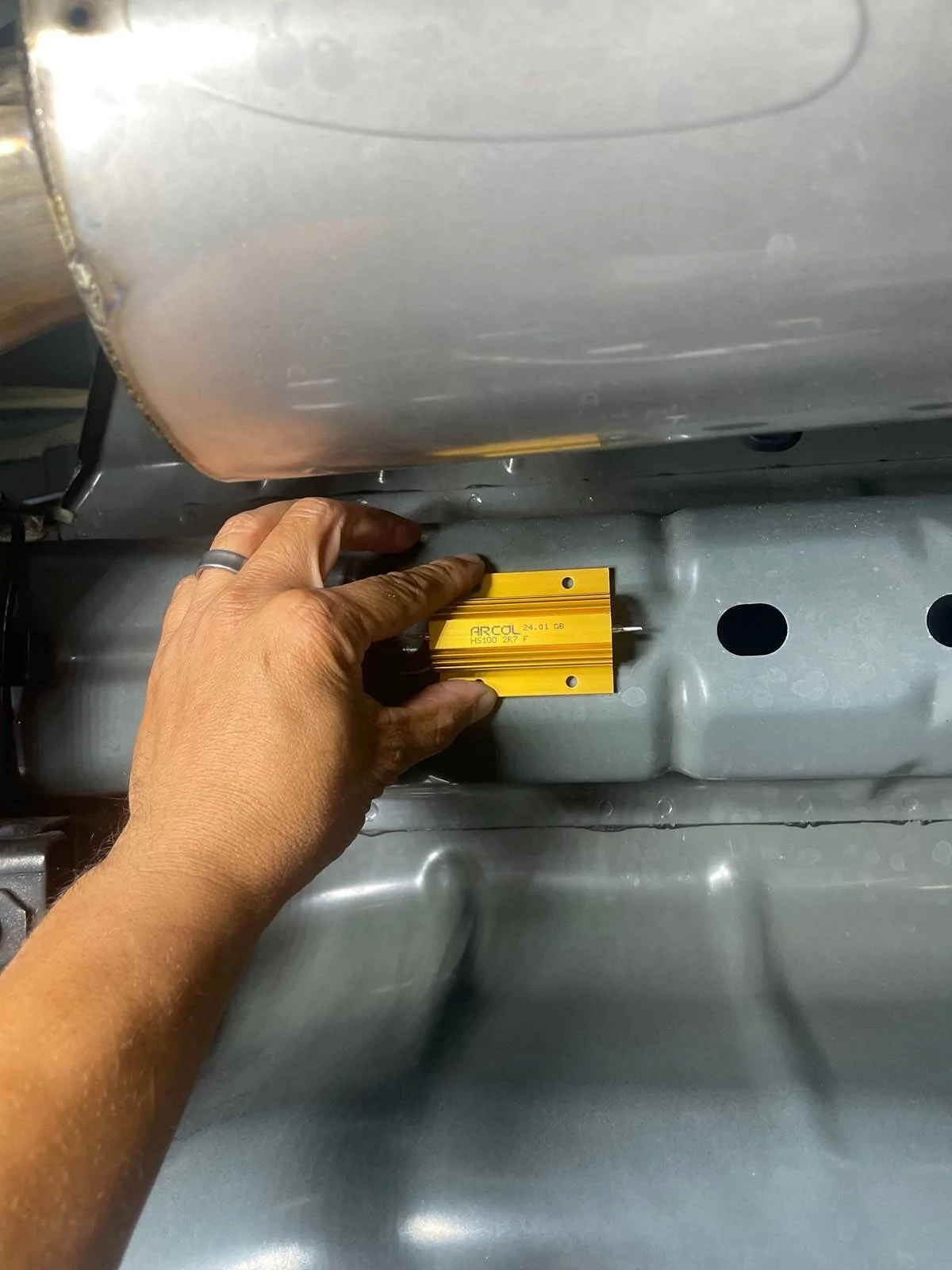

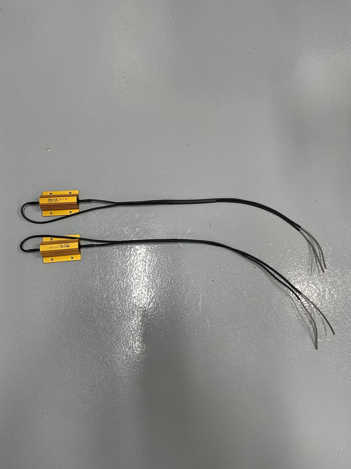

The resistors arrived and I’ve soldered the wires to them. Just waiting on nutserts and special size drill bit to arrive now, and then I’ll drill the rails on the underbody of the car to mount them and solder them to the pigtails that I made. More progress pics/videos.

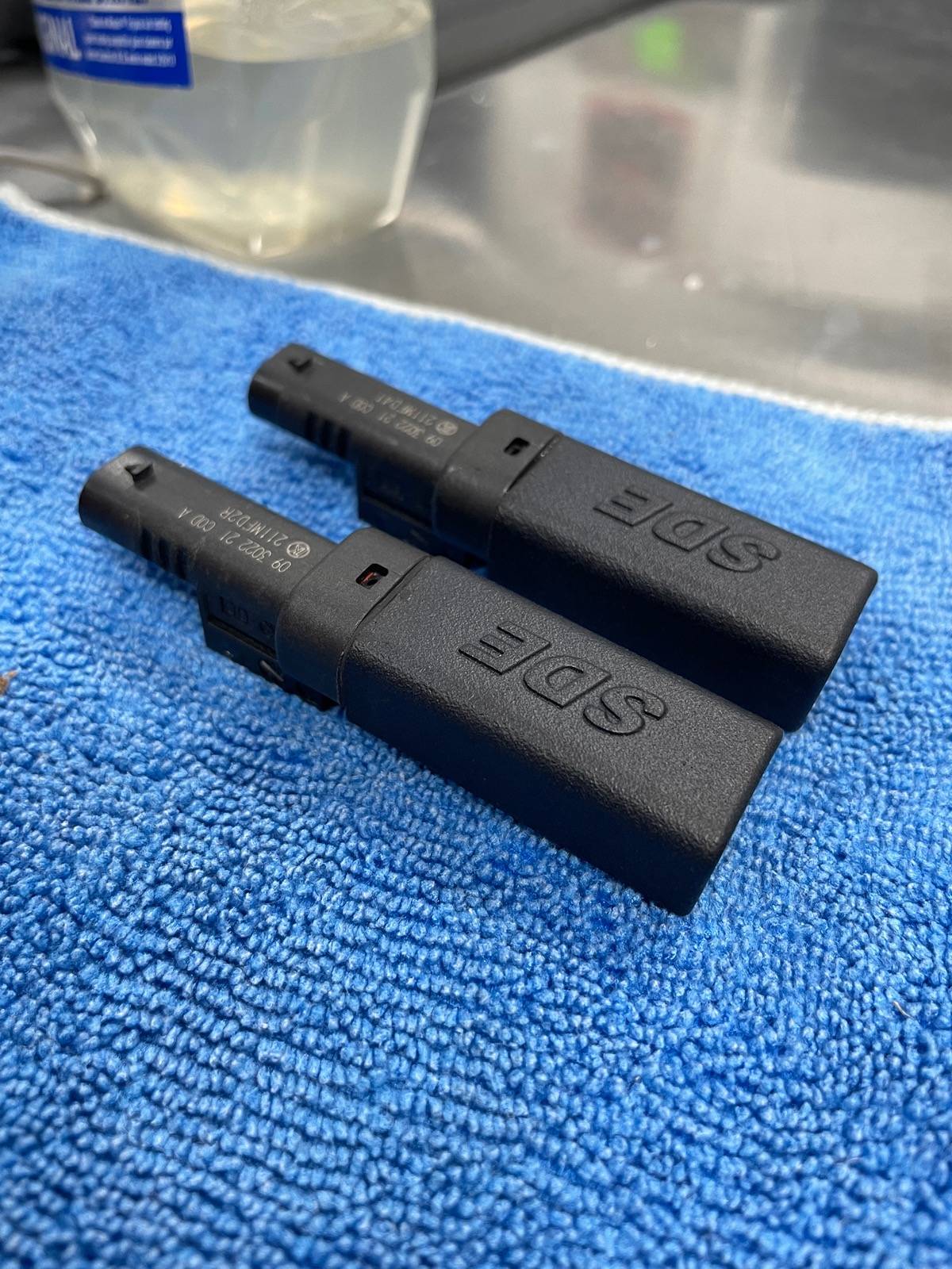

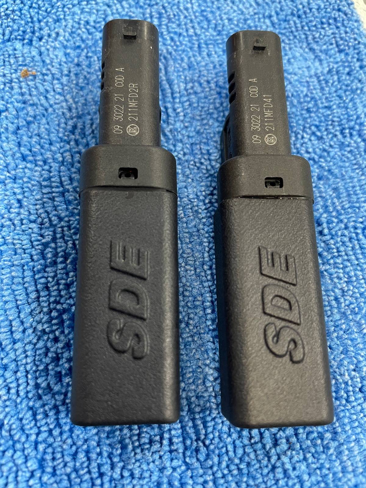

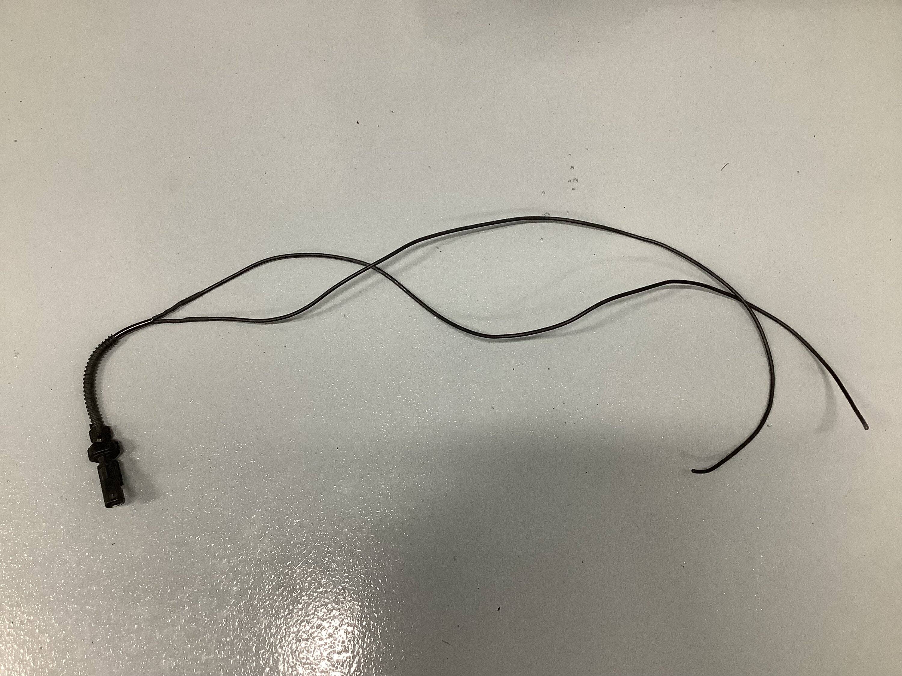

Here are the Shock Delete Engineering sensors that I removed, as they only worked intermittently. I don’t know if SDE has since revised the product, but I know I’m not the only one to confirm that they didn’t work well.

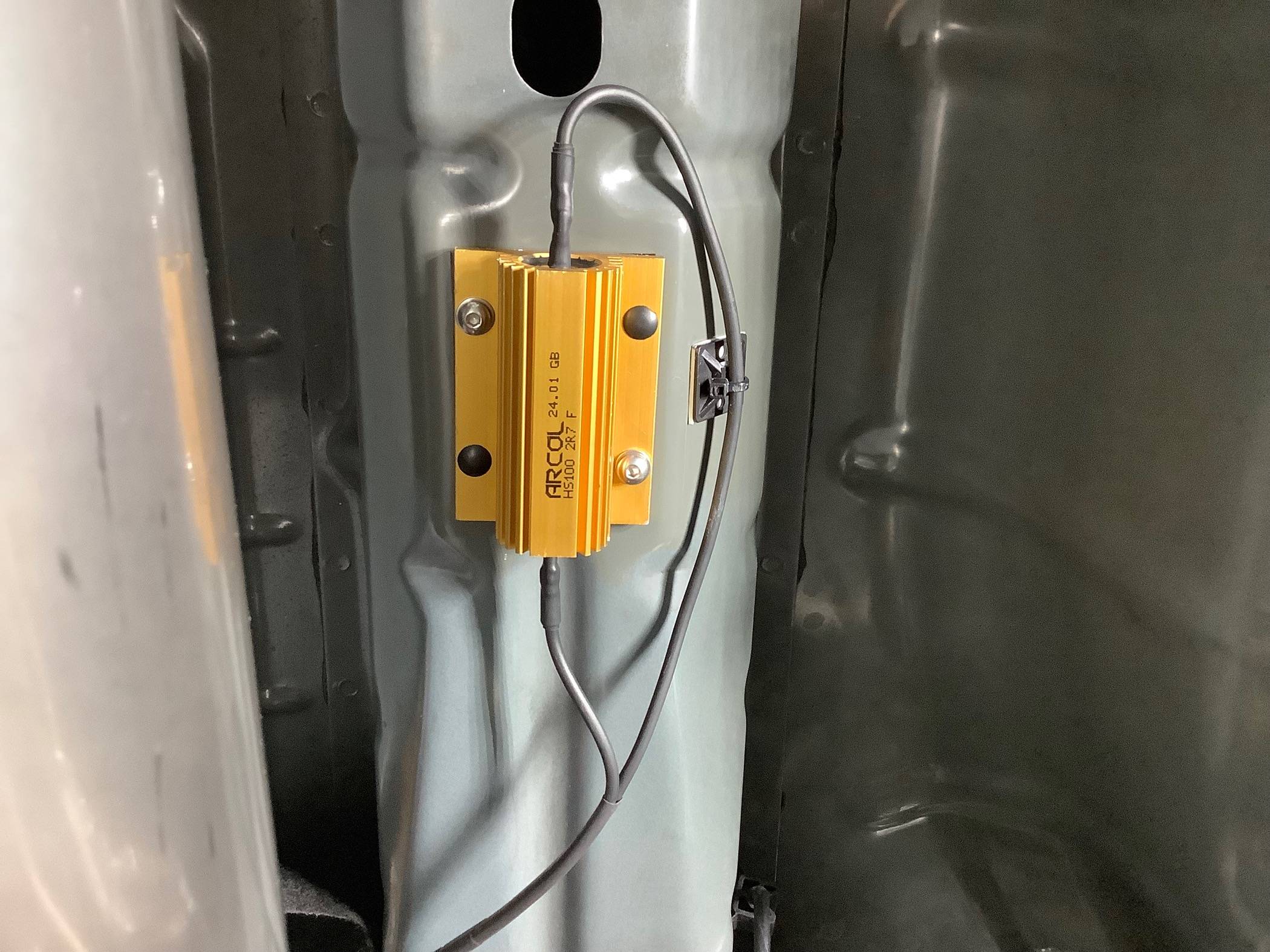

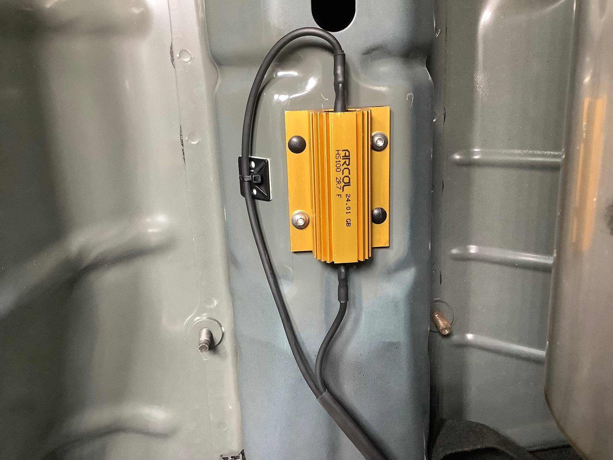

Finished product! I still need to test drive the car and see if it’s void of any warning lights though. So far, nothing popped up during a startup and warmup. I’ll report back with my findings soon, whether good or bad, but I’m hoping for good news.

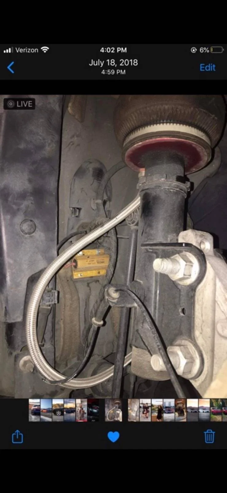

That’s really a great idea. I actually thought about mounting the resistors inside the car, but after talking with the guy, who did the writeup on it, he said his have been used in the harsh environments of Seattle (not weatherproofed) for 5 years and 100K miles and he’s had no issues with them. He sent me this pic of one of his front sensors mounted on his Camaro.
The other thing is, the area that I chose for mounting mine has been clean and dry (no sign of any water or rubber from the burnout box), and it should serve as a really good Heatsink. However, if I do encounter any issues from mounting them there, I’ll definitely circle back to the idea of mounting them inside.
