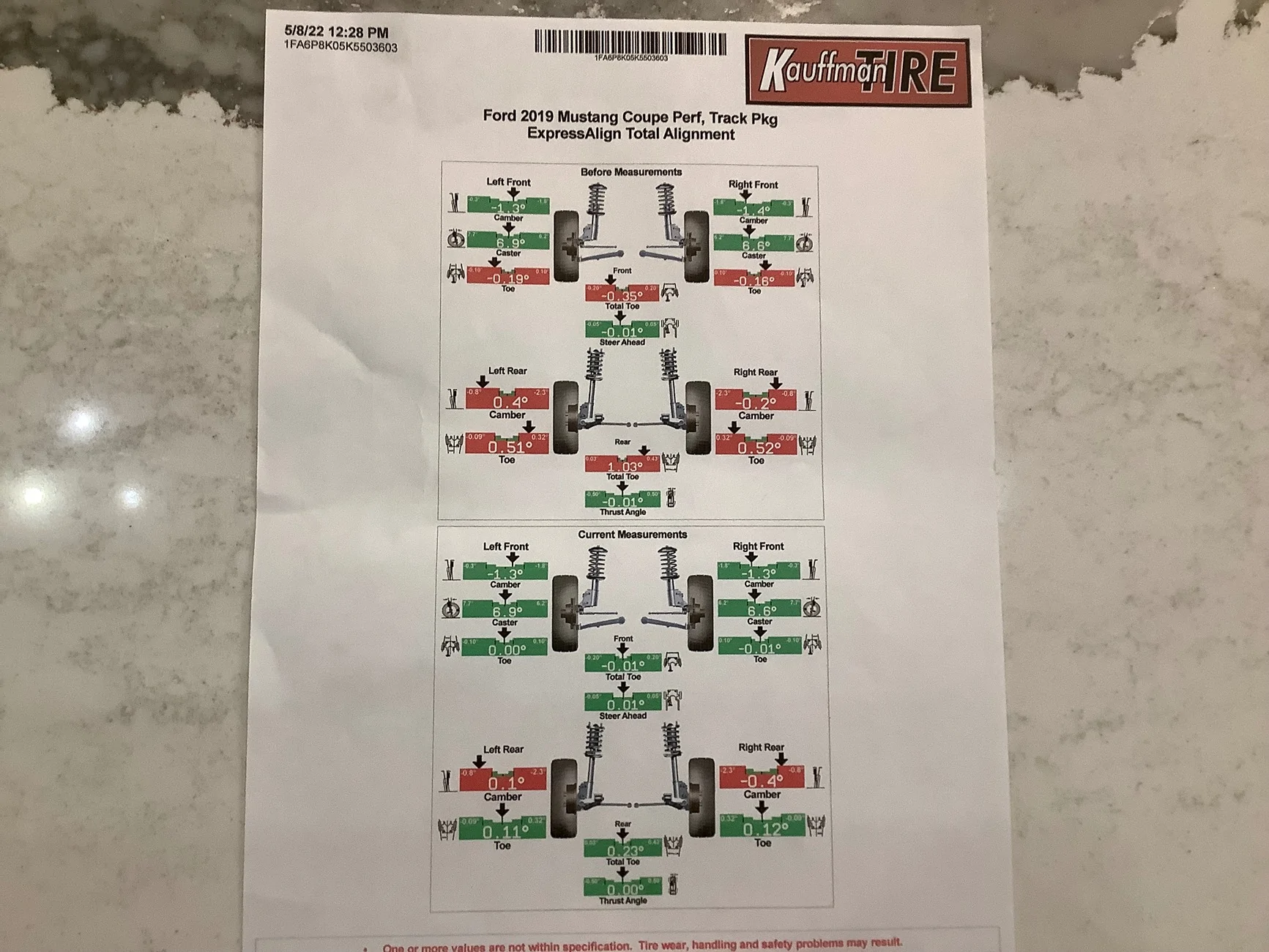

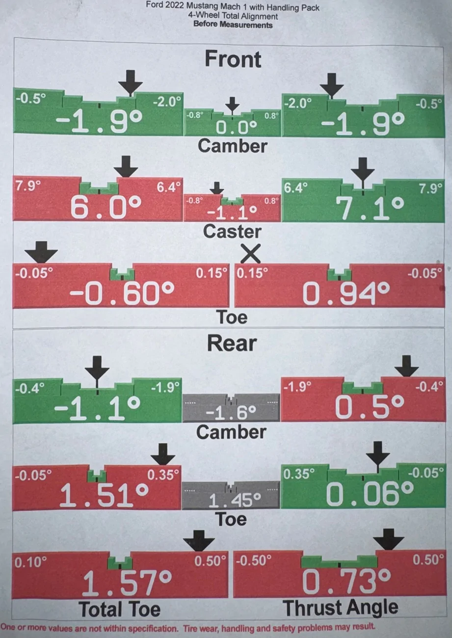

No wonder why the car was driving soooooo bad. To think that the shop literally took my car to get a alignment of which they sent me a picture of, and it come back like this.

Wow, that was worse than mine when I brought it in. Bet it feels like a new car now!

They couldn’t get the camber in the rear around .50? Or less? Still quite a bit for drag racing. Factory is supposed to be -1.5 in the rear.
Night and day difference! Not sure if it’s perfected yet but we are moving in the right direction. The car was scary before when I drove it.

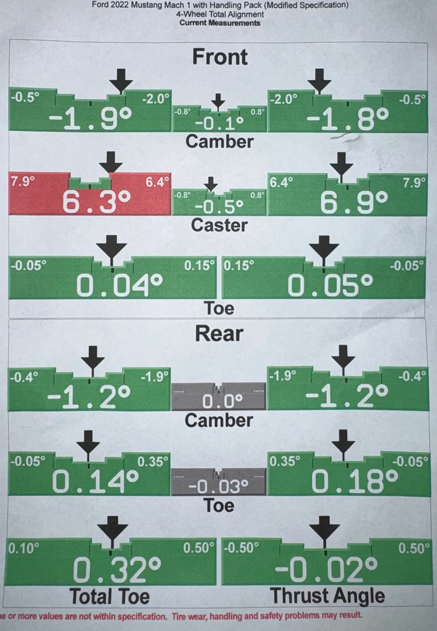

Here’s my alignment sheet for street/strip racing.
If I don’t like mine, I will ask them about adjusting to your spec. I will find what works.
Good question. I don’t know anything about alignments but it look like I’m in for somez learning.

The less negative camber in the rear will maximize contact patch hence more traction for straight line. I went with somewhere in between street and strip at -.5. Pretty Drastic improvement in 60 ft time vs Factory. If you’re really serious about the strip you want 0, close to it or even .25 positive. When the suspension squats on launch it will be near 0. If you want street/strip then my setup or NGOT8rs will work great. Now it won’t handle quite as well in the turns but doesn’t look like that’s your jam anyways. The front looks fine, I would rather give up a little bit on 1/4 mile time and have better handling at 135+ mph. Mine is not supercharged but when I made the changes to the setup it tracks dead straight street/strip and puts the power down better. It used to slide the rear a bit on the 1-2 and 3-4 shift when it barked the tires but now it doesn’t. Good luck and love your car!

Thanks for the info…
