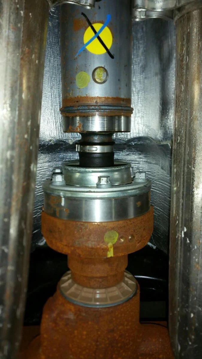

Triple Black
Jun 21, 2015
Ohio
Nathan
2015 GT Triple Black, Premium, GT Performance
What do you think???
