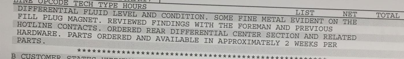

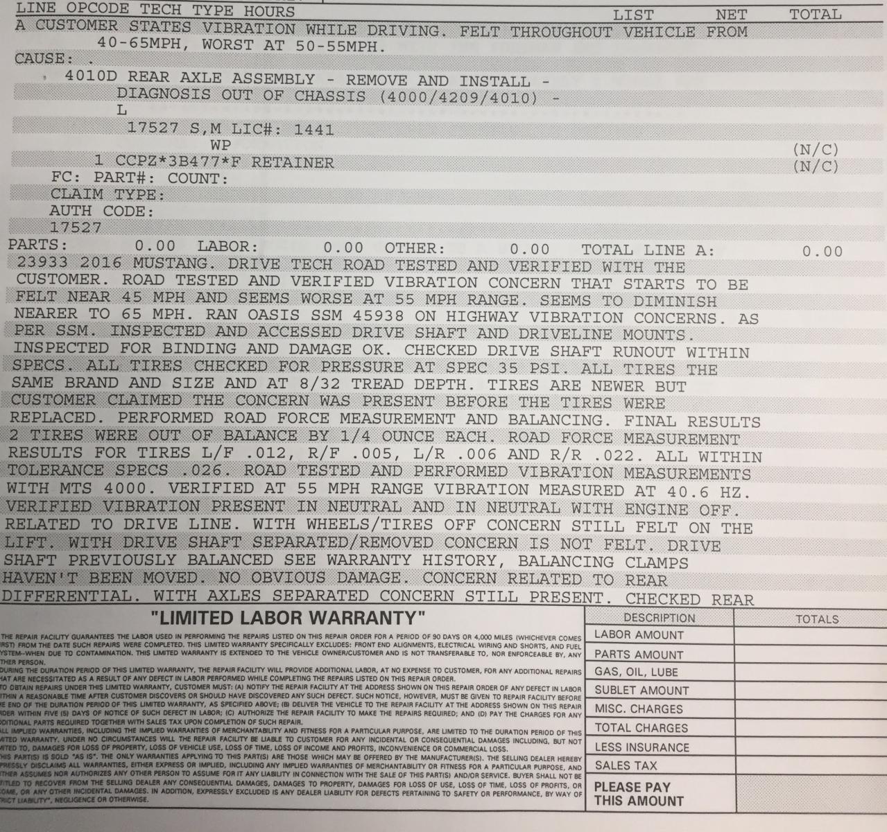

Cobra Jet
Feb 12, 2015
771
17,615
20,077
Here's the scans I promised to include from my Dealer Service Center work orders from my last visit on 04/24 and the diagnosis. Take note of the harmonics Hz measurement... and my vehicle has already had the prior work done (and extensively documented previously in this thread) due to the ongoing driveline vibe:

I have been told from someone at Ford at a local track event, that the vibration issues may steam more from center support bearings than anything else.
Take that for what it is worth, but I see alot of other parts being thrown at this with little change.
I would caution the continual referencing of A Faster Horse as "well documented" evidence of this issue. The fact is we truly have no idea of the complete context of what that discussion was.
Posting dealer service notes however is great for the community. Your dealer has been very thorough and that will help any here trying to stick it out.
