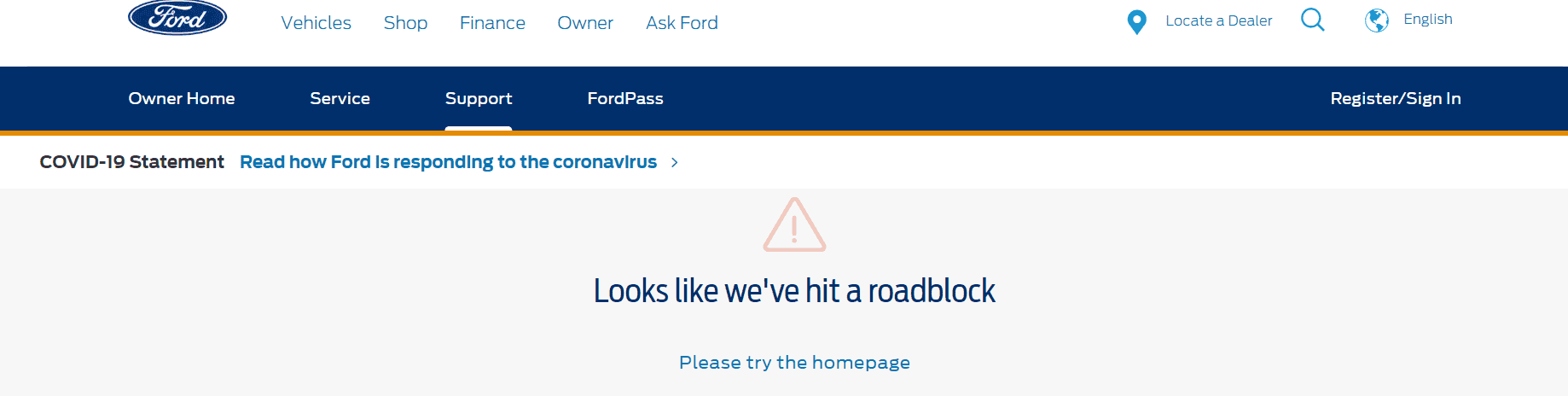

Well Ford has disabled the instructions from the NotMyFord owner's site:
However, I saved them from my valiant attempt to update the maps....
Download Instructions & Installation Instructions:

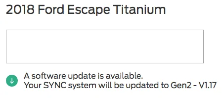

I figured it's a map file, but you know how it is, you start reading forums and get overwhelmed with info. :)
Is this an okay file? That's what came up for my VIN, but not sure why it says "gen2" or "v1.1" when the version I have is 3.3. So many versions and builds and generations...
I noticed something similar when I downloaded the Sync update for my car last night. At first when I checked for updates it came out with an actual Sync 3 version number. Then when I hit download to USB it switched to "gen2 v1.7". It kept showing that text every time I checked for updates. However, when I checked back again this morning it went back to the Sync 3 version number. I downloaded that and compared the files in the different downloads and saw that they were the same. I installed the update this morning.

So here is something interesting. I'm on the phone with Ford CS now trying to get a download of 1.19. I'm also on Ford Owner. Look what comes up what i checked for an update on my wife's 2018 Escape with 3.0.......

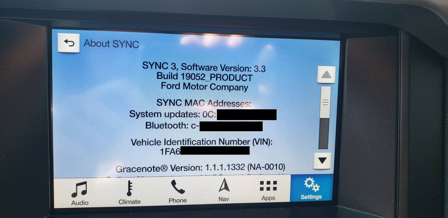

I have installed the SYNC update yesterday. It was a weird file called that what I've listed above (for my VIN), I've had 3.3 build 18xxx, but after this file (yes, name weird Gen2 whatever) was installed via flash drive, my SYNC has updated to 3.3 build 19052, which from my understanding on this thread is the newest you can have right now (with 3.3 that is).
My maps are being installed as we speak, hate having to let the car idle, but don't have anywhere to drive anyway (thanks covid).
Still debating the 3.4, am scared, but the modern look and mainly AA directions in the cluster + long 18-station ribbon (instead of 3 six-station ribbons) on the audio intrigue me like crazy. Enough to mess with warranty, that I don't know. View attachment 483760

That's what I thought. What's strange is that i know my wife's car has the latest version/build but I may download just for the fun of it.
Good luck with the maps. I'm still waiting for Ford to fix their website so that it no longer tells me that I already have 1.19.
