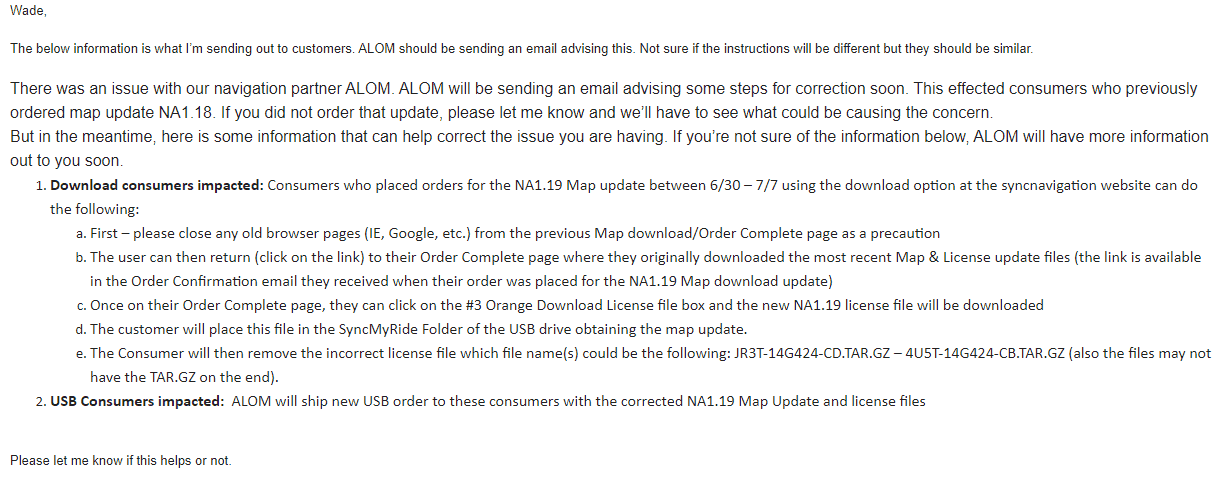

ive actually tried to download the license file a few times now, and its still only letting me download CC license file..
i am in contact with support though, through email, and they gave me a nice little bit of info, which coincides with what you're saying.. see the image below i clipped from my email to support..
EDIT: so i have had some email conversation with support. after some back and forth i sent a reply back with the filenames of each and every file in my map update (syn32.zip) and listed the file name of my license file.. all of which can be found in the screenshot in this post: https://www.mustang6g.com/forums/th...-update-june-29th.143298/page-21#post-2954499
the support agent i spoke with assured me that those files are indeed the 1.19 files, and that my license file is also correct (4U5T-14G424-CC.tar.gz), and that if i were to install those files, i would be running the 1.19 version of maps.
when i responded and said that is the version i installed but the version number in the "About SYNC" screen had not changed, the agent then mentioned the bug that @Bikeman315 has been talking about. in SYNC 3 3.3 (and only 3.3) there is a bug where it will not list the map version OR gracenote version correctly. however it will be fixed in the next version of SYNC.
they didnt tell me what the next version number was (assuming 3.4), however they did say that they are currently working on it, and COVID-19 has held up the release because all the engineers are still working remotely.
so there is still hope out there for a 3.4 release... soon™️
