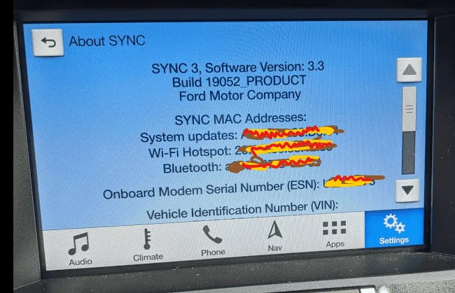

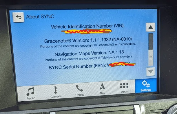

whos the first person that can show a screenshot of their nav version showing NA1.19?
curious only because i downloaded the files, installed them, and my sync screen still shows 1.18.. then 2 days later when everyone was downloading their files again.. i downloaded the files again did a bit by bit comparison.. same files i downloaded the first time. so no reason to install it again..
if some are showing the updated version then you'd think everyones should.. so if thats the case then i guess i need to get back on the phone with tech support so i can understand why my version # never updated when others did

Wade, what version did you have before you updated. There was a bug in 3.3 that prevented it from showing 1.18 so even though you had them your screen showed 1.17.

1.18 on my sync 3.3 was what it came with
thats what it showed before.. thats what it shows after the update
