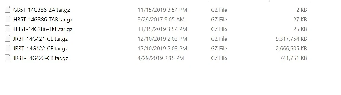

Can someone who has successfully installed it post the file names and the license file please ? I am sure there is a small mismatch in either the license.txt file and version.der certificate, and it fails to install due to that...
The license.txt file has a different entry than the version.der ... license.txt in my case is:
JR3T-14G421-CD
The version.der contains the following:
Ford Part Number = JR3T-14G424-CD
Type = License
ESN = WV4E01RP
File1 = License.txt
File1 Hash Value = 55cec5ed962f2c119ddfaf6d5f4853730ab3d5d1a4853b6ca4640fefff230e00
File1 Size = 14
Save Location = /fs/rwdata/
and this is the contents of my map files (i.e. SyncMyRide folder before adding the license file inside):
