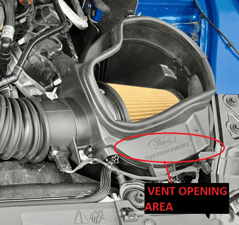

Mach1 and Bullitt hood vents are the same as the GT with the black plastic underneath, but the hood insulator is different. If you put a GT hood insulator on a Mach1 (or Bullitt), the drivers side hood vent will dump water onto the open air filter. With the different hood insulator, water flows through the hood vent and it dumps onto the hood insulator and runs to exit out in the slot at the very front. This picture of a Mach1 hood insulator will explain what I'm talking about:
This is an interesting observation.
But it then begs the question for those who have the PP performance upgrade which has the Bullit CAI/Throttle body - do we need to do anything to divert the water from dripping right on top of the intake air-filter.
I guess a few drops might not be a problem but I am sure under heavy rain it might not be a good idea.

The M-9603-M8B kit has a different lid/gasket design than the Mach1 or Bullitt. It is shaped so that water drips out in front the air box onto the flat area where it says "Ford".
Cool - one less thing to worry - the Ford engineers already thought of it!
Very informative, thank you! I had this CAI installed on mine by the dealership when I bought it new.
