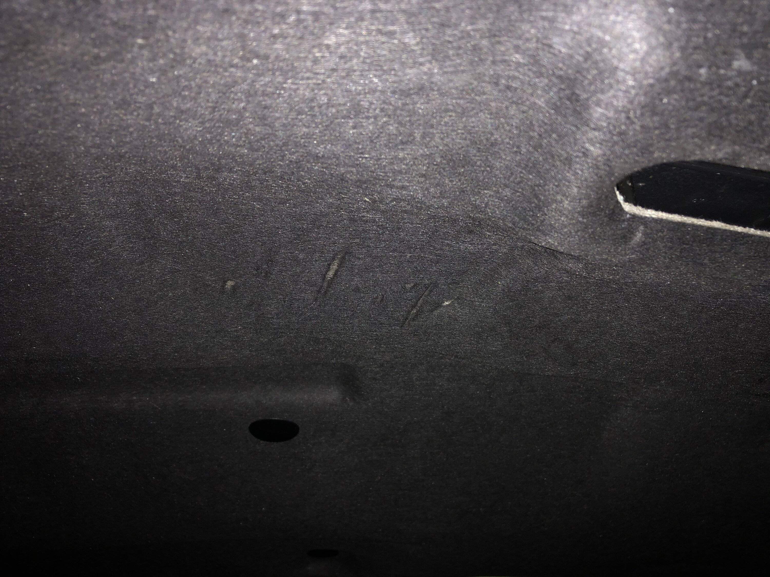

How many members have removed there underhood insulation cover? I just added the SCHROPP upper strut tower brace and it seems to be hitting the underhood cover, causing pitting marks on polished aluminum whenever it rains or i wash the car. I think if i remove it wont hit anymore. Just wondering about the hood vents and water?? Any thoughts?

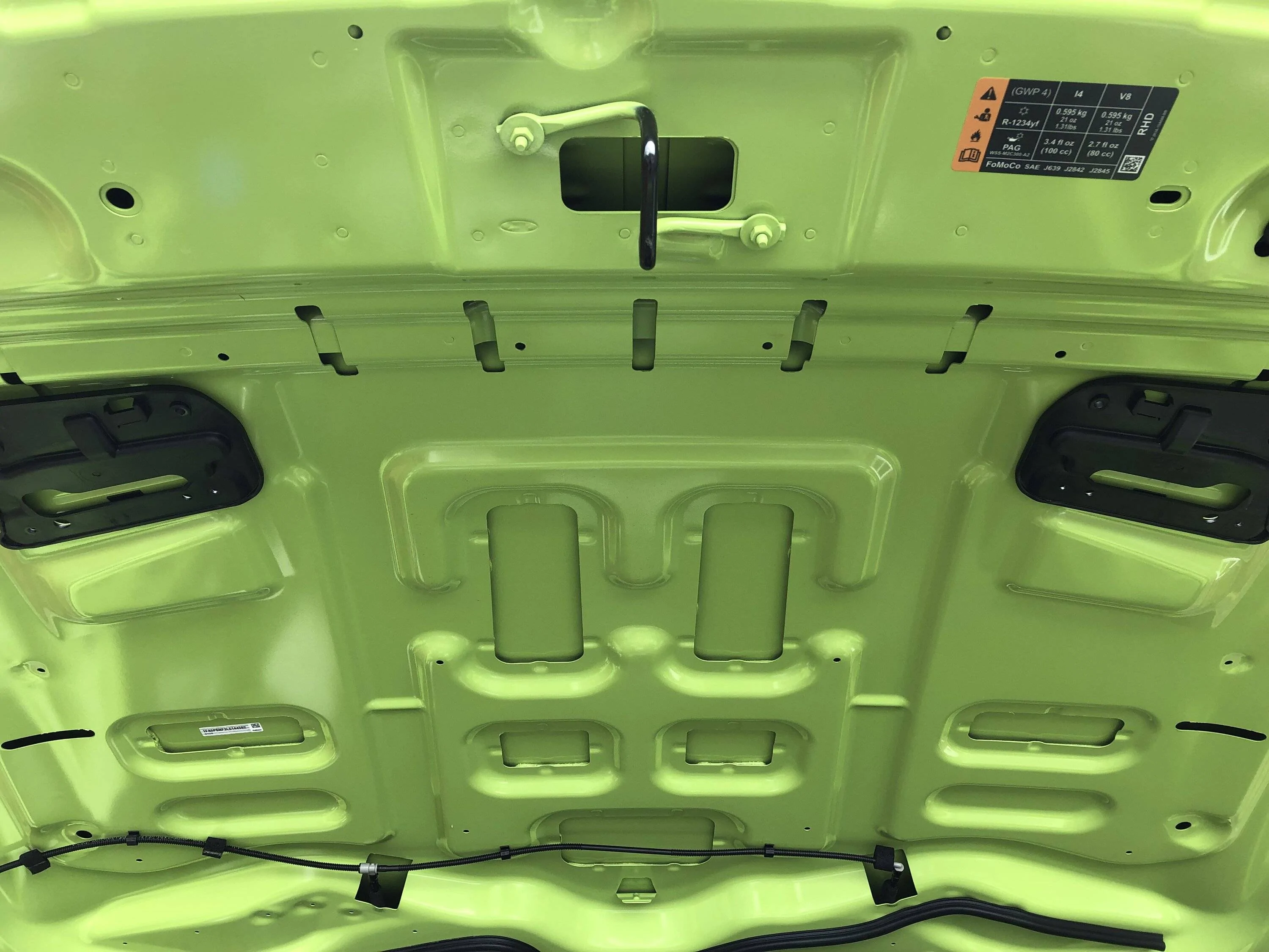

Unfortunately, I don't have the luxury of a wholly enclosed garage, so my ride sees plenty of rain. No issues. Mind that it all makes it down to the engine anyway, cover or not; that insulation's got a big gaping hole in it too. It also gets wet and holds that water, which is probably what's causing your issue with the STB.
Like say, I vote go ahead and yank it. Get a trim removal tool and pop the pins carefully. I would also highly suggest putting a piece of cardboard, or towels, something over the engine to catch any errant pins that have a mind of their own. Worst comes to worst, you can always put it back.
If it's any further motive, it might sound a little louder, too. :giggle:

Thanks again for the reply, appreciate it! Same here, my car is outside in rain, snow etc.. Im gonna try and remove and monitor the water as well. Those 2 big holes are for the drains that are connected to the hood vents, they catch water and direct it out the sides.. as well as allow air up and out as small as they are.

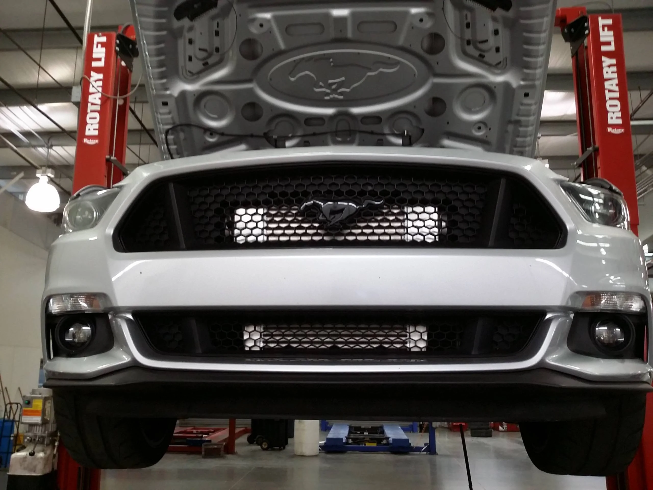

All gone here .
that poney is behind the cover, if yes I see a load of covers being tossed, and the best reason yet to dump it.

It's not there on an 18+ ... :frown:
