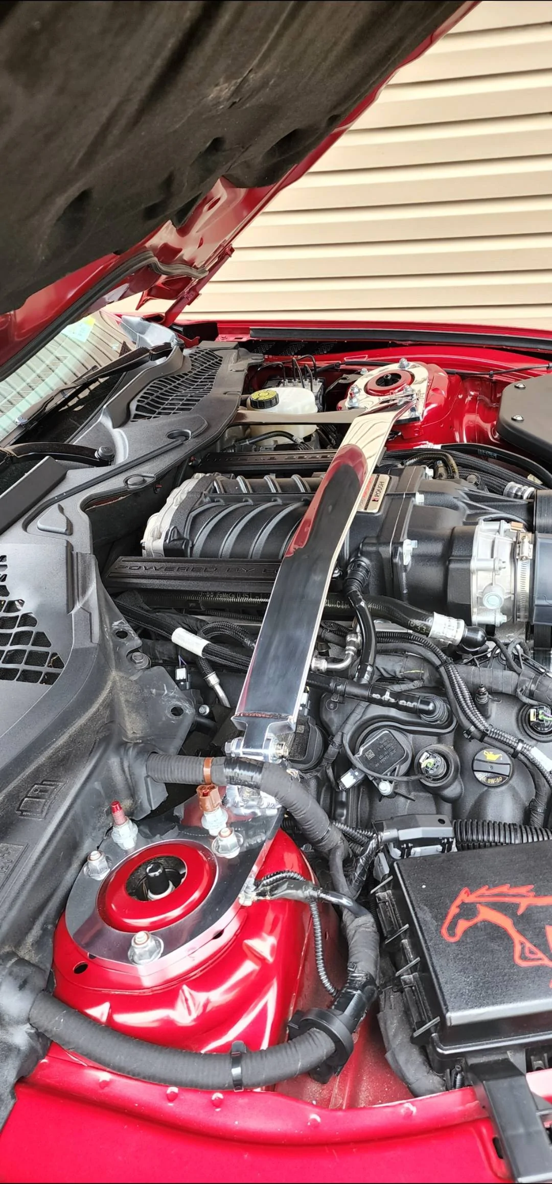

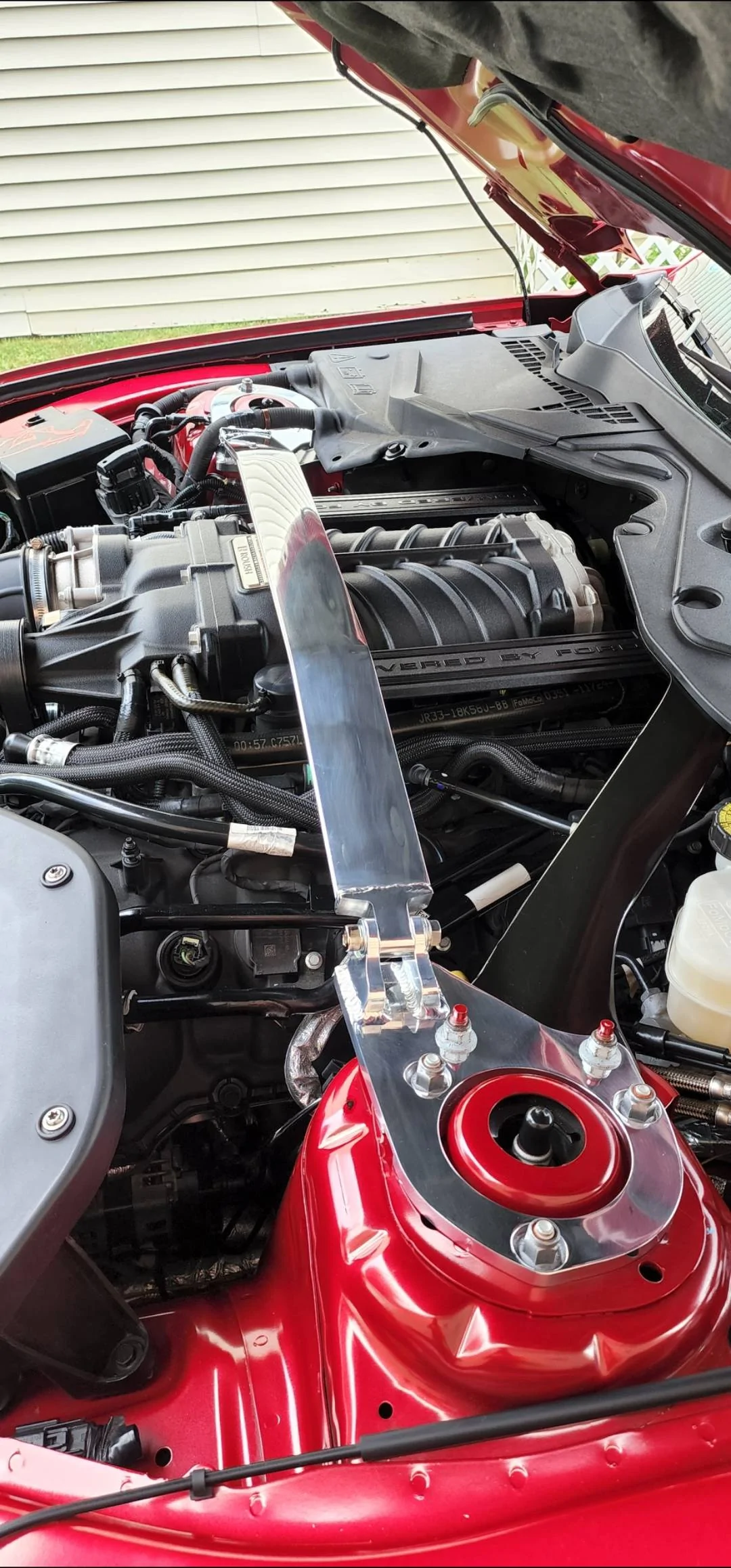

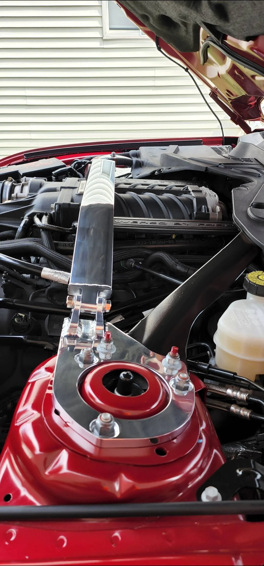

This is my issue, hood insulation is rubbing on brace and water combined w heat is staining the aluminum causing a pitting of sorts.. I wanted to purchase brace powdercoated black from Schropp via germany, but the 2 month wait wasn't worth it for me, so I took polished aluminum. I don't feel like cleaning and repolishing brace weekly, firget that. The hood insulation will go...

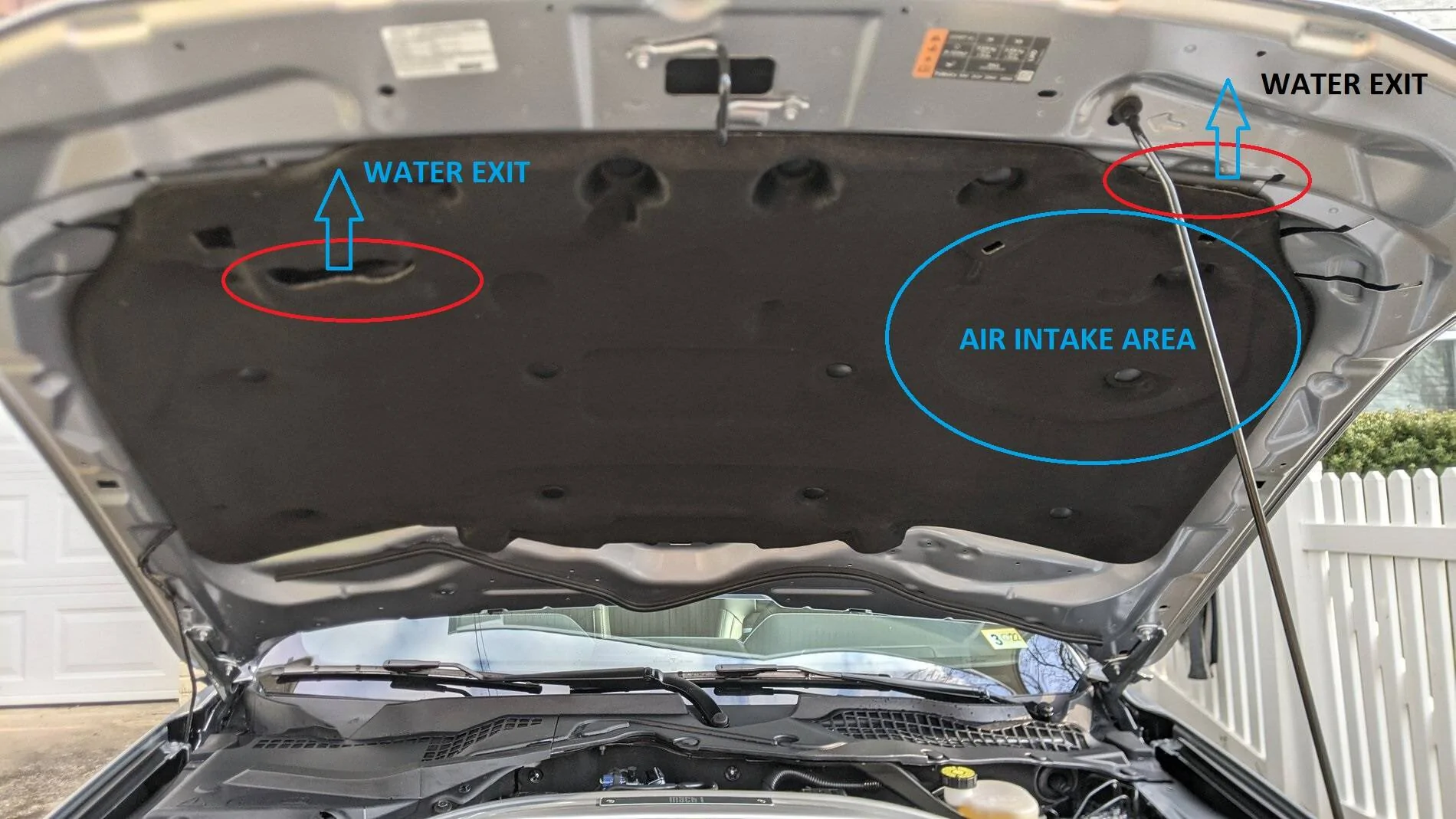

I would remove mine but... it is needed to seal the open air intake to the hood. The intake box gasket leaves a defined imprint in the hood insulator and removing would leave a huge gap for hot air to get in. The Mach1 and Bullitt models are the same. The hood liner is different on those two models though. It channels water from the hood vent out in front of the intake box. Changing to the GT500 intake box would solve this issue. Out comes the credit card again. :facepalm:

Mach1 and Bullitt hood vents are the same as the GT with the black plastic underneath, but the hood insulator is different. If you put a GT hood insulator on a Mach1 (or Bullitt), the drivers side hood vent will dump water onto the open air filter. With the different hood insulator, water flows through the hood vent and it dumps onto the hood insulator and runs to exit out in the slot at the very front. This picture of a Mach1 hood insulator will explain what I'm talking about:
WOW!!! very interesting, thanks for sharing... Just learned something today!! =) Plus, there is no hood vent opening in the insulator on drivers side, only passenger.
