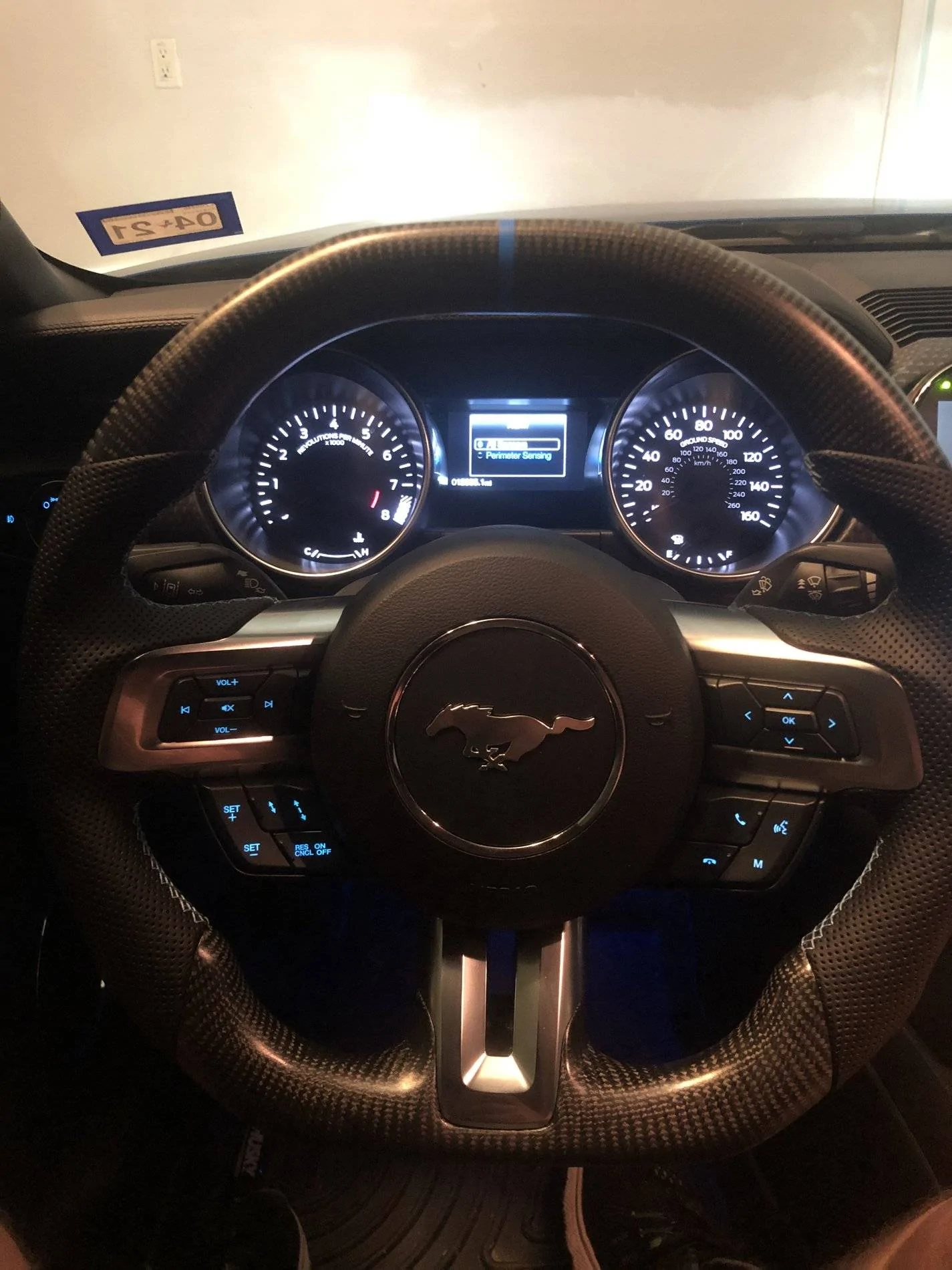

As for the steering wheel itself, I got it from Carbon Bargain. Went with a flat top/bottom dry carbon and perforated leather wheel with a blue center stripe and blue stitching. I think it looks great and feels really nice. Here's a quick pic I snapped after finishing up the install last night. I'll take more pics in the sunlight this weekend, if anyone wants them.

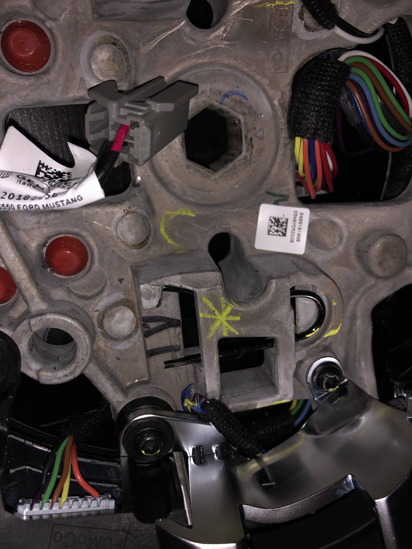

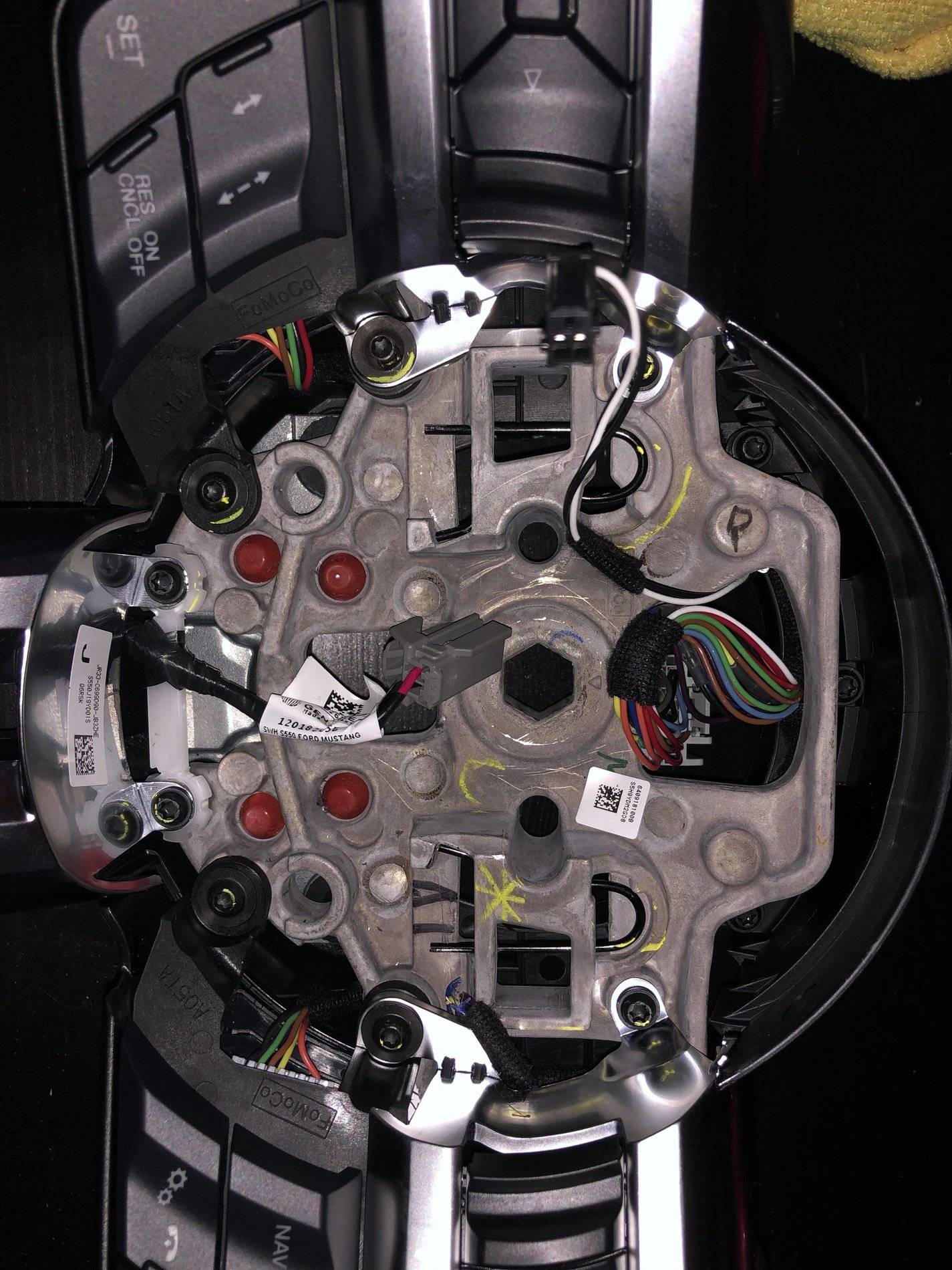

I have a 2020 Mustang GT, be careful when sticking a tool in there (I used an allen key exactly like CJ Pony said too). I removed my steering wheel today to replace it with another one, and I cut a wire to my controls because it was in the way of the spring from the Factory!!! (See attached Pictures, you'll see the blue wire on the right side of the wheel that was cut because it was in the channel for the air bag spring!)
I had to sodder the wire back together and use heat shrink tubing around it to repair it. Pissed me off, and then to top it all off, when I put everything back together again I got an AirBag warning light.. I tried to pop the AirBag off again, but this time I spent hours trying to pull the damn thing off, but couldn't get it. Only 1 side at a time would pop up, and I could never get the other side to pop off without first re-attaching the other side.. frustrating to say the least, my hands are raw from trying over and over.. I gave up, reconnected the battery and to my surprise the AirBag light went away?
Pain the ass design...
See pictures:
