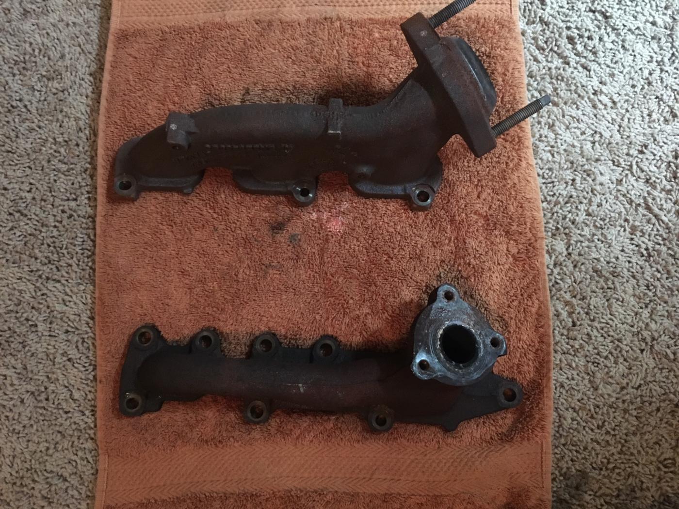

this is gunna be awesome! I was just talking to eric about your car yesterday, and hoping for a sweet outcome, cause id love do do this too!!!!! man, I bt it would help to port those manifolds!

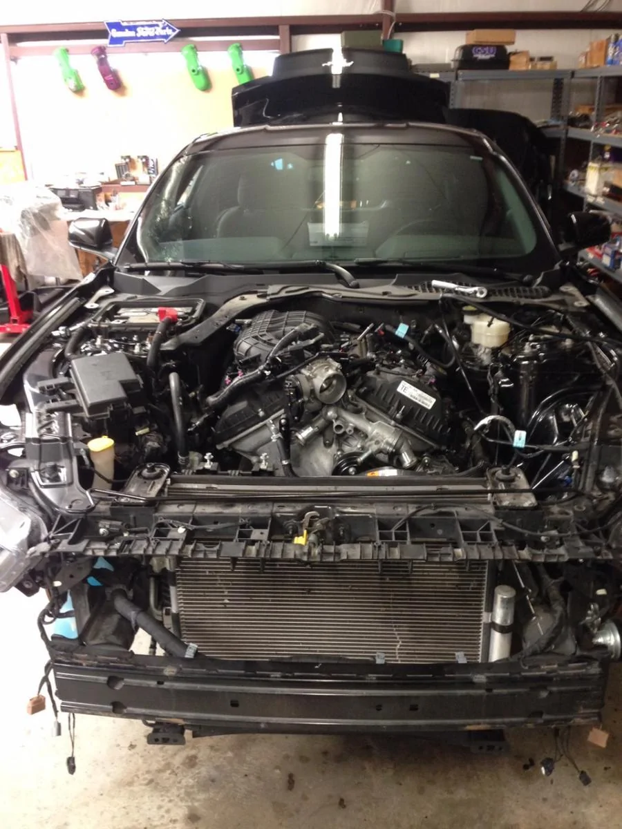

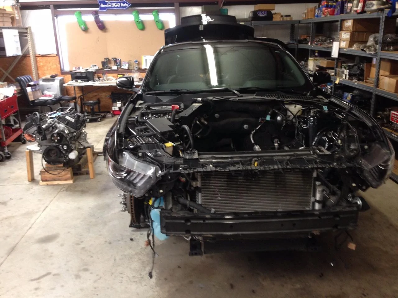

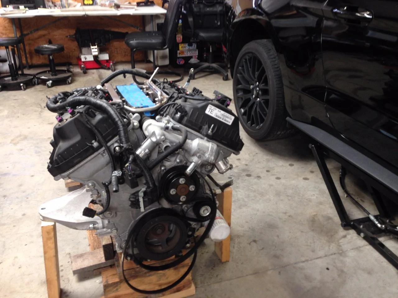

Tom has got the engine out of the car! The turbos and exhaust manifolds are next to go on the block. After than, Im assuming the engine will go back in and the intercooler will be installed so the piping for it can be fabricated..

Man that's got to be so scary lookin to see your engine out of your car an all those wires and dangly things hanging about! Tom knows what he's doing though.

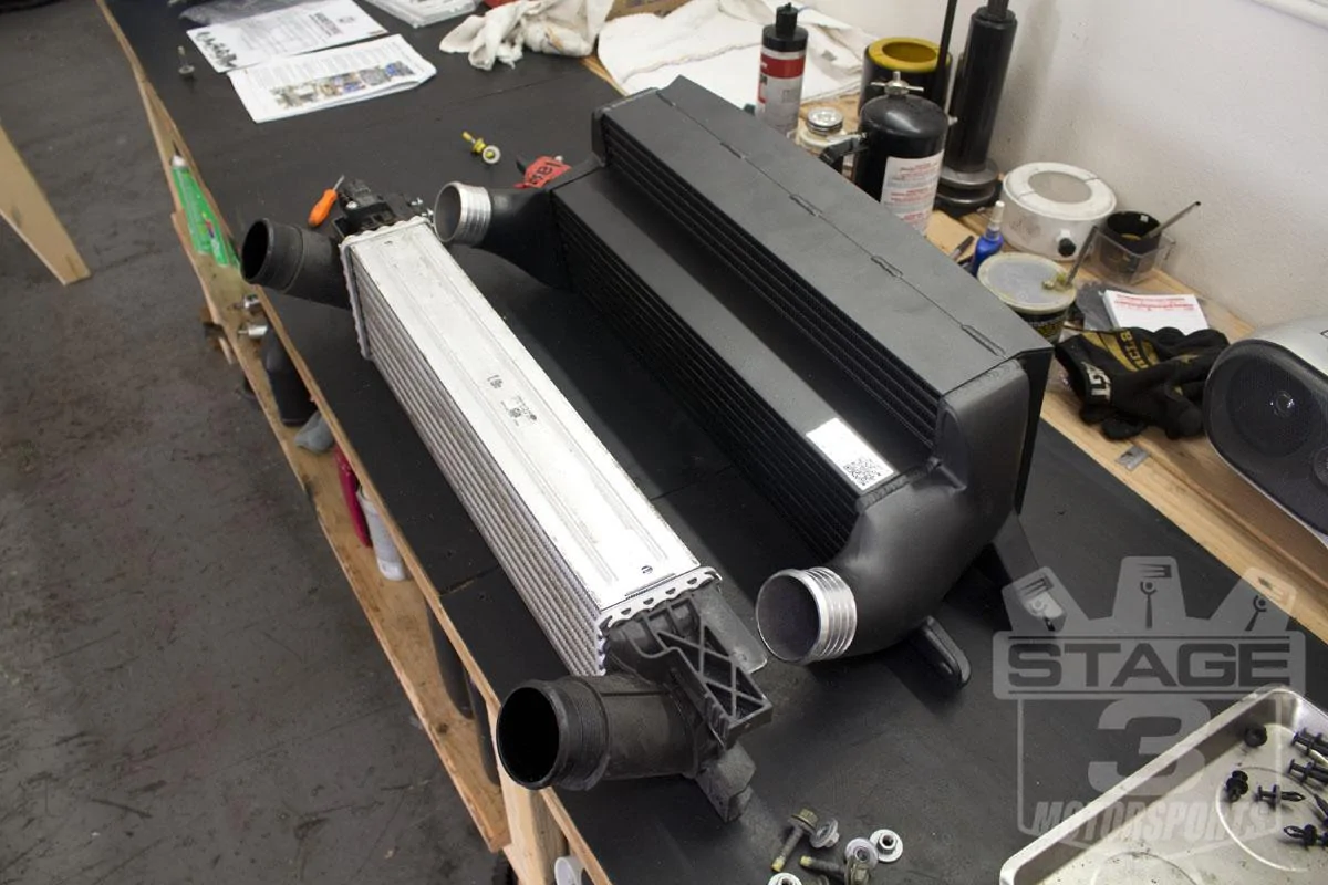

So apparently the ecoboost fitted intercoolers, specifically the one I purchased, the MAPerformance race intercooler has clearance issues near the radiator. Not exactly sure what the issue is but here is a quote from Tom: "Radiator about 4" wider than the space between the inlet and outlet pipes and radiator is longer vertically at the bottom"..
Well that is interesting.... I assumed the 6 and the EB shared a radiator but I guess the 6 has a larger one. Makes using a cheap EB intercooler difficult... :(

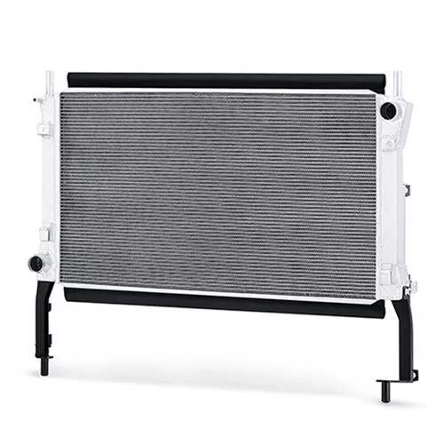

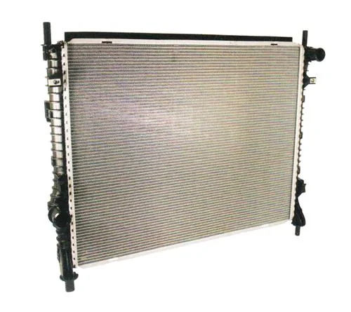

The MAP IC has inlet and out pipes facing rearward that run under the shorter radiator of the EB application. As you can see in the attached comparison pics, the EB radiator is much shorter vertically than the V6/GT radiator which provides this free space for the intercooler inlet and outlet tubes to run through. Due to the added depth of the V6/GT radiator, the intercooler inlets must feed in from the sides to go around the radiator not under it. The differences also apply to the cooling fan shrouds, condensor, trans cooler, etc. All this stuff is different between EB and the V6/GT.
