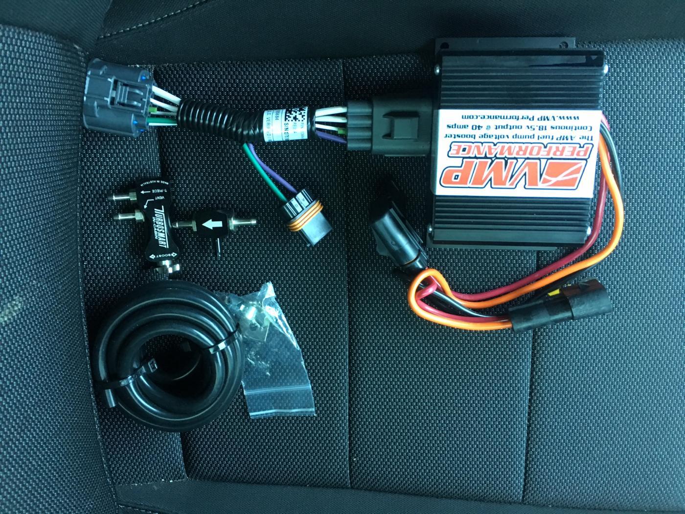

Also, here is an update for 7/28/2016. I have purchased the MAPerformance Race Intercooler for the ecoboost mustang, they said there is a 1-2 week build process for fabricated items. I ordered the VMP Performance Fuel Pump Voltage booster, and it has shipped. I ordered the Turbosmart In-cabin Boost Controller from American Muscle. They said it has shipped as well.
I am looking into purchasing turbo blankets that will fit the stock Borg Warner turbos from a 2012 F150 ecoboost. If anyone knows which blanket will fit or if they even make any, let me know! All inputs on this topic are welcome! :)

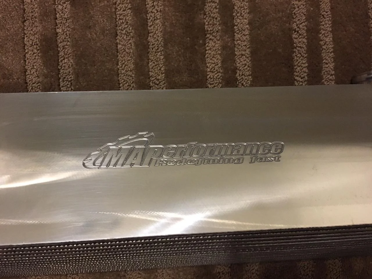

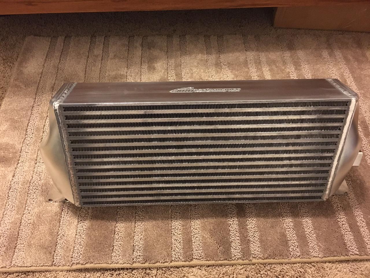

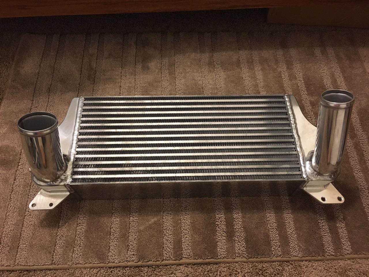

Received my MAPerformance Ecoboost Race intercooler! Quality of product is outstanding! Just going to order a few more parts: turbo blankets, oil cooler, and spark plugs. After, I will FINALLY be ready for installation

That looks sweet! Please keep us updated!! I can't wait to see those Twin Turbo running. I'm about to order the rest of my parts as well. However I'm still wondering if I should order a turbo blanket like you did. It seems to be a good idea though... Did you ever found a tuner for it?

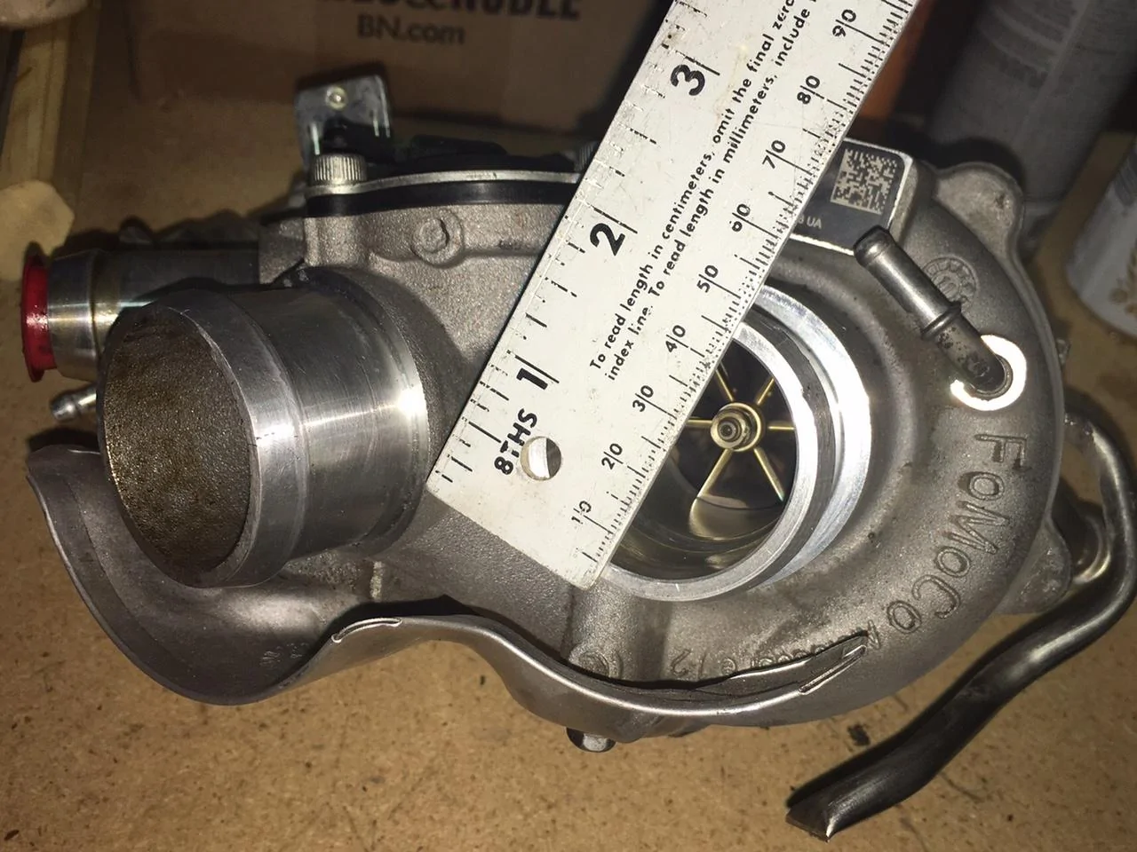

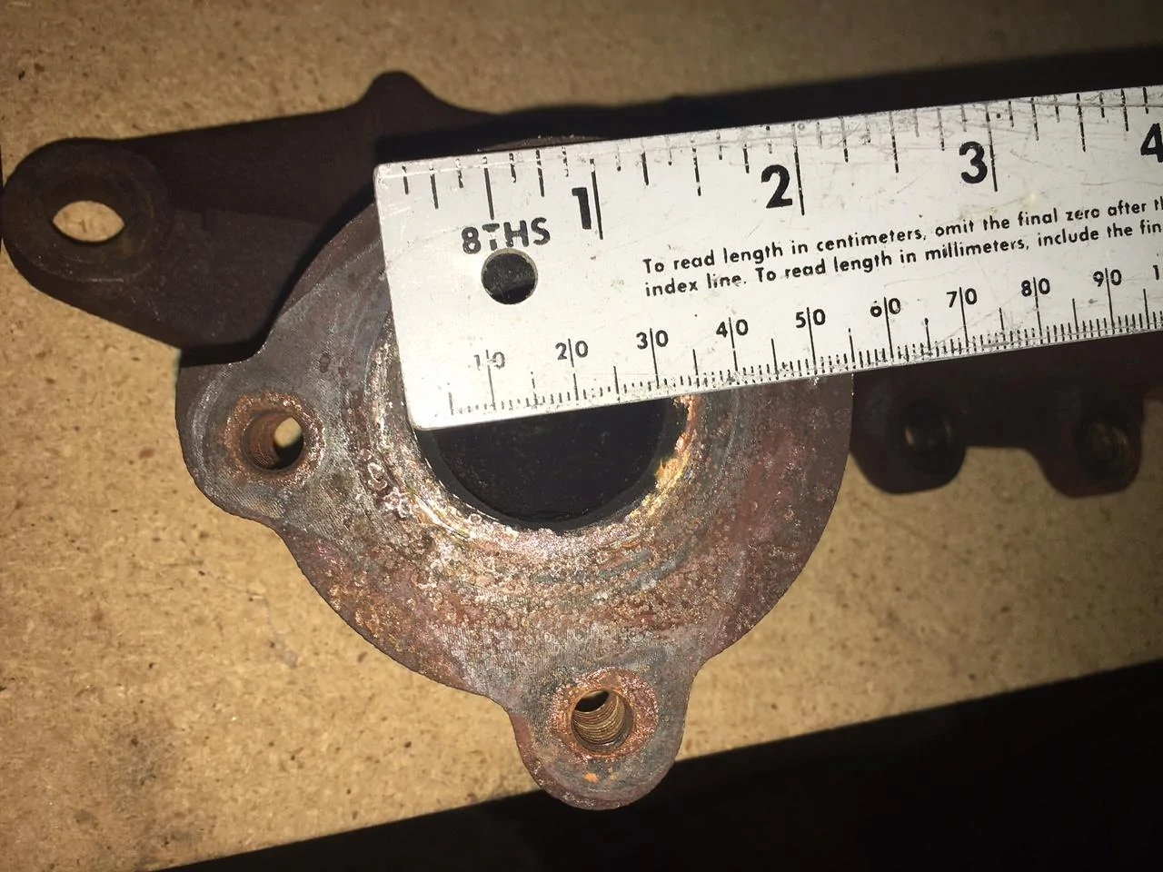

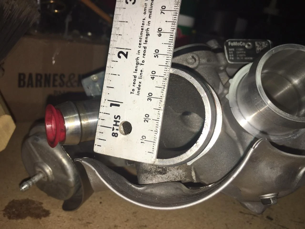

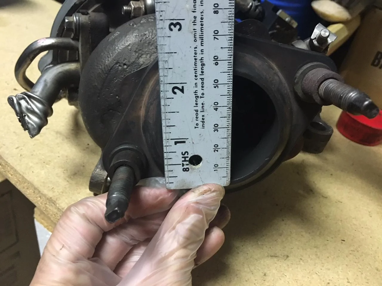

Just doing research right now but it seems as though these turbos would be a good fit for a rear mounted setup! If I do this I would cap off the water inlet/outlet as the temperature in a rear mounted setup would be much lower then at the manifold and have a dedicated oil loop so I wouldn't have to route oil lines all the way back to the turbos. But enough with my proposed setup! Don't want to derail the thread! Once I get further along I will be sure to create my own thread dcoumenting the project.
kodypiccirilli
kodypiccirilli
Mar 4, 2015
56
583
81
Arkansas
Kody
2015 Twin Turbo Mustang V6
For [MENTION=6944]zackmd1[/MENTION], here are some approximate dimensions of the inlets and outlets of the Ecoboost turbos. I did not have a Vernier caliper available for accurate measurements.
