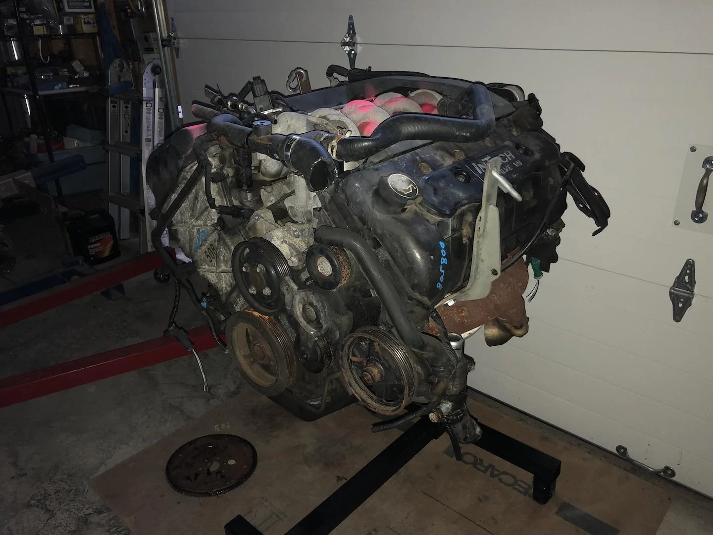

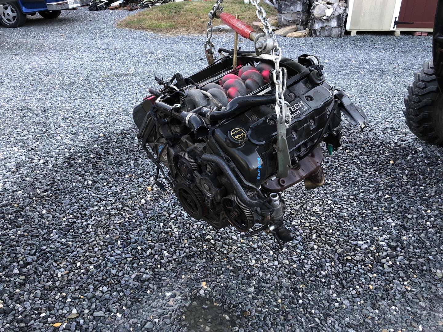

Well it is official.... 4.6 32 valve build is a go! Core engine is from a 2001 Lincoln Continental with 160k miles. This is actually a FWD aluminum block (WAP block based). Many say that this block is unusable because of the different bell housing and motor mounts. Thankfully the block has previsions for RWD motor mounts and the bell housing is a non issue due to the fact that I will be adapting it to work with the V6 transmission. (cut costs and due to the fact that the 6r80 is plenty strong even in its V6 form). Block can reliably handle 600+ hp.
Other then that the engine has C variant 4 valve heads and a 10.1 compression ratio. Build will consist of forged rods and either forged pistons or ceramic coated OEM pistons (OEM pistons are same design and material as stock Coyote pistons just smaller bore). Stock crank is plenty strong to handle the power I am planning. I will also be installing 5.8 GT500 cams that I have lying around that came out of another build.
To start off the engine will be NA and should make around 400-410 flywheel HP with a full LT header exhaust and custom intake. Down the road once the engine is broken in and any bugs worked out I will be installing an M122 supercharger and shoot for 600 flywheel HP.

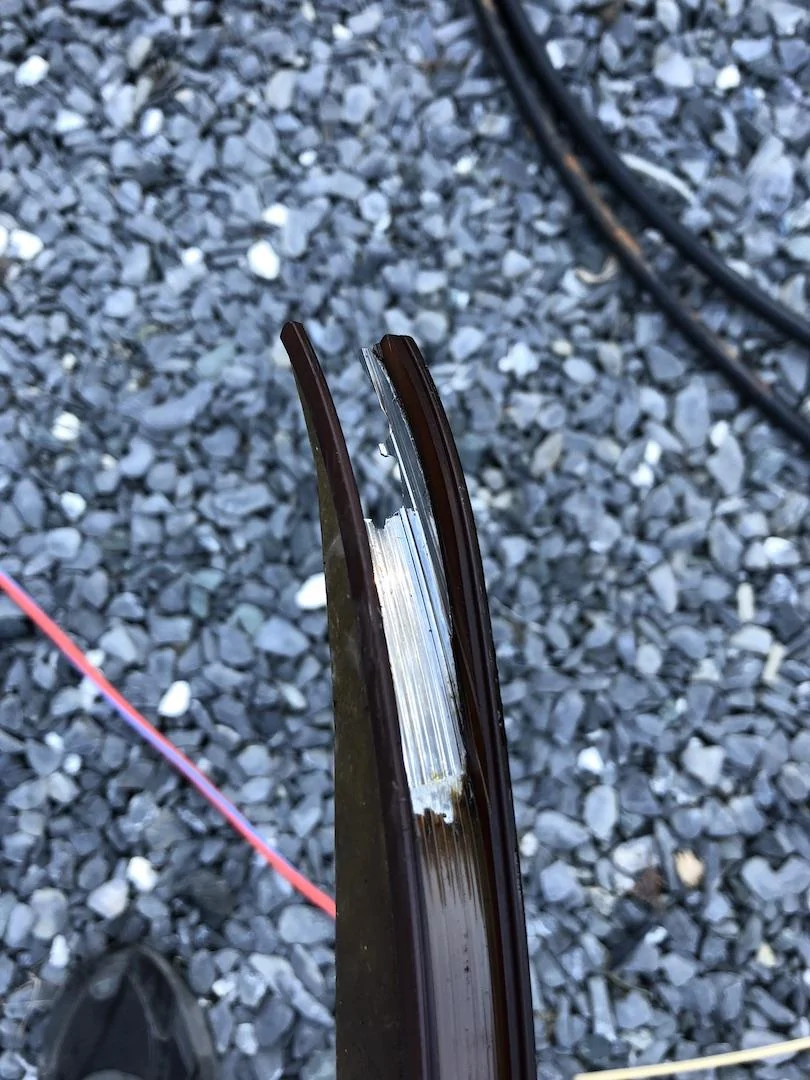

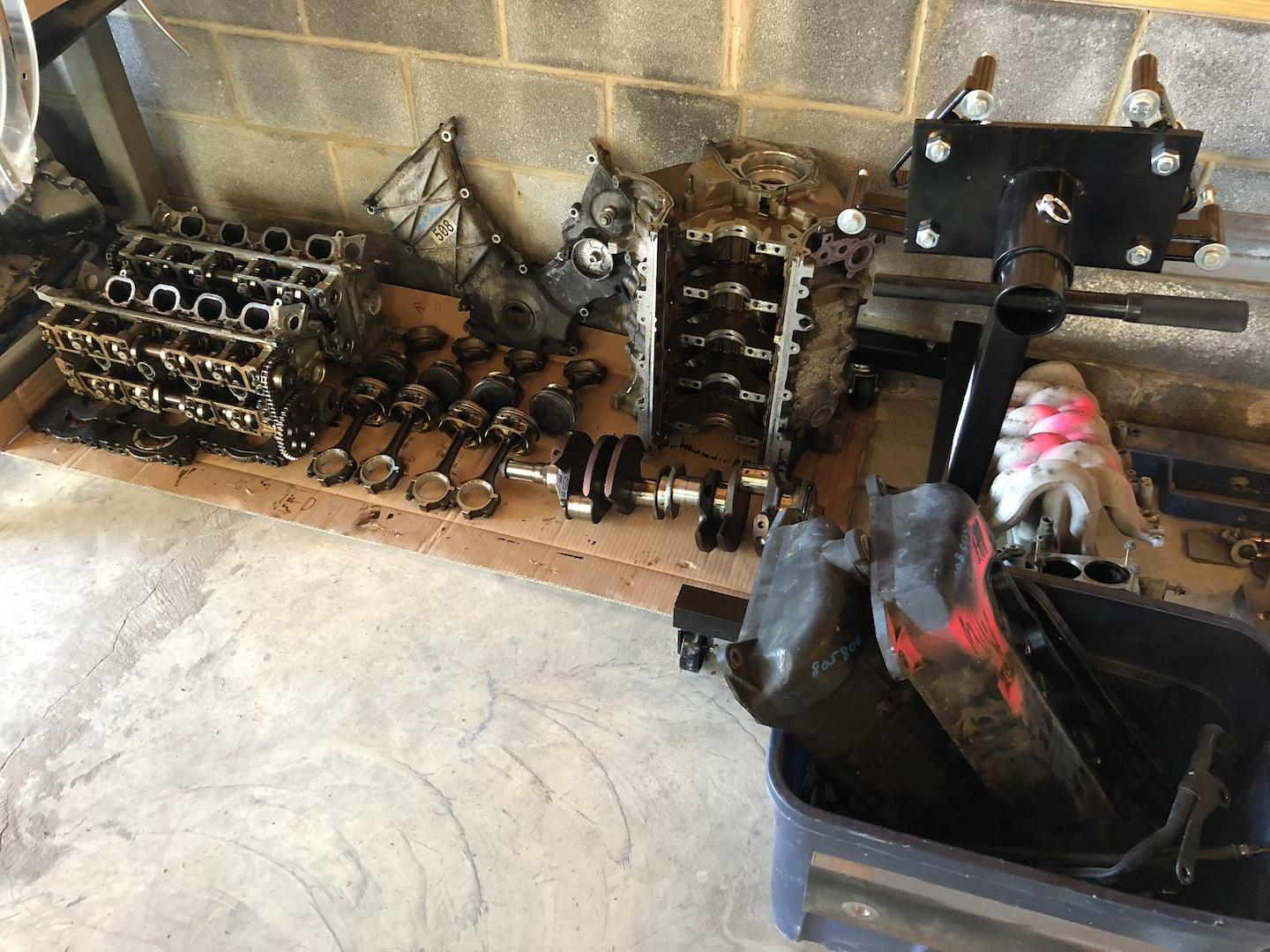

Well engine is torn down. Fairly clean for a high milage engine! Cross hatch is still visible on the cylinder walls! No doubt though that this engine was close to death... The passenger side chain guide was almost completely worn away as seen in the pic below. A few more miles and the engine likely would have snapped the timing chain or at the very least jumped timing and damaged the valves and pistons.
As with everything, plans have changed slightly upon more research. I will most likely be going with a forged BOSS 302 crankshaft (can get one for $320 vs $800 for a 4.6 spec forged crank). With some small machine work to the snout of the crankshaft it will indeed work with the 4.6 block. Stoke will be increased slightly pushing displacement from 281ci to 289ci. Not much in terms of power gains but it is nice to have that number! MMR offers a set of Manley forged pistons for this exact application.
Another benefit to using a coyote crank is that I will be able to use the coyote crank trigger wheel (block will be modified to accept the new sensor location) simplifying the tuning and will also allow me to use a coyote spec flexplate/flywheel. Will hopefully be dropping off the block and heads at the machine shop by the end of the month.
