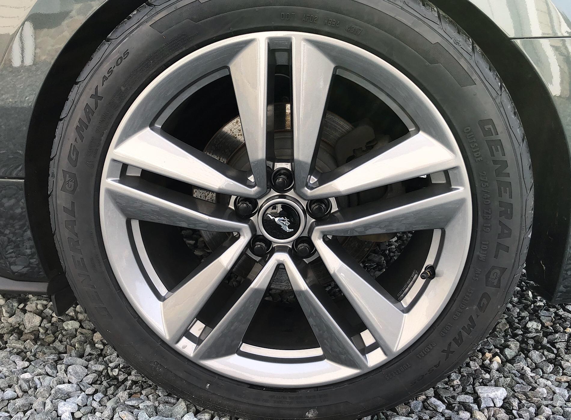

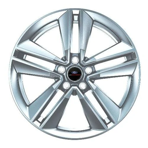

Well the 6 is finally getting new rims! Went ahead and ordered the Ford Performance 19x9 EcoBoost PP style wheel kit including TMPS sensors. One of my original TPMS sensors failed Friday which prompted this purchase (on top of needing new tires to begin with). I purchased the sparkle silver kit and am planning on painting them dark graphite/stainless. Ford Performance has a dark stainless kit already but the price difference between the two is crazy! $278 vs $621 from where I purchased the kit. Going with 275/40s all round with 25mm spacers.

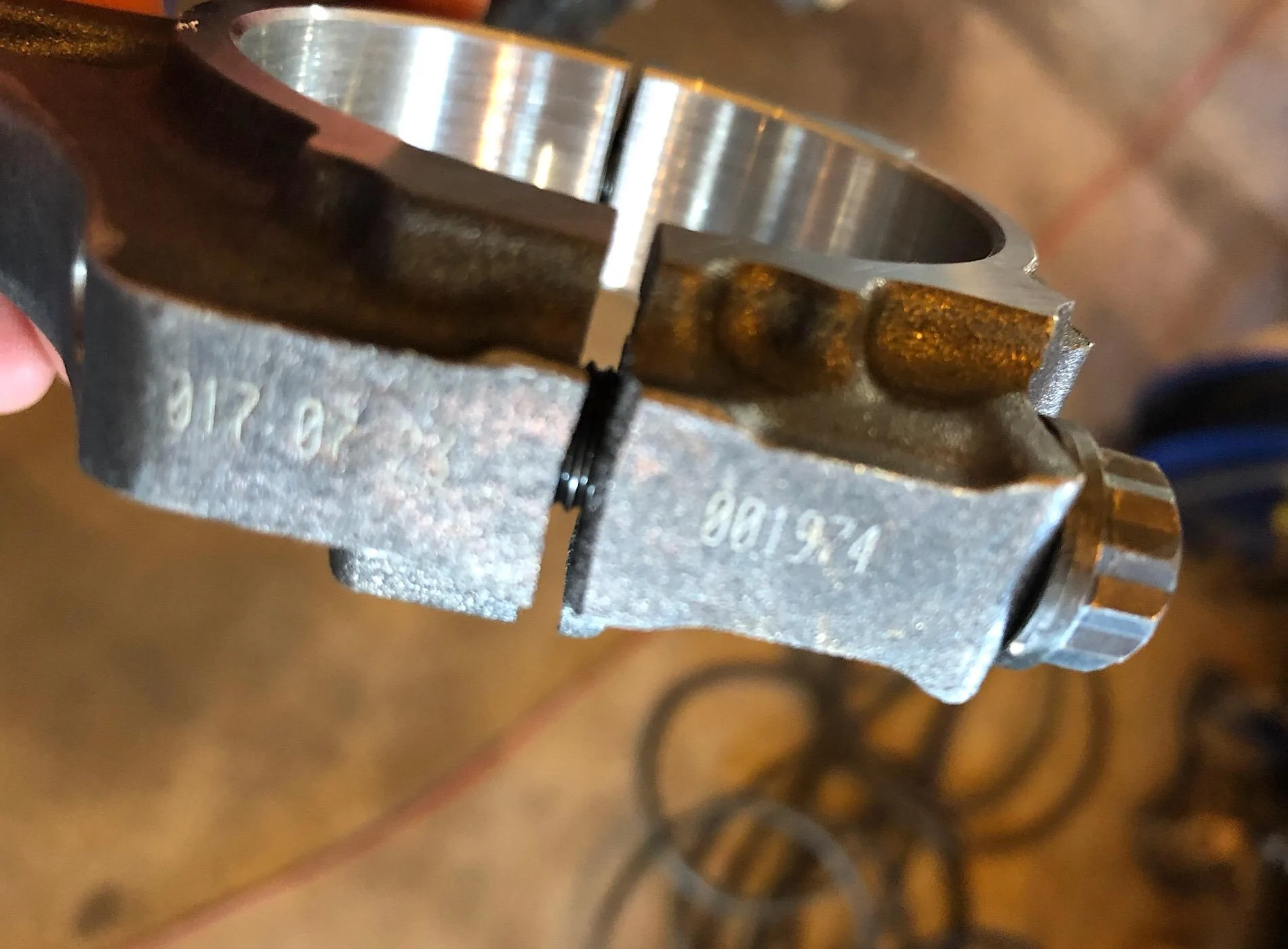

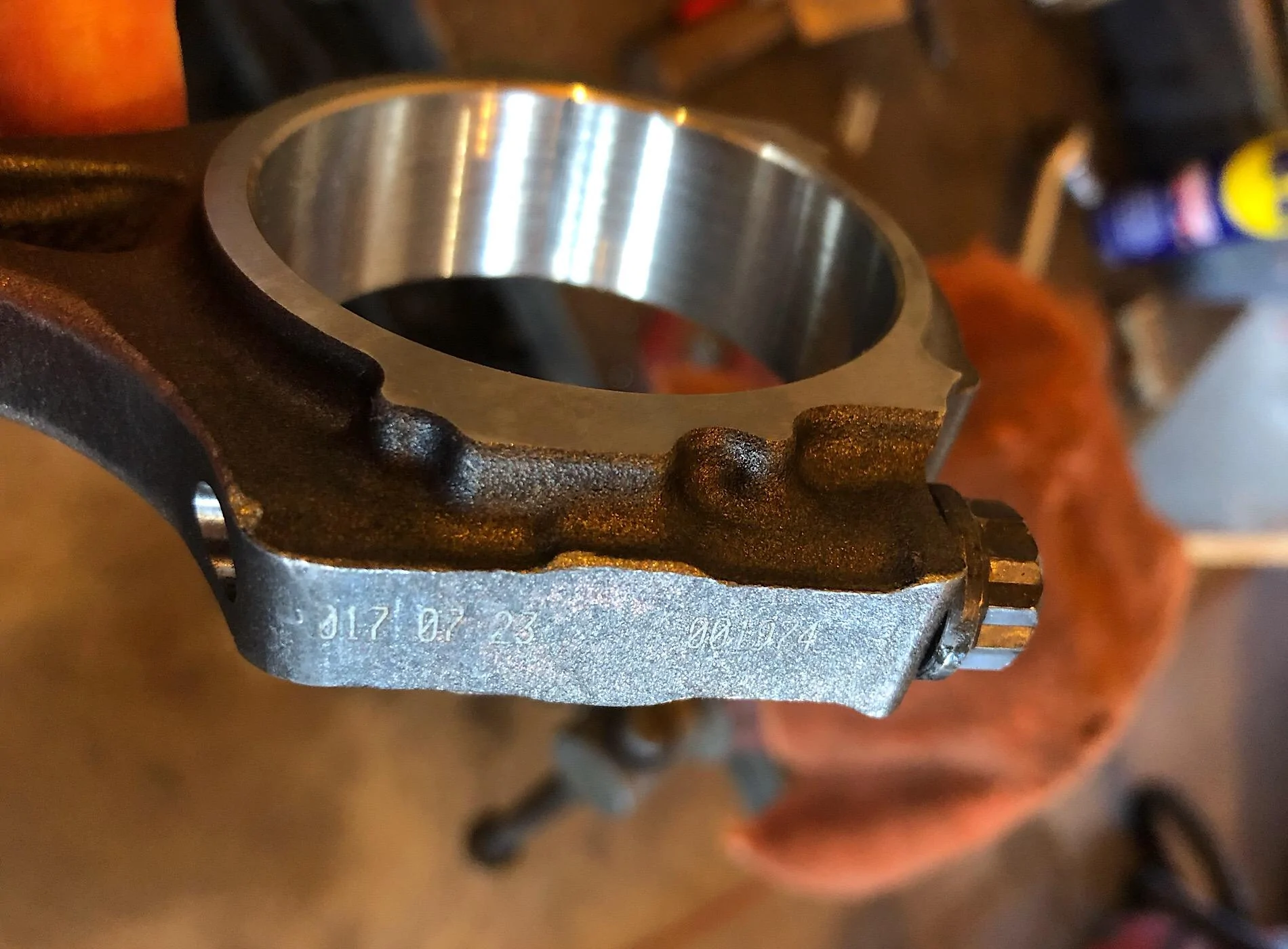

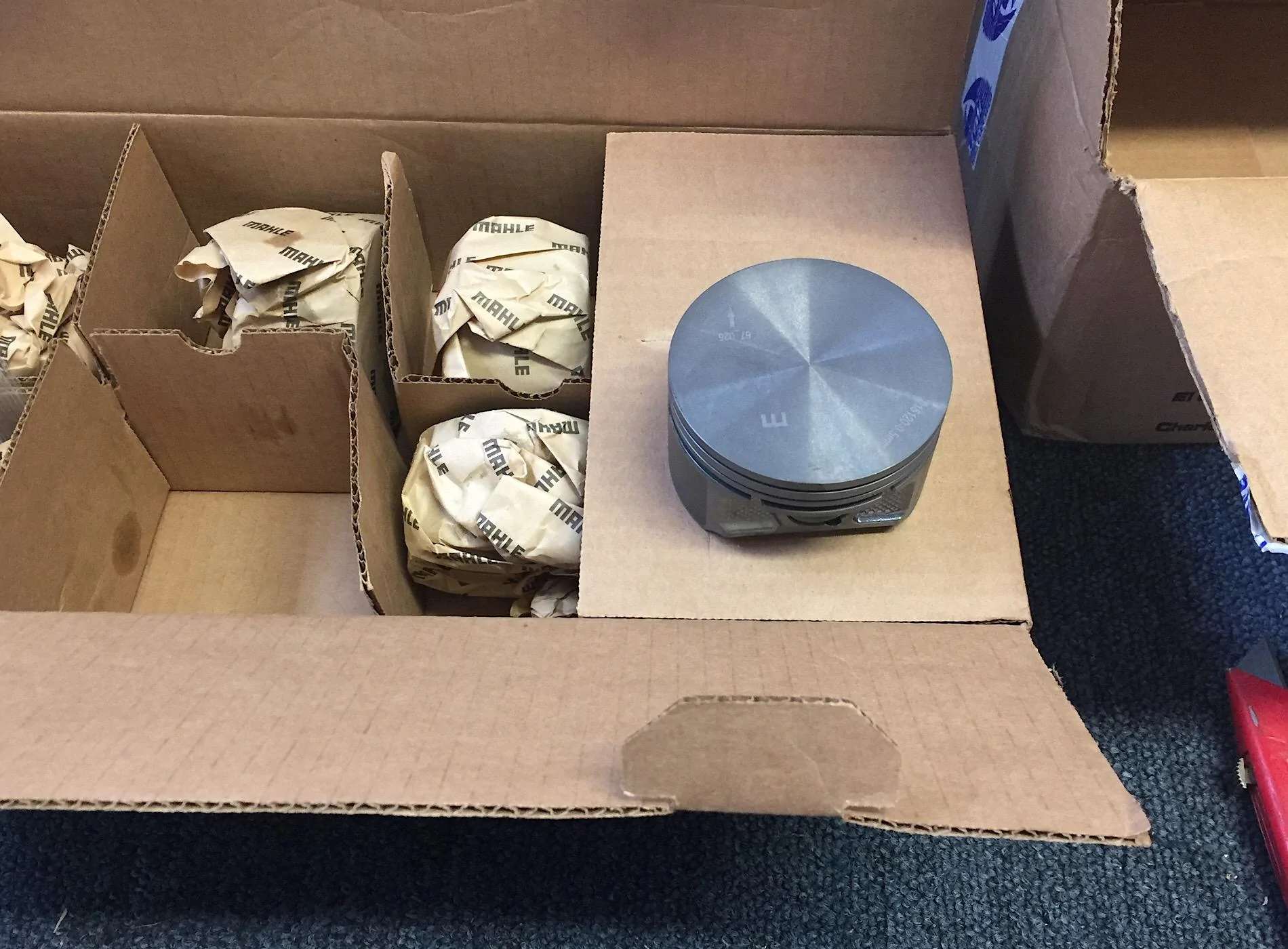

More engine parts came in as well! Mahle flat top hypereutectic pistions and stock 2015 coyote rods. Effective compression ratio will be 10.5:1. As stated before the block is being bored .020” over for a final displacement of about 4.7L. Close enough to be classified as a 289 in my book. No longer using the coyote crank but instead will be using the stock 4.6 crank.
What was cool about these connecting rods is that they come as a single solid part! A slight tap of a hammer causes them to fracture along the line machined from the factory.

Wheels installed! EB PP 19x9s repainted with “dark stainless” with 275/40s all round. Also have 25mm spacers installed. No rubbing!
