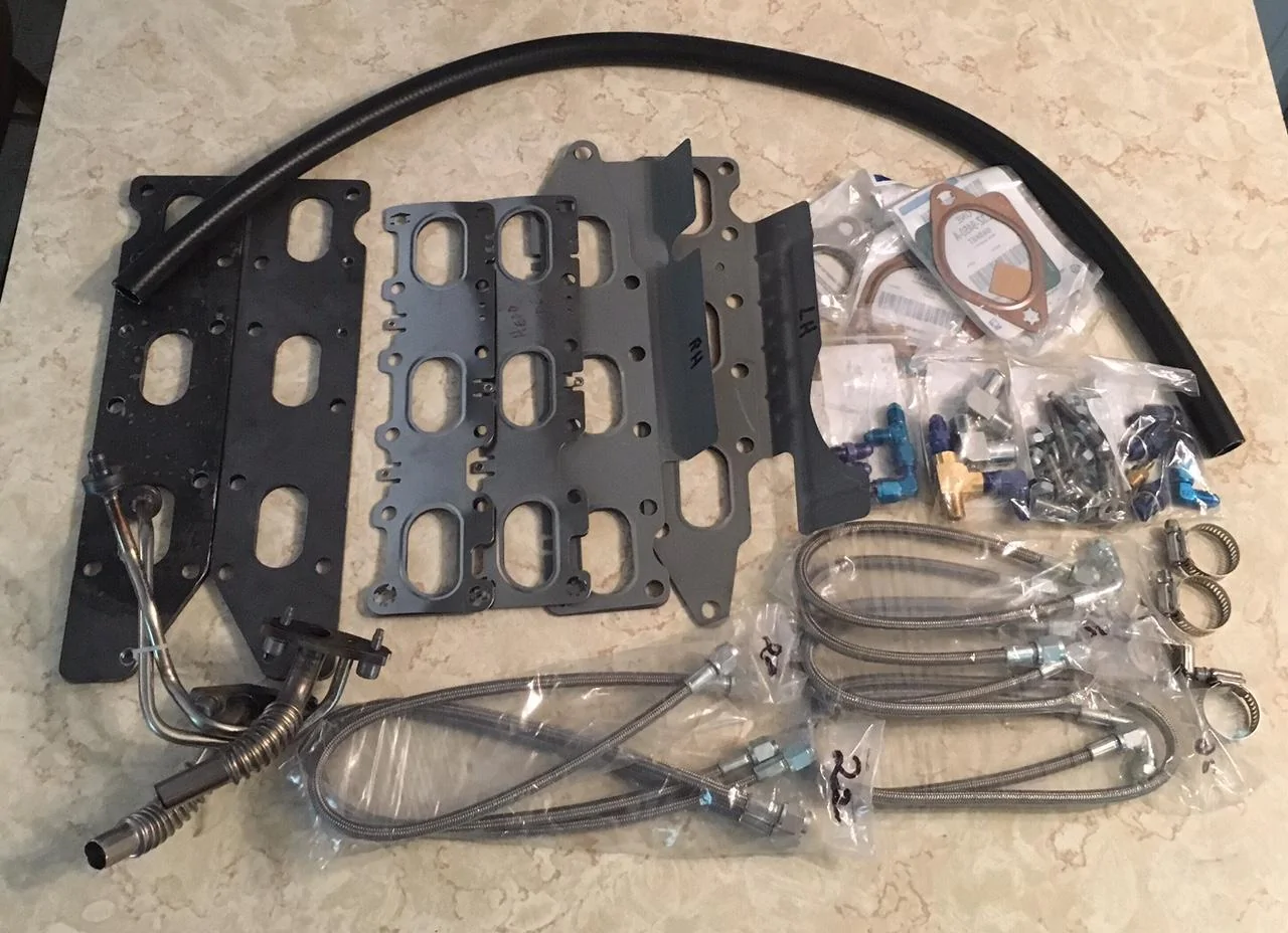

Received my installation kit from Super Six Motorsports as well as the gaskets I need for the headers and turbos! Next step: Intercooler, Fuel pump voltage booster, and boost controller. After that I will be ready for installation and tuning!

Excited for you! I cant wait to see how this turns out. Welcome to the turbo life!
