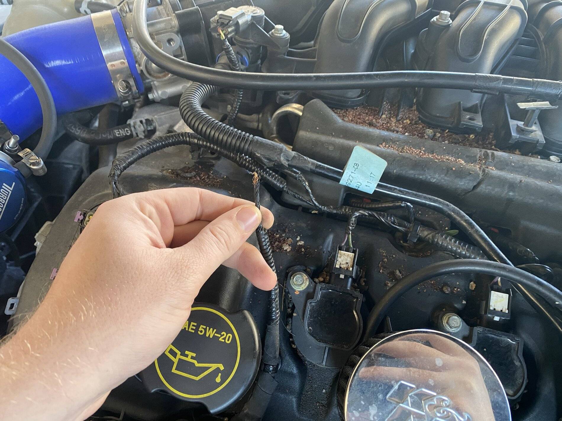

I got a low oil pressure warning light a few weeks back. Turns out I had a rodent living in my engine bay and they chewed through the wire... So far it’s the only damage we can find other than poop everywhere and the smell of urine.
My brother and I fixed that up and vacuumed up the mess. We also found a nest of leaves and cotton in the battery tray and cleaned that up as well.

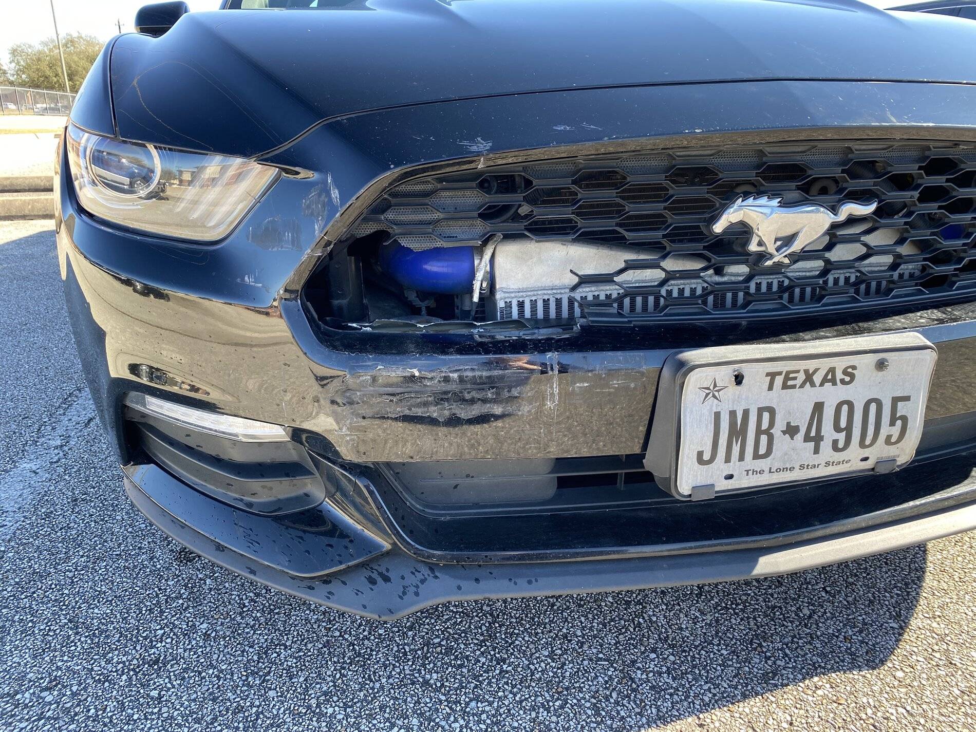

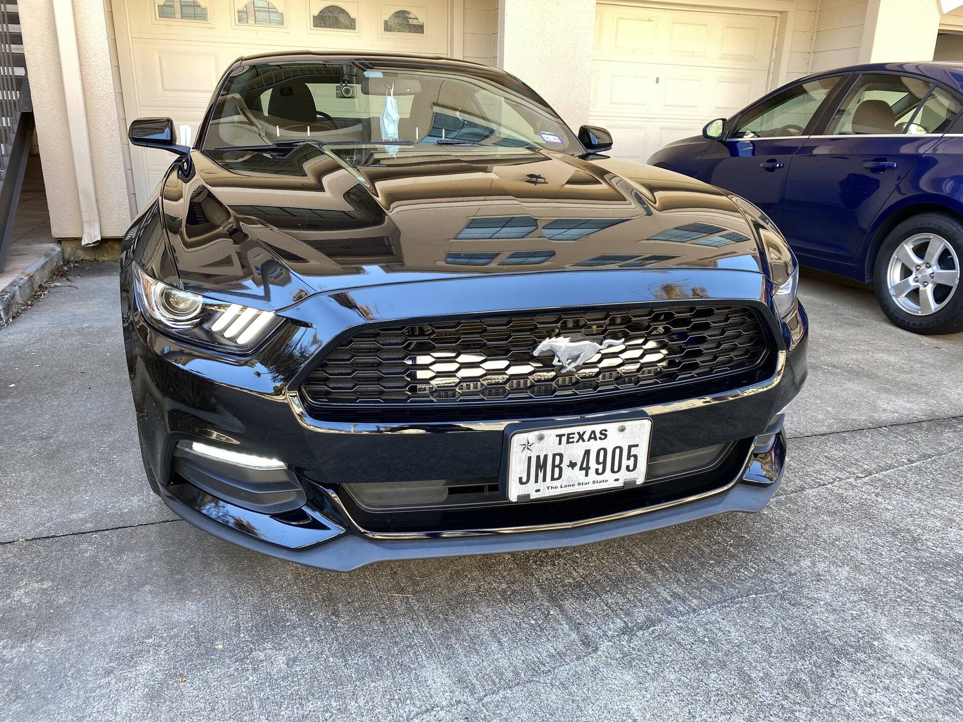

I was also unfortunately in a minor accident. Someone ran a red light, causing the vehicle in front of me to slam on their brakes and I couldn’t stop fast enough. Luckily we caught the guy who ran the light and caused the accident and insurance took care of it.
Before:
After:

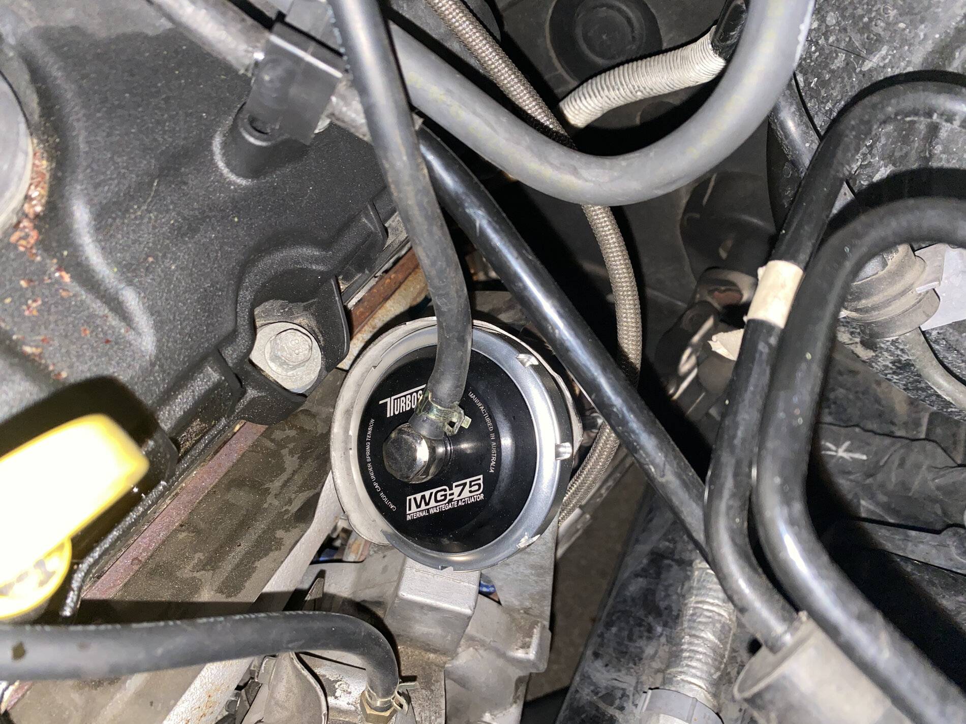

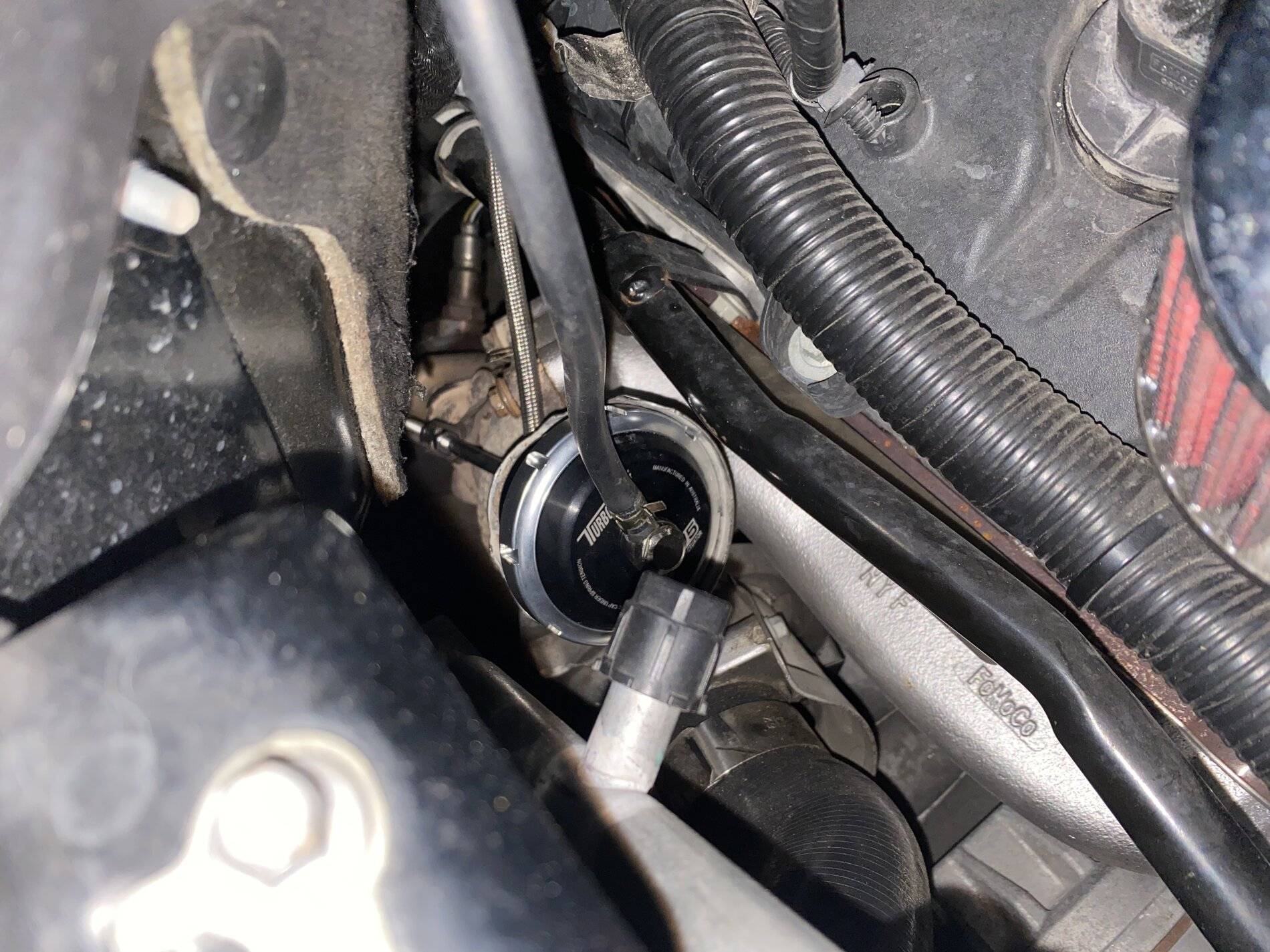

And finally today my brother and I replaced the stock F-150 turbo wastegate actuators with aftermarket ones from Turbosmart. We also replaced Turbosmart’s 5 psi spring with a 3 psi spring to try to alleviate the overboosting issue. While replacing these we actually noticed one of the bolts wasn’t flush on the passenger side turbo so there was a small exhaust leak between the turbo and the manifold. We got a new bolt and fixed that up.
Left
Right
Unfortunately we’re still making too much boost. 10.5 to 11 psi on a WOT run in 3rd gear with spikes as high as 14-15. Our next thought is it just completely redo the exhaust to try to free up the flow.
