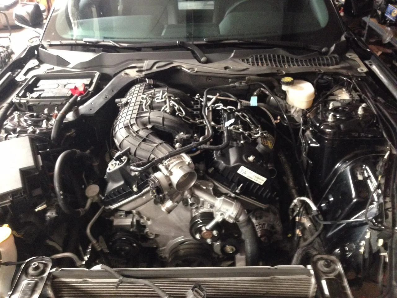

The engine is back in for the first test fit! No fitment issues with the turbos and engine bay. You can just barely see the inlet of the driver side turbo. One of the turbo manifolds is warped, so we will order a new one and then hopefully get the engine back in. As for the intercooler issue, I have ordered the CX Racing universal twin turbo intercooler and should be delivered in the next few days so that fabrication can start for the IC pipes

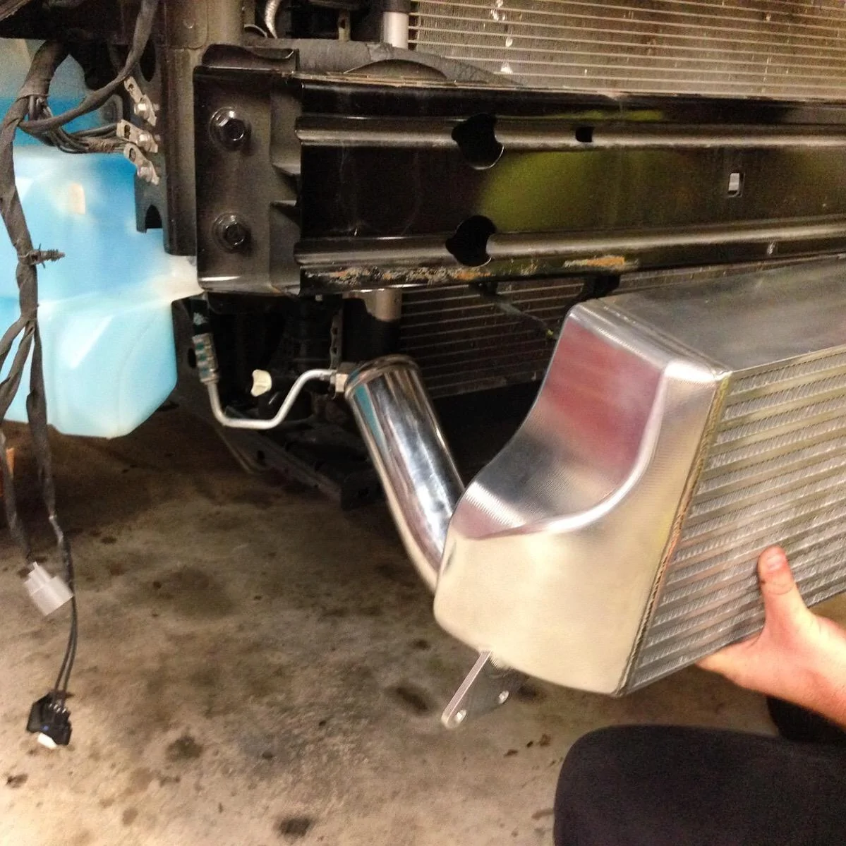

Here is an update: The CX Racing intercooler that I have ordered to replace the MAPerformance ecoboost intercooler is on backorder for a few more days (proabably 2-4 days). Progress is at a stop until we can get the intercooler delivered so that fabrication can begin on charge pipes to and from the intercooler.

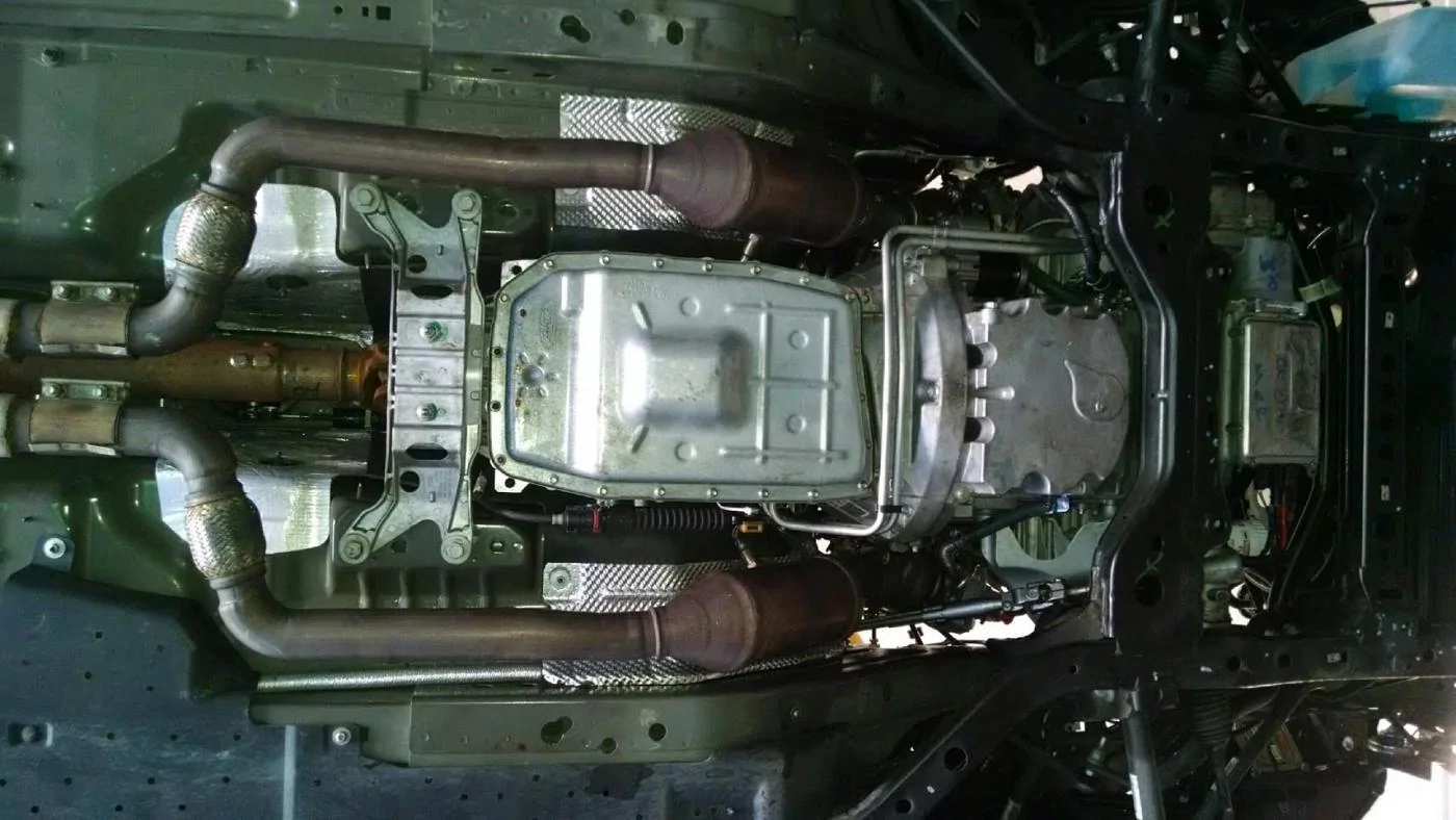

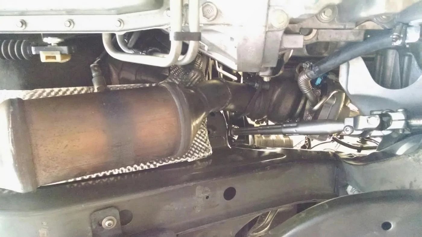

Downpipes have been fabricated to the original exhaust system. Turbos moved the stock exhaust flanges about four inches rearward. Intercooler is set to be delivered tomorrow, so hopefully we can get that fitted and start the fabrication process of intercooler piping. The DW 50lb injectors proved to be unreliable as not much data was available for them, so I switched them out for DW 65lb injectors which MPT has already tuned on. Will keep you updated...

Looking good so far! That turbo just barely fits on the drivers side! :headbang:
