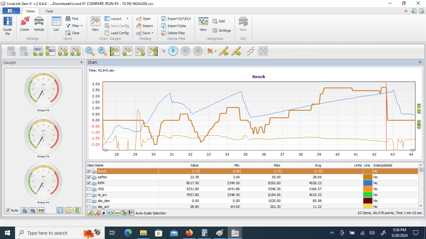

The lund tune I saw logs from was running over 25 from 5500 up. actually hit 27 in a section. It was also pulling 2 degrees of timing due to knock.
Looking at the Jug tune I would cap timing at 25 and run another test pull.
Consistent ? Or at peaks ? I'd leave it at 27 run good fuel and see what the KS will do. It's not like it's gonna blow up.

Starts pulling at 6500 and ramps up to 2.75 degrees at 8000.
Juggernaut also has the sift points stupid low when doing auto shifting. Like 7500 in first, 6800 in second, and 6600 in third. Idk why its not consistent over the gears or why they would do it like that. If I let it shift by itself it would probably run like a 15 second 60-130. These gear ratios are way to long to short shift like that.
That's odd. My stock manifold use to do that, now with my gen 3 intake and PMAS I'm cooking at 29 all the way to 7800. But I'm also 1 point lower in compression.
IDK, I hate seeing any knock at high RPM and loads.
It's pulling timing anyways so nothing to worry about.
It's just to see if fuel/ambient temps/etc., was the issue.
a little O/T but I think knock at high load, low RPM is much worse.
In order to pull timing it has to knock first.
You might be right but I have a hard time letting it knock.
