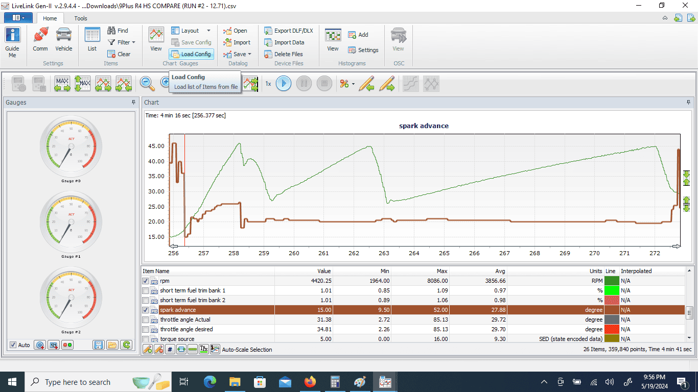

As I said way earlier. Are you sure the new tuners (both you’ve had NOT LUND) know exactly what cams are in the car?
If they’re using stock ford cam timing and you have Comp Cans in the car, either they don’t know it has comp cams or they don’t know what the baseline for theses cams should be. If it’s the latter, I’d make sure to send them the data and recommended base cam timing that came from comp Cams. Then try the same tune with only the cam timing change and see what that’s like. Then go from there.
Yep I specifically clarified with Juggernaut that they knew what cams I had and they said they were accounted for in the tune.
I don’t know what comp recommends for cam timing, will have to do some research.
And ya I’m going to have Juggernaut change the cam timing to match Lund’s and see what happens from there. Realistically not much else in the tune can account for such a big change.

Looked at Jug's tune and it is not stock cam timing but not what I expected to see either.
You really need a dyno and a live tune.
It went into cat protection but after your pull
They're trying to reinvent comps wheels.. COMP gives detailed cam timing specs. Follow them haha.

Jug is REAL conservative for ign timing. I think this is a base tune to make sure everything is solid.
Tristan let him make a revision or 2 before you give up.
That’s revision 4 haha, but I’ll keep working with him for a bit. They told me it’s not a low power tune
It has less timing than factory stock. He may have sent you a miss labeled file.
Knock is 0
Yikes haha. I'd just give it timing until the knock sensors are unhappy. Then back down a degree or two.
pardon the ignorance...
Unless tuning for a specific fuel characteristic (eg. E85) why wouldn't the timing be broadly the same (upper and lower limits) for every Gen3 NA v8 Mustang? For example let's say Mr. Tuner-I-blowup-customer-engines-because-marketing-WIN sets "allowed advance" at 40 degree as the upper bound, doesn't the control logic have the means of chopping it off at say 32 if the knock sensors assert themselves? Why would/should the tuner reset the upper-bound value to 32 minus a couple?
I thought there was slow-ramp logic in things like spark advance.
