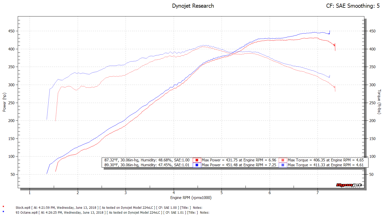

Frankly I'm surprised it's not the reverse. I don't have an A10 so don't know where the shift RPMs drop to, but IMO if torque max is 4500'ish RPM I would choose shift points so that the new RPM is about 10% below peak so you climb into it and 'overrun' on the high side to about 15% below peak. Lather. Repeat.
So if this chart isn't total bunk, the shift band would be 3700-6500 or so.

Car is a 6r80. It has a ported 18 mani and cams so it can rev pretty high. Honestly it needs a better manifold but that's for after I get this tune dialed in. I've found the best results shifting at like 7900 rpm. Also works good for 60-130 pulls as you hit 130 at like 7800 rpm in 3rd.
