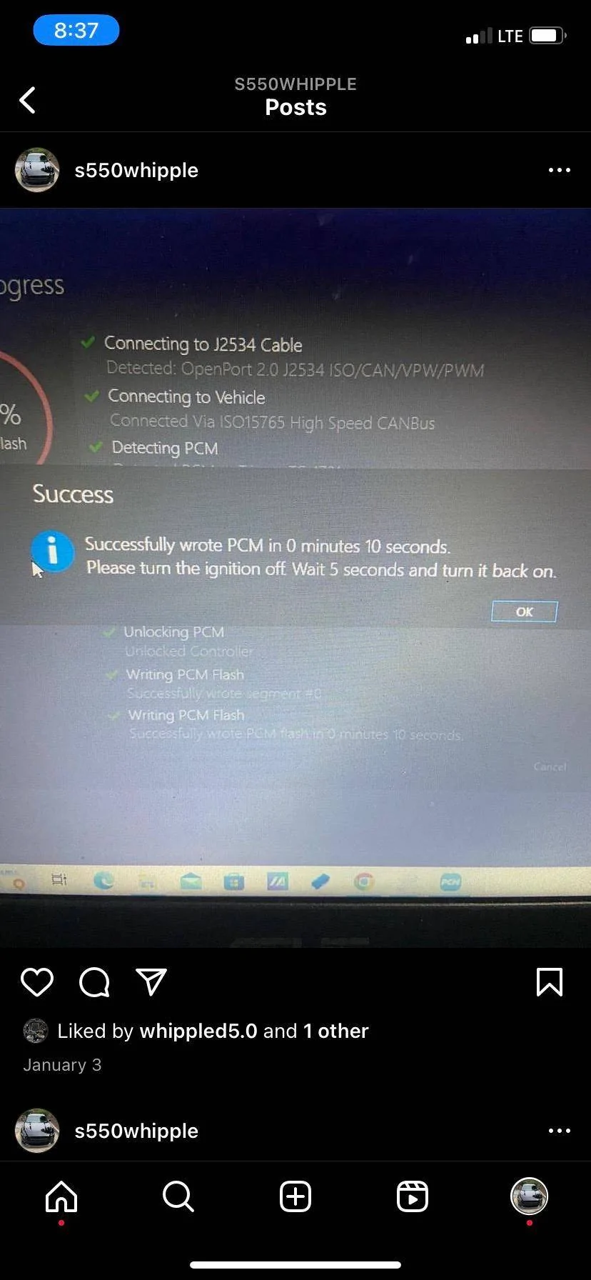

@stang17 is he using PCMTEC to flash a Whipple os? If so what version of PCMTEC ($100 or $2000)?
We purchased a workshop account a while back as we were under the assumption we would be able to do multi tune ourselves. However, PCMtec still hasn't made it available to everyone other than a few select workshop accounts such as Lund, etc. I reached out to Lund shortly after the announcement about canbus flex, but was advised they don't have an offering yet.
The PCMtec was able to read several tuner locked tunes as well as the whipple OS that was previously read with HP tuners MPVI. However, just like HP Tuners, PCMtec was unable to access the entire Whipple file.
