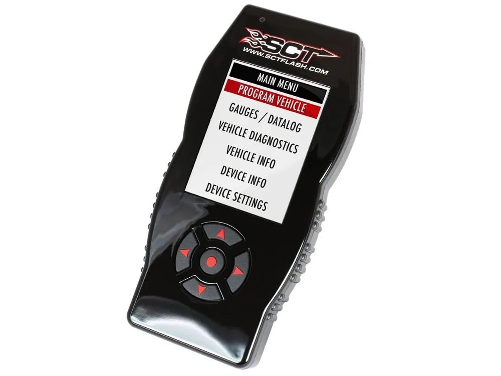

We offer the lund flex fuel tune, on the sct x4, or on the ngauge. Were lunds largest dealer and can get you dialed in.
Stock fuel system is fine, until you hit a gt350 manifold.
Livernois has their own device as well if you decide to go with them.
