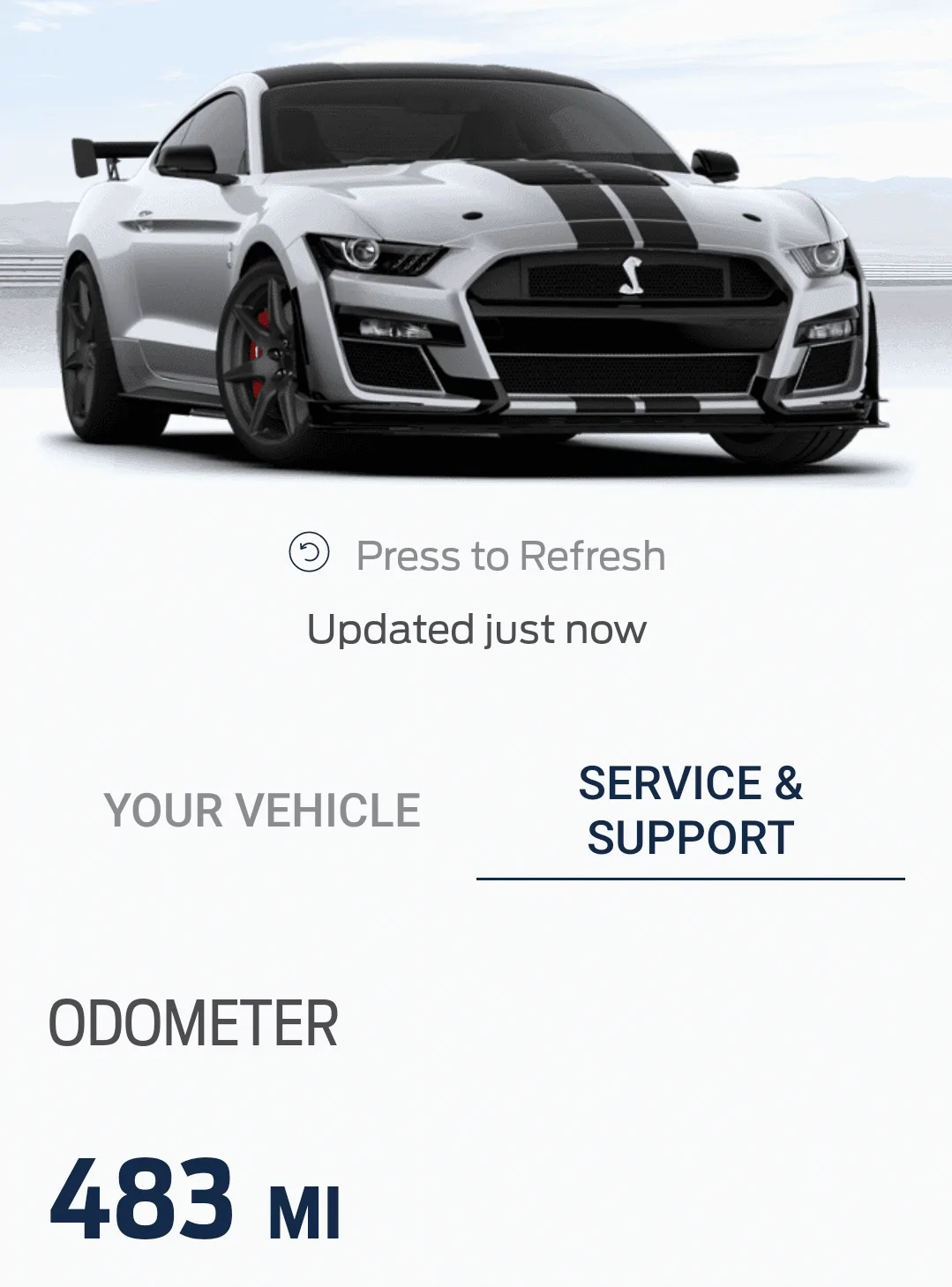

Thanks for sharing, John. I will be heading out to the garage to inspect that connection.
Looks like you have 3 more road miles than I do!

Awesome, I bet you pass 50 before mine rolls again.
Just interviewed the dealer in town recommended by a Ford rep.... it’s a HARD pass!!! Arrogant, unaccommodating, and disinterested in taking proper care of my car.
Hoping the dealer just outside of town pans out. Otherwise, I am taking a road trip back to Arkansas.
