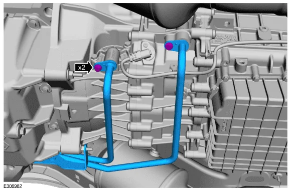

I'll bet Tremec figures out a way to allow TWO bolts on that line connection. One seems just plain foolish although I realize there were physical constraints. A better design could fix that.
SOOOOOoooo, my fellow enthusiasts with a lot more knowledge than I...how would you go about putting thread locker on that one bolt? I'm gonna guess that with the engine off, that line would not be pressurized, if it ever is, but is it above the level of the fluid? I'd REALLY like to avoid a shower in gear grease. :-)

the hose would only really come loose if the system is pressurized. Have someone put their finger on the flange if you're worried and remove the bolt, inspect the threads carefully to make sure they're not already torn out and then add a drop or two of blue and re-secure. What is the diameter of the fastener? I'm eye-balling it at M8x1.25
If the threads look a little sketchy run a tap with just finger pressure. You can also use a pick and pull on a thread and see if it holds or just crumbles off.

Kent, I would think that just like every other O ring fitting on the car, you would remove the fastener and then have to supply some force to remove the fitting from the transmission. If the line is not pressurized, I dont think it would come flying off.
Now here is why I would not do that myself. If you remove the bolt and apply thread locker to it, you have done something that could be looked at if that ever failed. I think the way that I am going handle this is to do an inspection and verify the torque. If everything is ok, then I'll leave it alone. When the car goes in for the brake recall, I might address it at that time with the tech. I would approach it in one of two ways, install a witness mark so that I can periodically make sure its not moving, OR have the bolt removed to verify thread locker is applied.

first figure out diamter and thread pitch. It's probably a grade 8. For something like this 'firm hand tight' should be PLENTY esp. with loktite. Treat it like a oil pan drain plug or diff cover drain.

That's kinda the direction I was leaning, Matt and absent a torque spec, I plan to proceed exactly as you described. My wag is 15-20ftlb which is pretty much "hand tight" I expect.
From the 2020 Mustang Service Manual
Install the rear transmission fluid cooler tubes and the bolts.
Torque: 89 lb.in (10 Nm)

Here's a funny, Earl. I went out a short while ago to put the car on the lift to check those bolts and some other tasks only to discover that the battery was dead. Yep, left the ACC on like a dummy yesterday while testing out Surround. :-)
So, she's charging and I'll check 'em tamarra.
