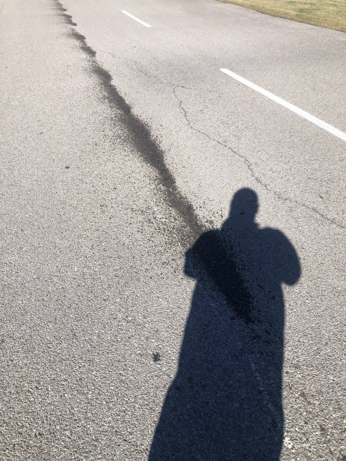

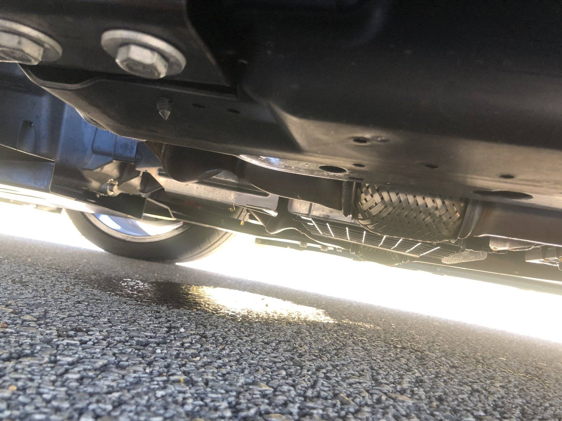

I found a long trail of what I assumed was oil. Looked under the car to find a massive leak. Then called the wrecker.

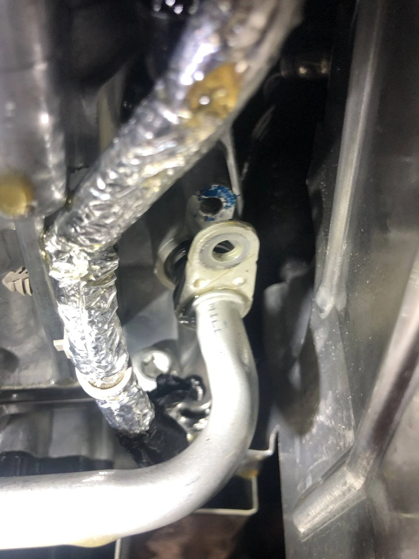

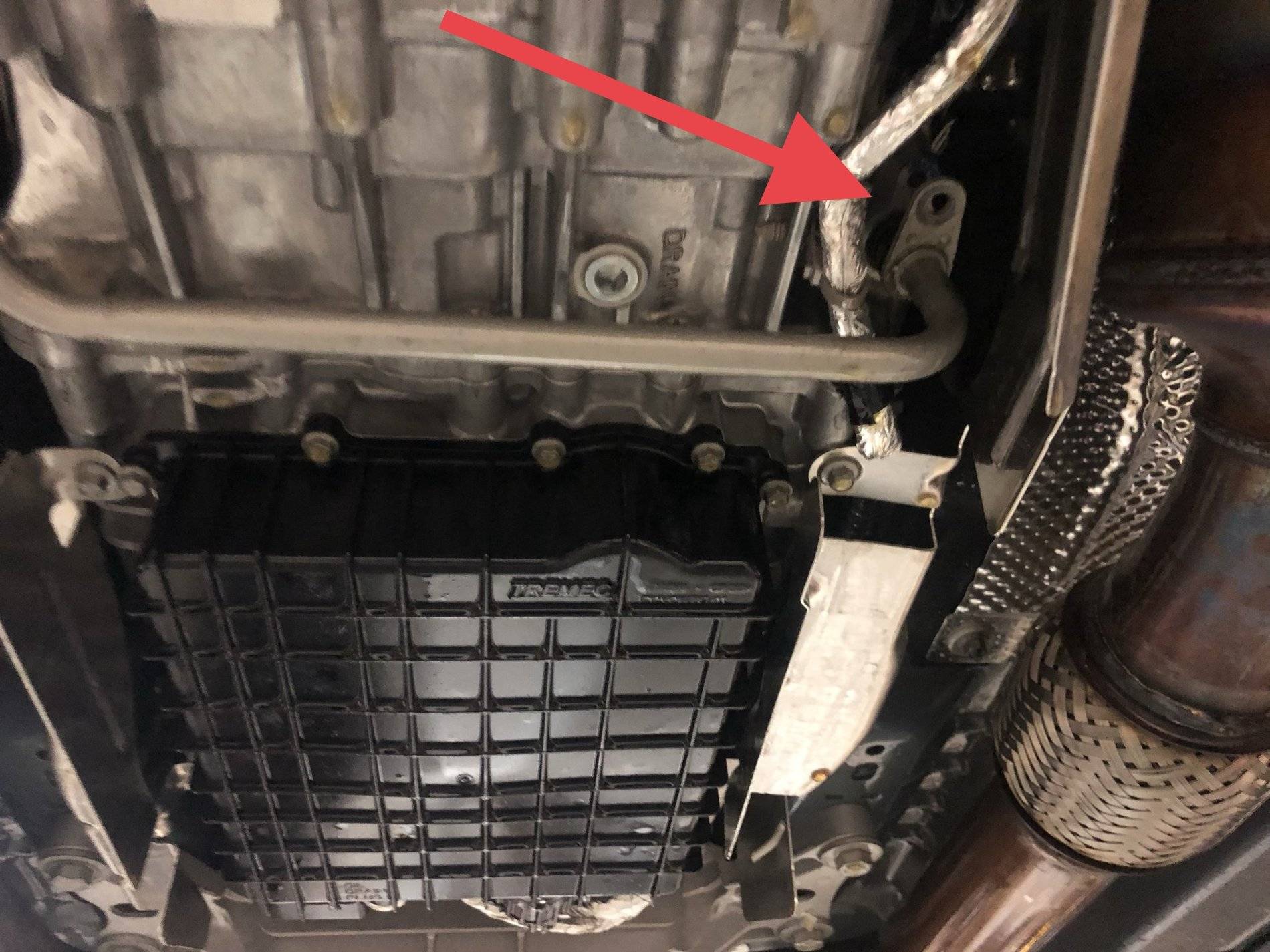

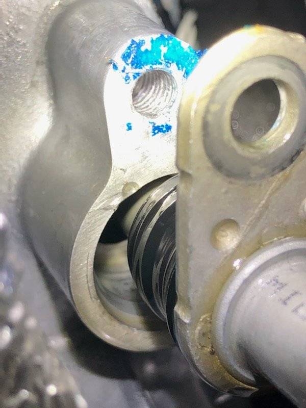

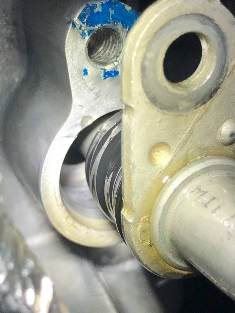

Today, I was able to get it on a lift at work and was able to find the problem. A tranny line lost its bolt and it puked out all of it’s fluid. Line also looks pinched/dinged from when the bolt launched off.
Needless to say, I’m not touching this issue. My girl is off to a stealership for repair. Everyone might want to check their lines for loose bolts.

You are lucky there wasn't a fire.
Interesting that I see medium (blue) thread locker on the bolt boss face and not so much in the threaded hole for the bolt. I hope you caught it early and that there was still sufficient fluid in the DCT sump while it was operating.

After looking closer, it appears the threads are stripped....
