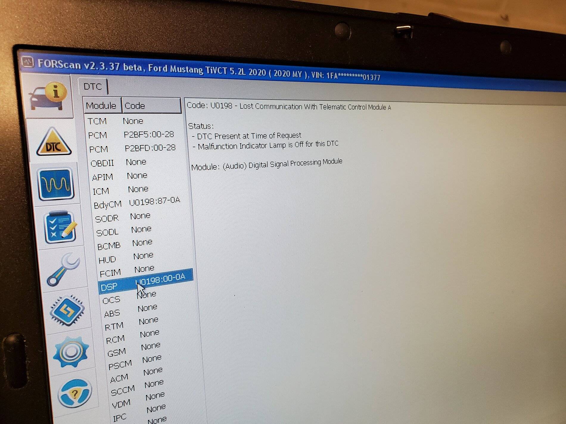

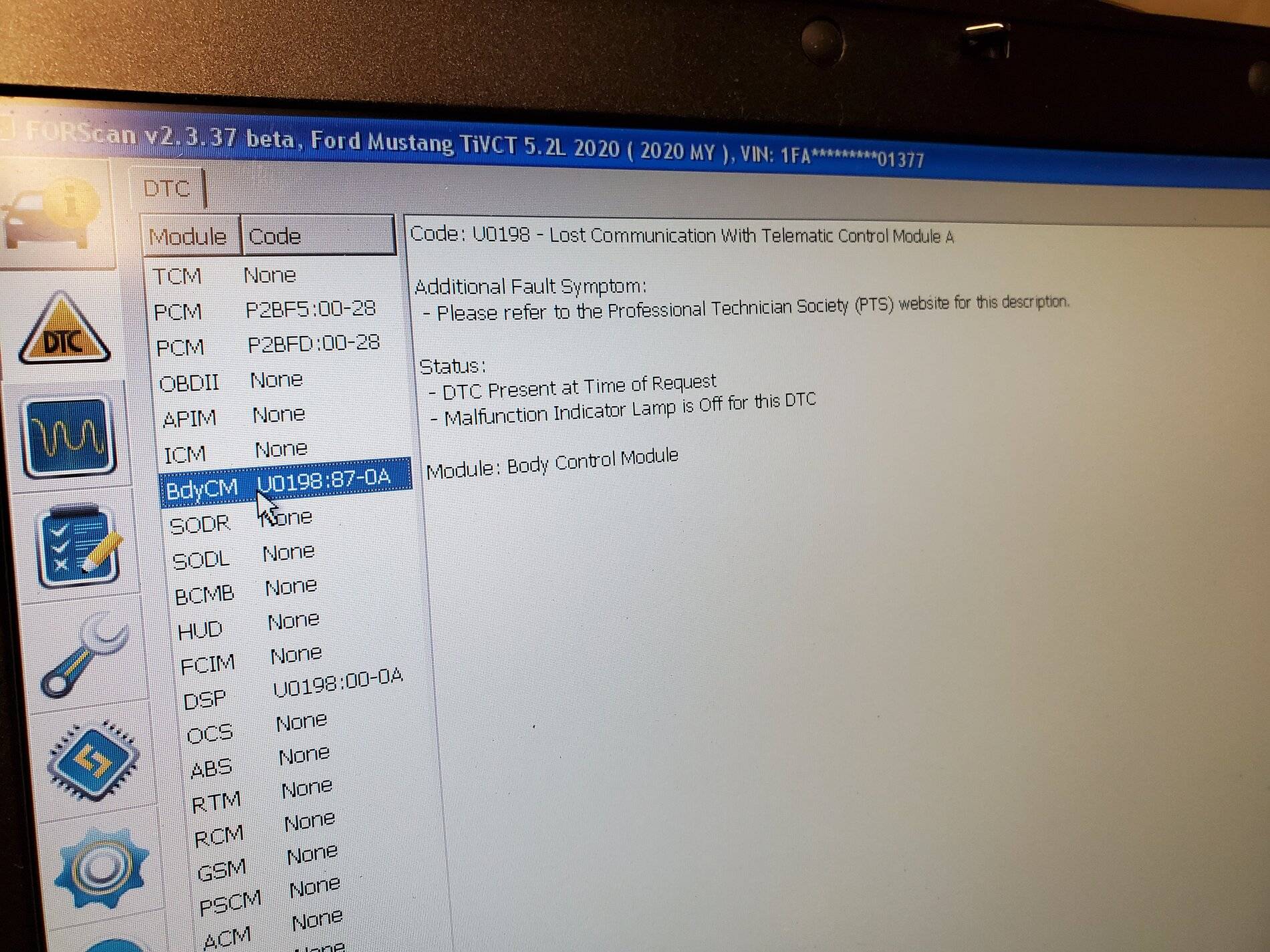

Disable. I've unplugged the sensors for awhile now, and seems to charge the battery like normal without throttling charge to the battery. When I start the car I get a little message saying to have the charging system looked at but no fault code is generated. I wanted to turn the BMS off to get rid of the message.
