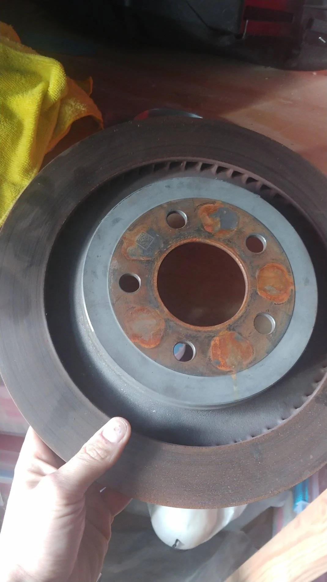

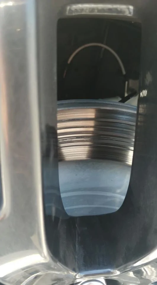

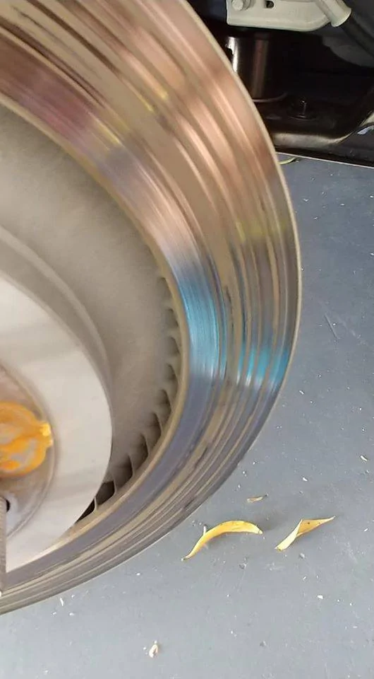

i had to change OEM rear rotors 2 times in the first 4 events. I found those 2 pics I had. but on top of the uneven pad deposit there was also a damage rotors surface . especially in the inward side. Ford changed both times them. I have now the 2 piece steeda rotors since...15 events. still great condition and no more uneven pad deposit ( also helped by the slotted area) . So yes I do believe they are an issue. especcialy if the speed is very high.
OF COURSE..for normal usage oem rotors are more than ok. even for the front
