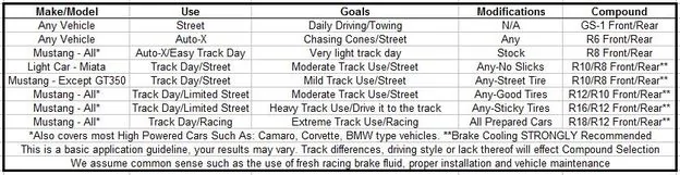

Depends on how deep you go into the track pad realm. The endurance/racing based ones need a few hundred degrees to start working well. The R10 starts working at a relatively low 186 F, which you'll get to after 1, maybe 2 brake applies. Even the next level up, R12, starts working at 200 F.
G-LOC™ R10:
The R10 has a much strong initial bite and higher coefficient of friction than R8. R10 still maintains our smooth release, excellent modulation and rotor friendliness that have been engineered into all previous G-LOC™ compounds. The R10 compound disc/rotor friendliness will lead the industry. R10™ broad temperature range and fade resistance is in excess of 1475°F (186°F /85°C – 801°C). G-LOC™ does NOT recommended R10 for daily use on the street due to elevated levels of dust and noise.
