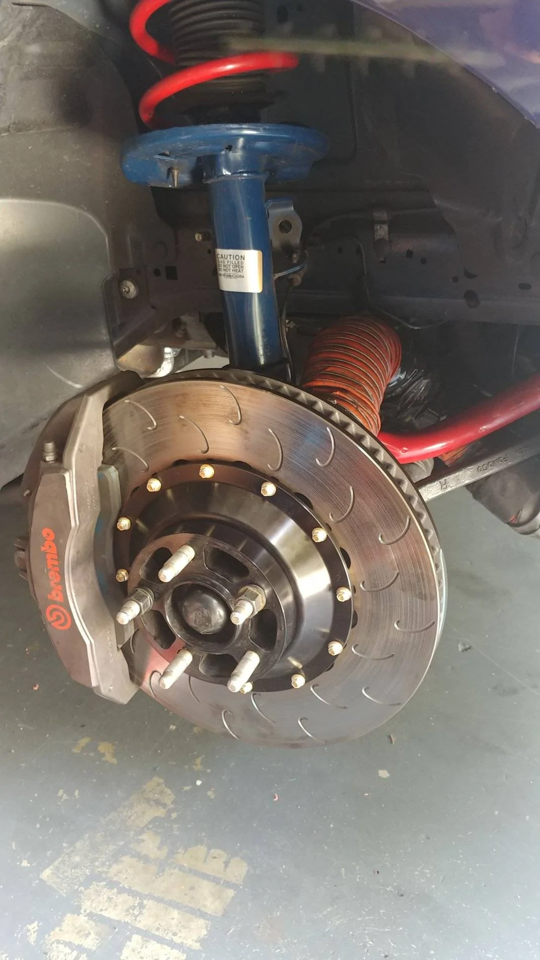

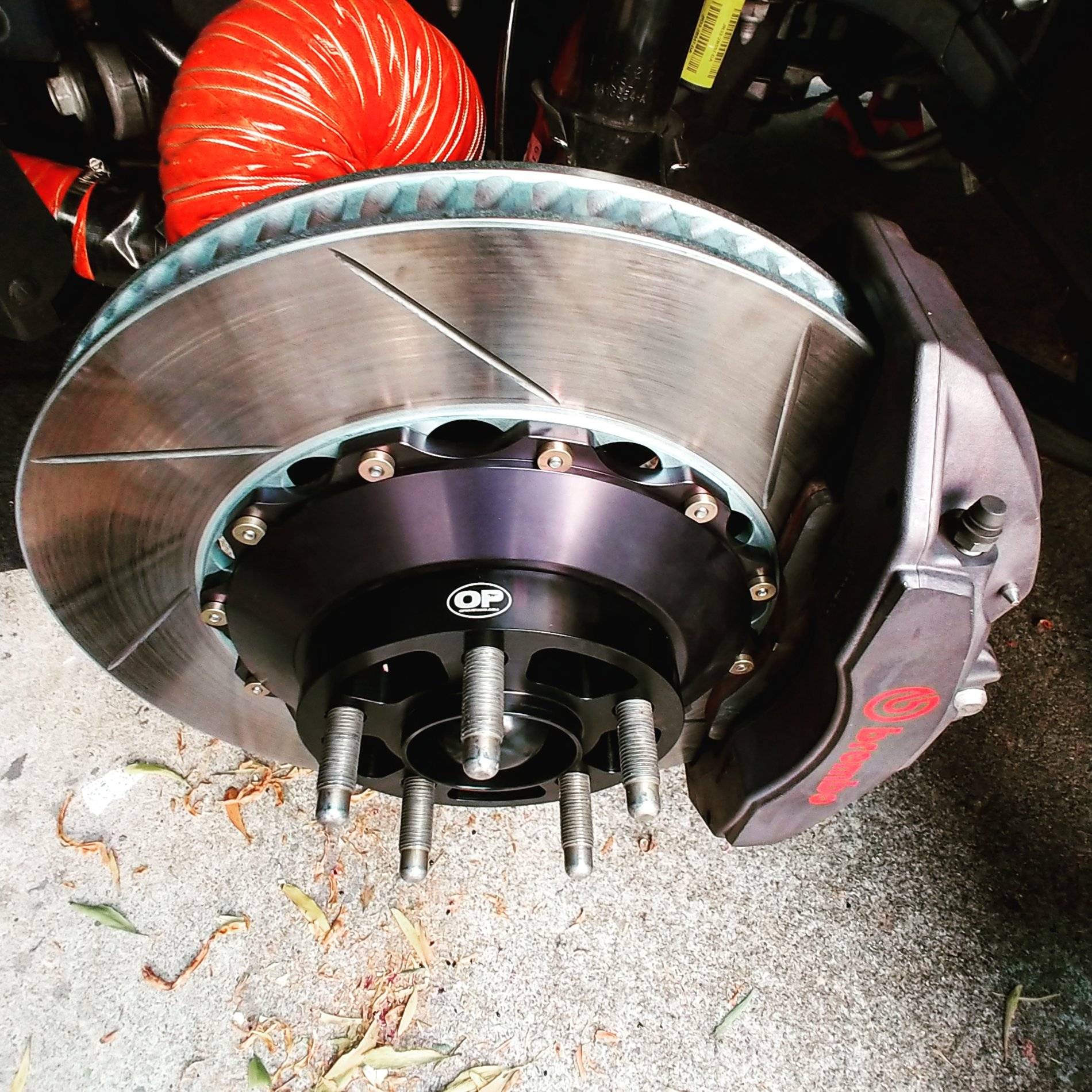

2. I upgraded my pads to Gloc r12 front and r10 rear with better result but still rotors were overheating amd car didn't stop well
I tried 2 aftermarket rotors
GIRODISC awesome product. Key pros : 11lbs lighter each. Much better heat dissipation = less wearing of the rotors and pads and more braking power(less heat so pads work better) =1000$ for both front. They last between 8-14 events (this may vary depending how fast you are and the tracks)
APR racing rotors. Great product. Slightly heavier than girodisc(half pound) but way more vents. These are my current rotors.
$1500 ish
If I was you i would take the GIRODISC to start.
NOTE. UPGRADE FLUID TO A GOOD DOT4 (motul 600 or 660 or castrol SRF)

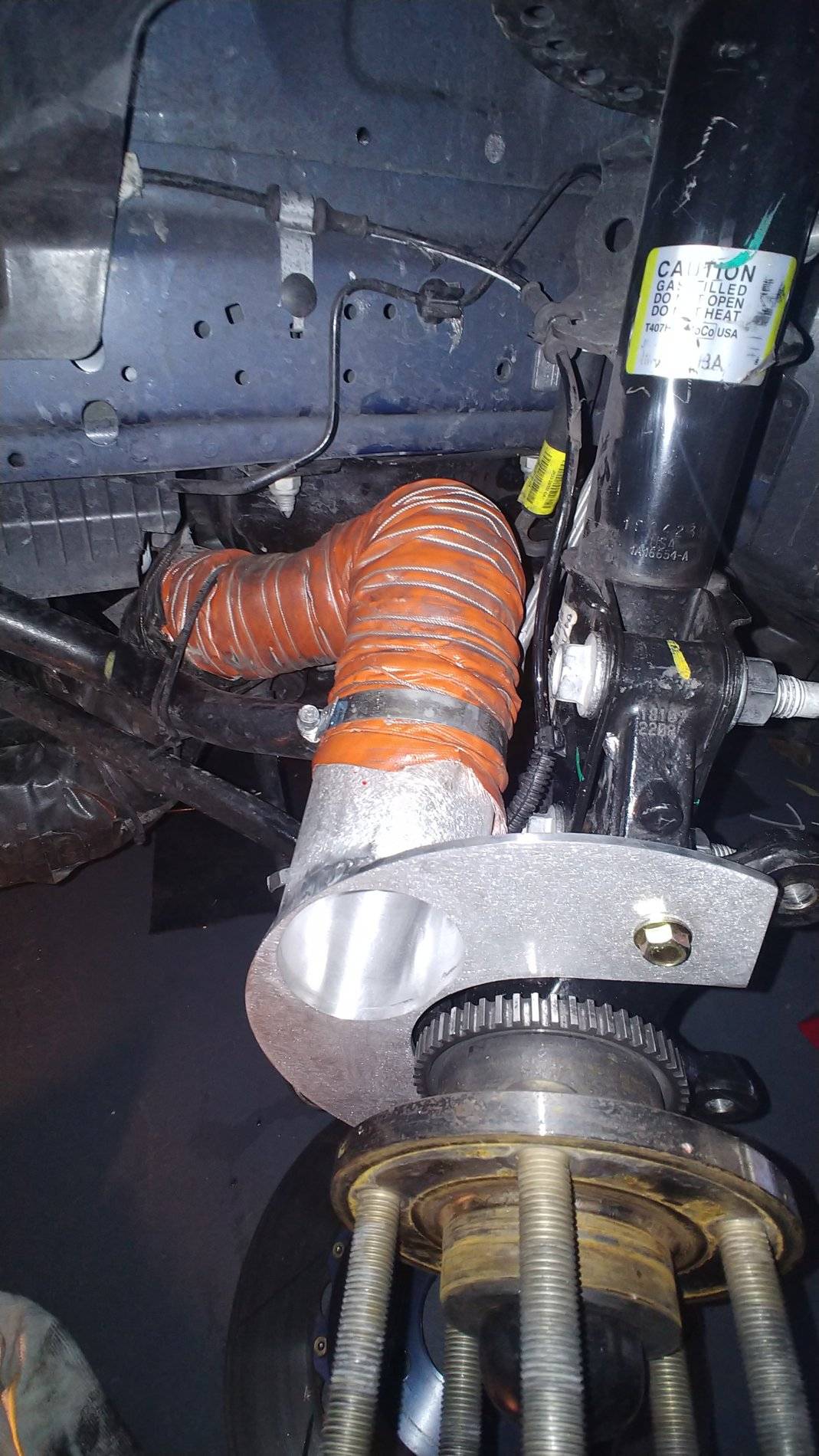

Note2. Ventilation is the key. You can go with hoses (like i have) or vorshlag now has a bigger air deflector that is proven to reduce temps up to 100f more than standard hoses.
