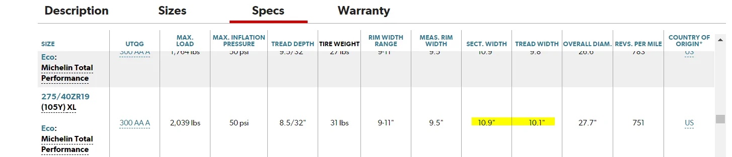

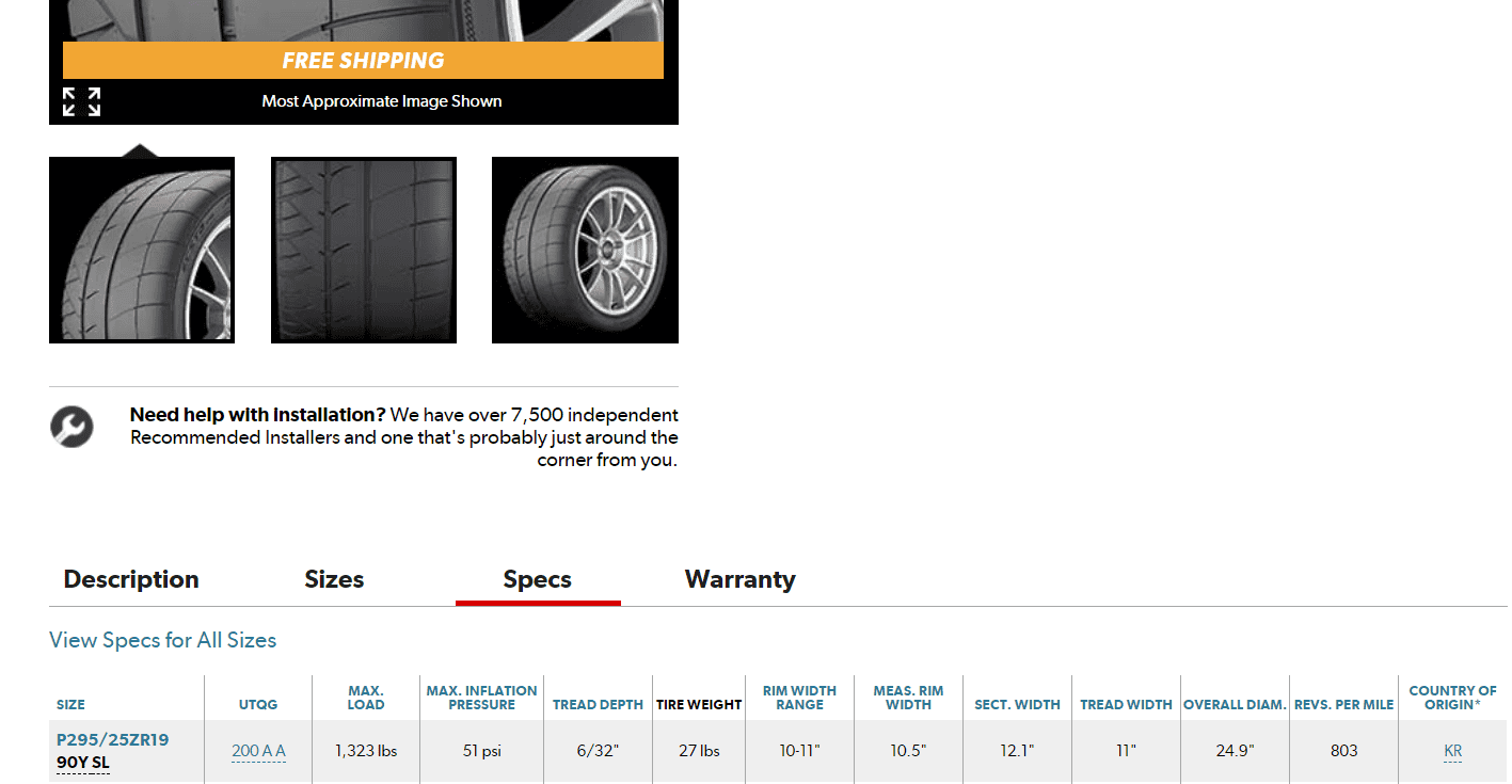

FYI
4s OEM diameter 27.7
vs
KUHMO ACR 24.9 (the more aggressive tire i tried )
2.8 inch difference and not issue at all.
