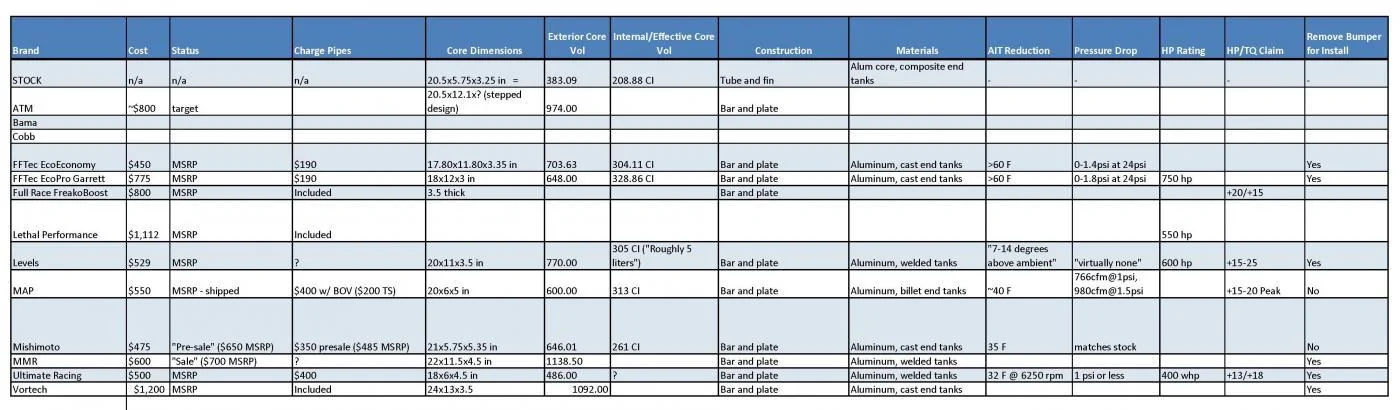

Here's a spreadsheet I put together to get the lay of the land.
PewterCam, maybe throw this in the first post if its helpful.
Cliffnotes: *updated 5/28/15*
Brand / $$$ / Core Dimensions / Internal Core Vol / Modify to Fit
  • Stock / n/a / 5.75x20.5x3.25 inches / 209 cubic inches / n/a
  • ATM / $729 presale / 20.5x12.1x? stepped / ? / Yes
  • FFTec Eco / $450 / 11.80x17.80x3.35 in / 304 ci / Yes
  • FFTec Pro / $775 / 12x18x3 in / 329 ci / Yes
  • Full Race / $800 / "3.5 thick" / ? / ?
  • Lethal / $1112 / ?
  • Levels / $529 / 20x11x3.5 in / 305 ci / Yes
  • MAP / $550 / 20x6x5 in / 313 ci / No
  • Mishimoto / $475 presale / 21x5.75x5.35 in / 261 ci / No
  • MMR / $600 / 22x11.5x4.5 in / ? / Yes
  • Ultimate Racing / $500 / 18x6x4.5 in / ? / No
  • Vortech / $1200 / 24x13x3.5 / ? / Yes
Full data: View attachment sizes1.pdf (click link for spreadsheet)
I put this up so people could have some sort of apples to apples comparison. This chart notwithstanding, there's more to intercooler selection than dimensions, core size, and price. I feel it important to forward some of the advice Adam@MAP has mentioned.
Paraphrasing-
The design of the intercooler is paramount over all else, including core size. Particularly important to look at are pressure drop, cfm, and core structure. If the intercooler can't slow down the charge air enough to allow for the core to extract heat, then it isn't performing its basic function. On the other hand, slowing down the air too much causes negative effects as well so you must find a happy medium.
The only true measure of an intercooler's ability is test results.
Both Levels and MAP have shown impressive results.
