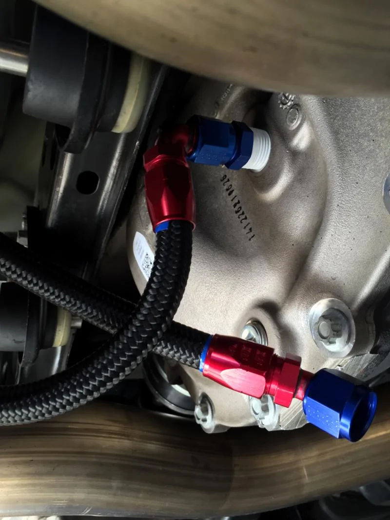

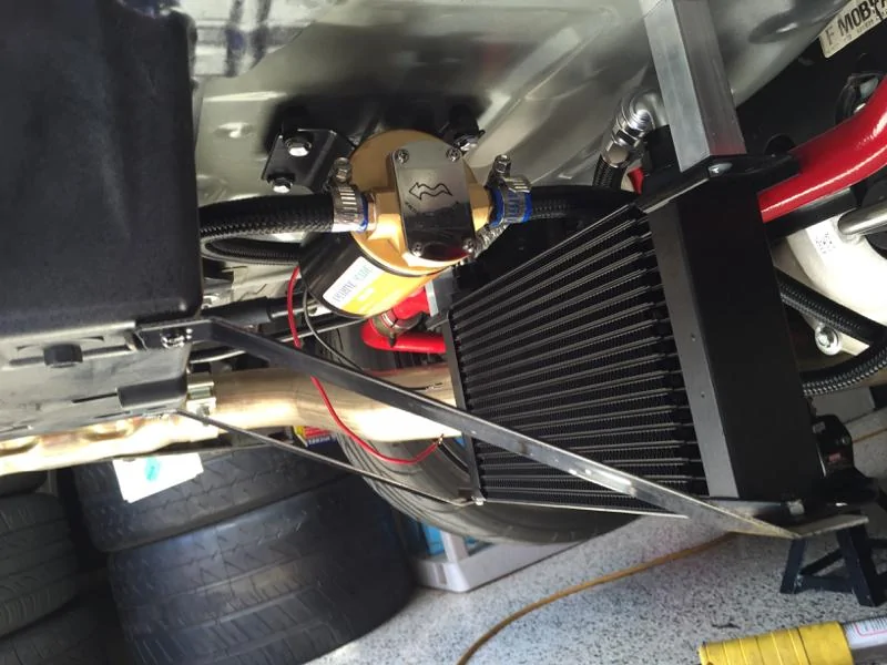

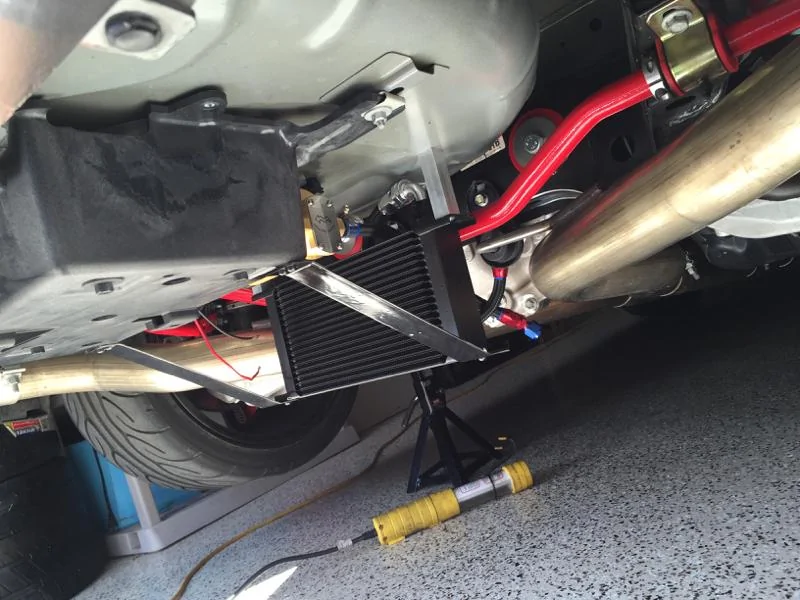

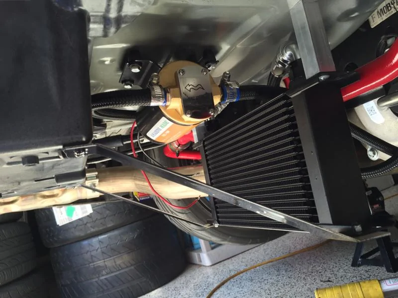

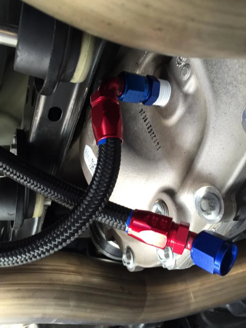

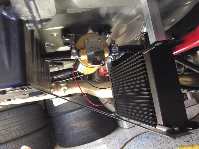

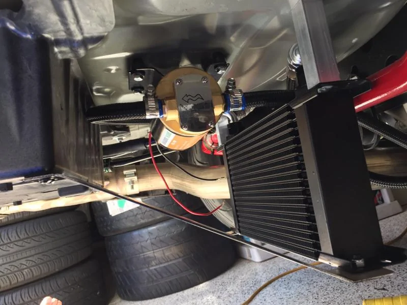

Gained 10 lbs with this mod. Electric hook up and oil change next weekend. might tuft test again this afternoon.
stoli
Fat Guy Racing
Sep 18, 2014
124
3,225
971
Lakeland, FL
John
'15 Black GT/PP
Looks good. Maybe it's just the perspective, but it seems a little low...
