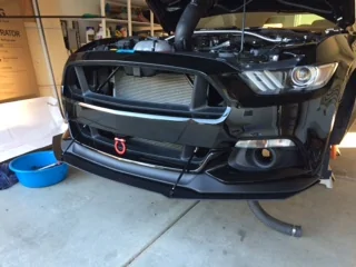

Ok, there is still some work to do here. The current facts are as follows:
1. Lowest point on my car is SW header collectors at just under 3", they scrape sometimes
2. Cooler is just over 3.5", so its low, but don't want it to scrape anything
3. Airflow at the top of the cooler is not great, see video which is roughly a 0 to 80 mph cruise. I'm sure at a track like COTA and 140 mph might be OK.
2nd tuft test:
So here is the plan:
1. Complete electrical hookup, change oil and check it pumps oil and doesn't leak.
2. Build a 2" shroud around front of cooler, to prevent air flow around cooler and scoop a little air
3. Put a curve in the back bracket so if it takes a hit it will bend back a little and hopefully not terminally damage the cooler core.
4. Do my Sep 3-4 track day and see what diff temps I get.:thumbsup:
More to follow...........fyi, I've got maybe $500 in this project, and steel braided line is best cut with a fine tooth hack saw. :doh:

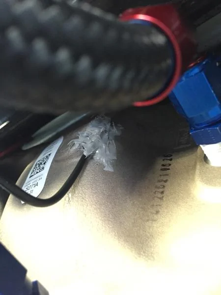

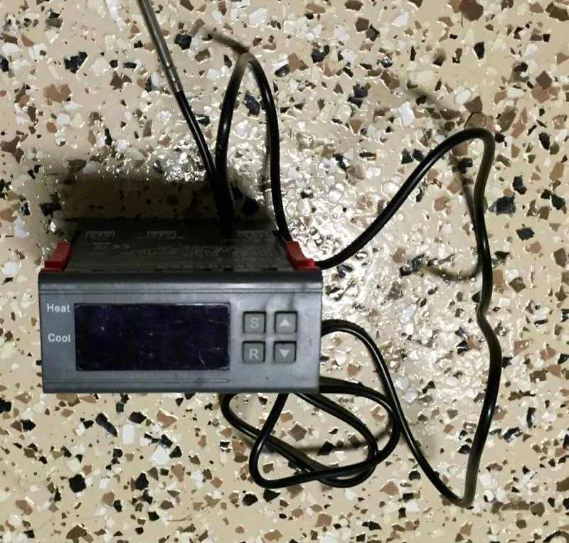

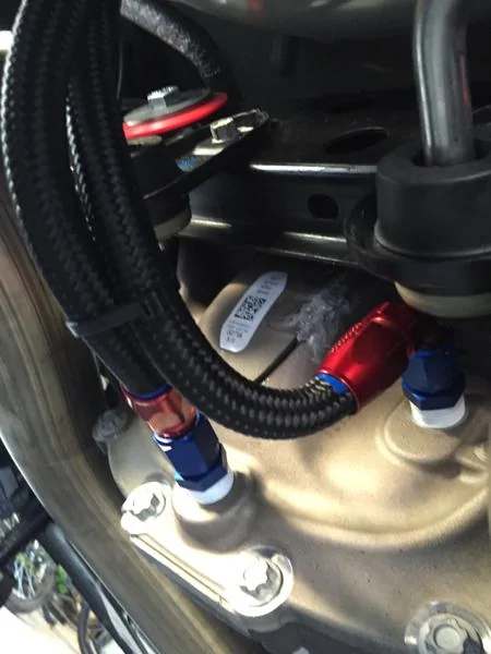

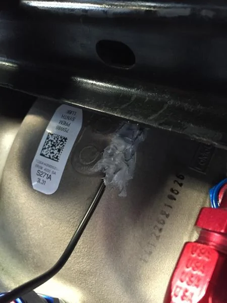

Diff cooler update
Worked on the diff cooler a little more this weekend, my garage sauna and family only had me at it for a few hours but here is how it looks for those interested:
1. The temp sensor probe is glued to the diff cover with grey firm silicon. Hope it stays on there, sorry its not very neat, but the temp readings are accurate for the surface its mounted on.
2. I'd like to pimp this little temp controller I got. It was $8 on eBay, reads degrees C, but is great. Has a max of 120 deg C and I have it set to come on at equivalent of above 203 deg F (95 deg C) and off at below 198 deg F (90 deg C). You can set the pump on / off window and it reads out constant live temp. It is also rated to 10 amps, so I'm not running a relay for the pump.
3. The pump moves a lot of oil, probably could use something half the volume or even less, but it is cheap.
But i've only tested with my battery charger.
Anybody know where I can get switched power? Haven't found a good place yet.
So for now it pumps, doesn't seem to leak, and I just need a good source for switched power.
