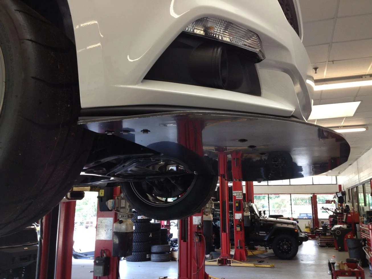

I have finished the safety and mechanical systems, brakes, fire system, cage, seats, harnesses, suspension, oil pan, headers, and radiator ducting.
I am in the process of building the exhaust today and tomorrow, then I will start on a functional rear diffuser. The splitter is already done. Then the last thing is to join the two ends of the car with flat removable panels and figure out how to get air to go where we want it. Last step will be a wing if needed to balance the aero.
Next test day is 7/20 so have to do things in steps in order to have time to make each event.
First event went well with just the safety and suspension mods complete. Car did fine but my test track is Gateway International and we run two of the Nascar turns and main straight then dive into the infield road course. I was able to dial in the suspension with minor shock changes but I did find an issue I will need to address soon. The car would fuel starve coming out of the left hand high banked turn. Even with over a half a tank of fuel the car would loose fuel pressure at the end of the banked turn. I am going to run the stock fuel tank as long as I can so I may need to add some fuel safe foam to close off most of the tanks hump in the middle to stop the fuel from sloshing to the other side of the tank. On the topic of cooling, it was 99*f that day and the car performed without any temp issues. The PP rad is very capable if you duct it properly and remove the AC condenser from in front of it. Coolant temps never exceeded 225*f even with ambient temps at 99*f. I am expecting a 5-7 degree drop in temps once the hood vents are in place. Diff temps, trans temps, and oil temps will need to be addressed if I decide to do anything longer than a sprint race.

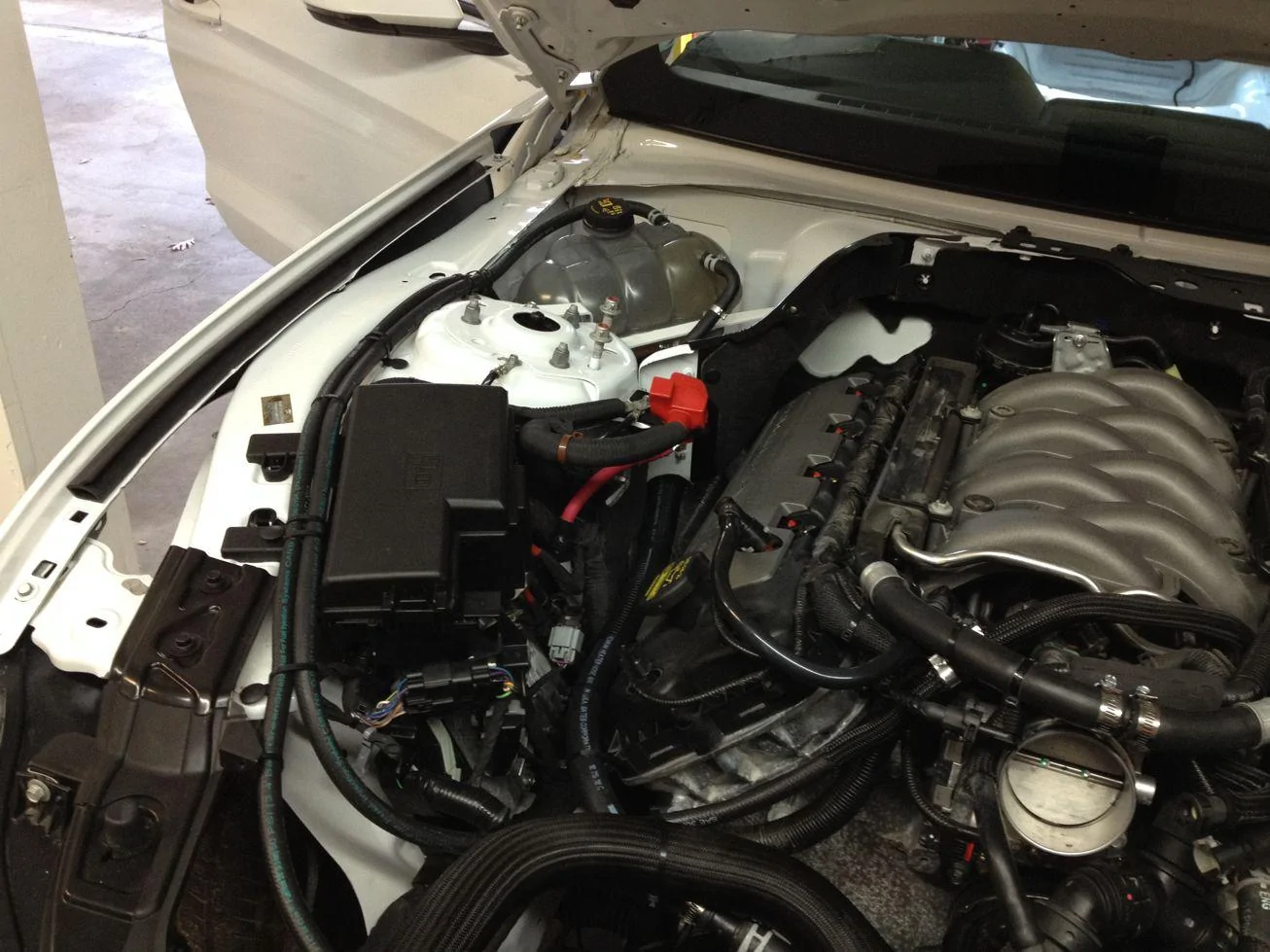

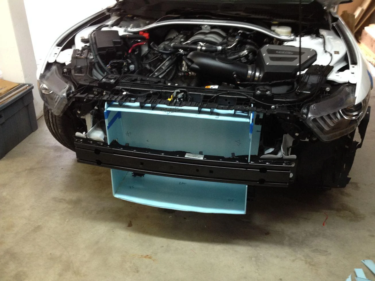

On the cooling discussion... what have you done as far a ducting for the cooling system?
No build thread yet, I will have a racing journal and build info on our projects page on our website when I have time to sit down and write everything down. I have tons of pics as the car was being built and want to get a little closer to being done before I share everything.
I relocated the battery and the coolant bottle so there would be more room up front, I remounted the top of the radiator forward about 20* and built fiberglass ducting to seal off all the airflow from the grill openings and force it all to go through the rad. I also replaced the GT PP grill for the Ecoboost grill as the open area is much larger than the PP grill.Once the ducting was built and installed we have had zero issues with coolant temps, and the OEM oil cooler is doing a reasonable job as long as you are doing short sessions, 25 min or less and oil temps stay in check. I will see what happens on longer stints and may need to add an additional oil cooler. Having the Moroso pan with its extra 2.5qts of oil should help extend the time on track a little as well. Adding the hoods vents should help extend it some more too.
