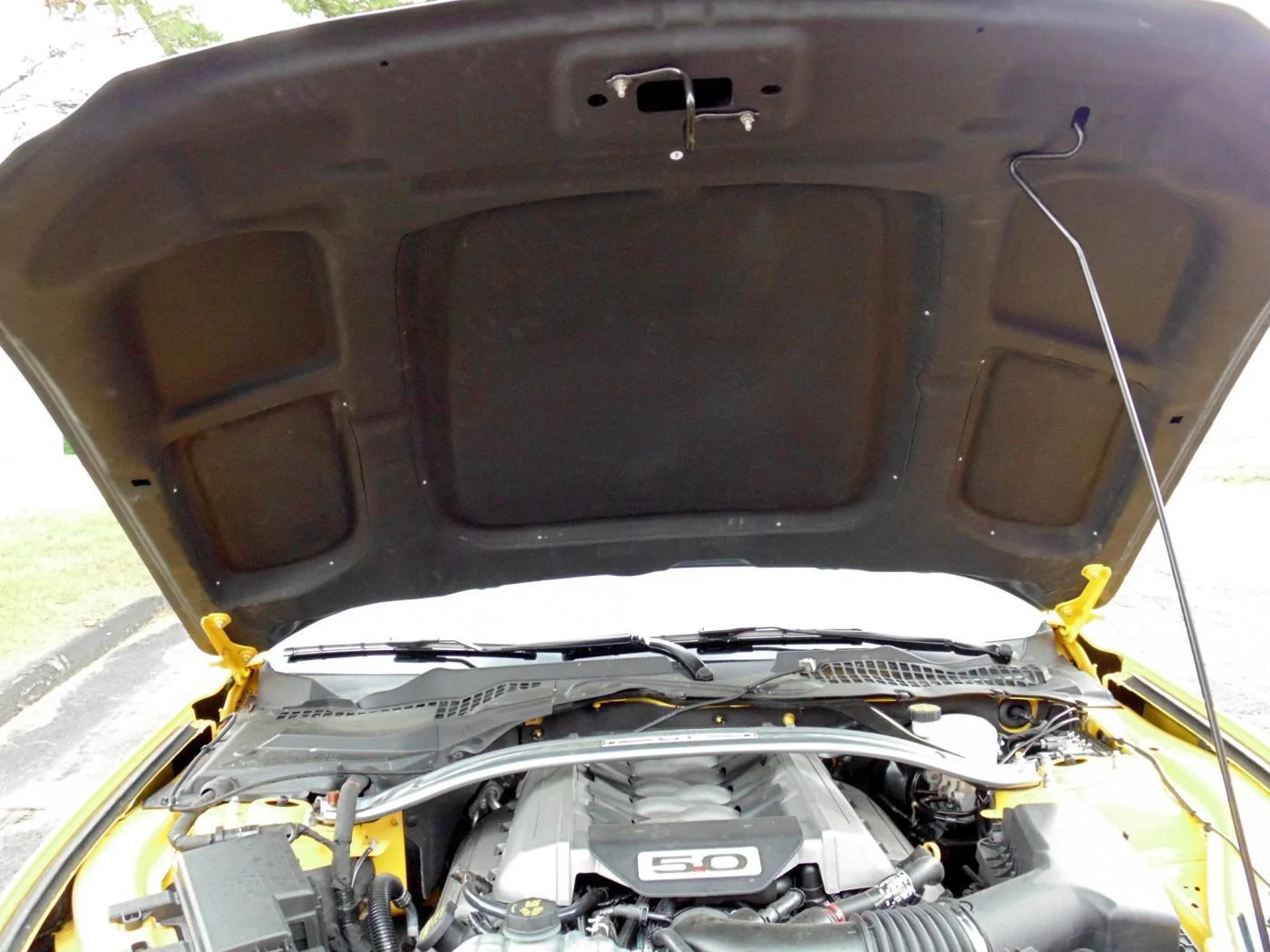

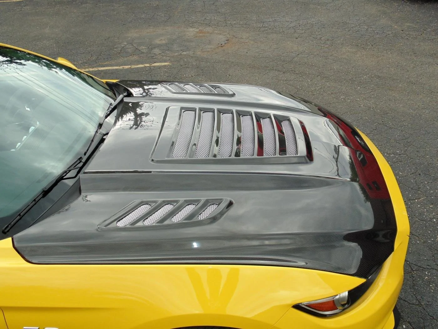

This is a new hood from KoHr Motorsports. I stole the pictures from Dean's post. Pretty sure this will eliminate all lift and heat issues under the hood. This way you don't need to chop up your factory hood.
We are willing to supply them to Customers in Florida (Especially Central Florida) I spoke with Dean about it, he is onboard.
$1429 For the Carbon Street Hood.
$999 for the Fiberglass Version.
"The cool thing is that it has removable panels on the under-side to prevent water getting on top of your engine if it rains. They are removable. The screens are removable for max aero also..." - Dean
I will handle the freight to Florida and you can either pick up or if I have enough interest I may deliver/meet half way. If 3 people in other areas outside of Florida want to get together and pick a shipping spot that works as well. The cost to ship single hoods is just too expensive.
Obviously freight is the massive issue involving hoods. We are willing to absorb that and work with anyone to get the hood to them assuming they are in our area.
Let us know you can contact through our website or here via PM.

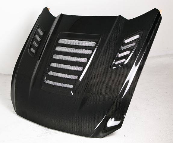

I love what Dean has done with Mustangs over the last 20 years but that hood is bleh! Too fast and Furious for me. They have the Anderson Composites Heat Extractor hood on Nate Stacy's T/A2 racer that I think looks much cleaner and should perform as well. Just my opinion.

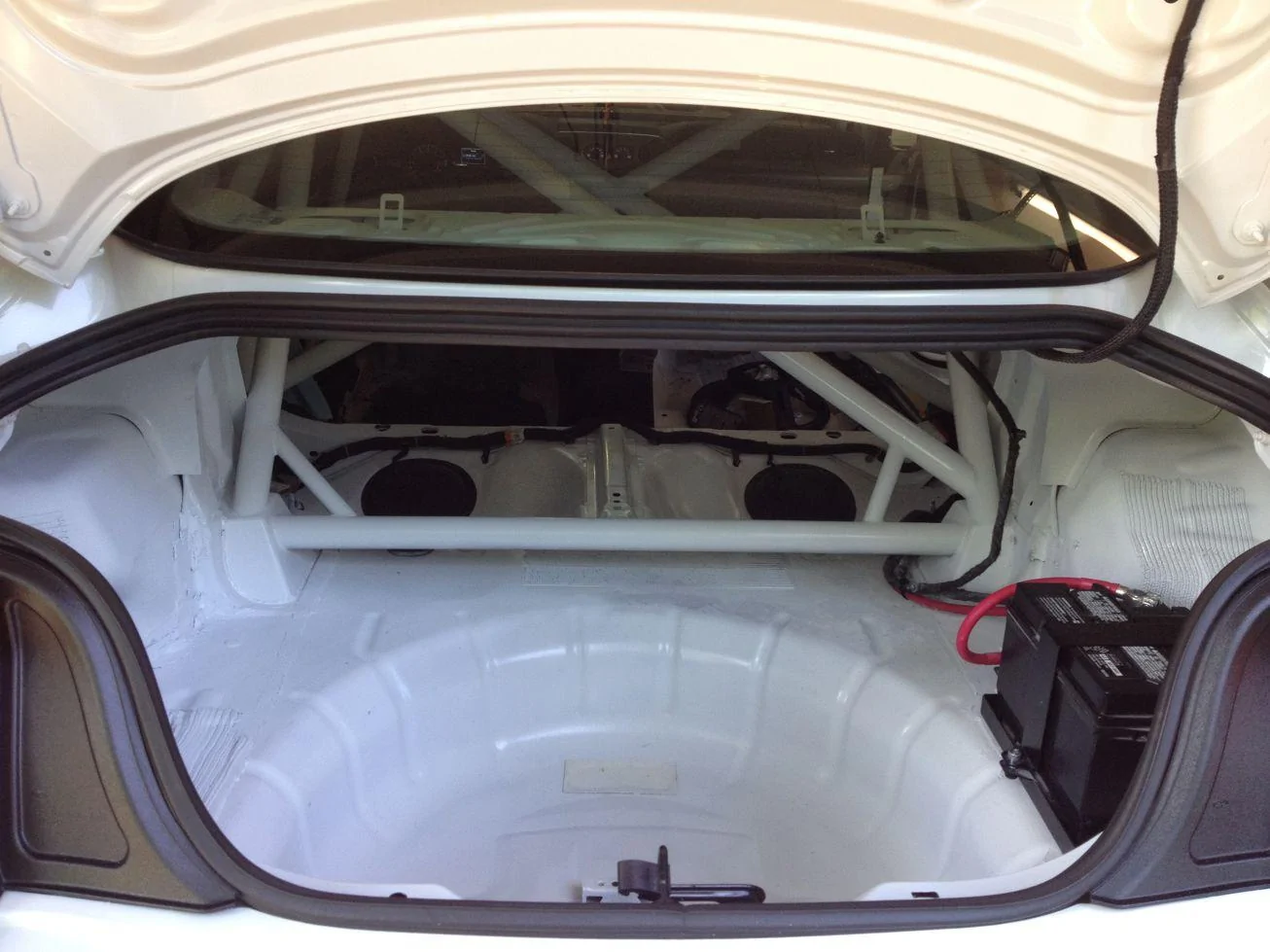

Since it looks like you are moving along with the install make sure you keep in mind that you may someday add a fuel cell and relocate the batt to the trunk as well. My concern would be having to move things around if the fuel cell gets added and having to do everything twice.
I would find the dim for a fuel cell you would likely need and make a card board cut out of its foot print and lay that were it will need to be, then place the pumps and coolers around that so they only have to be done once.
Your car looks very similar to mine.

AAArrrgggghhhh!!! I knew I should have asked long ago! :lol:I've already put the battery at the back of the spare tire well...and the trans/diff cooler is going into the front of the spare tire well. Well, if it ever comes to a fuel cell, than I'll be shuffling. Thanks :thumbsup:

I hear ya! Will PM you for details on some weight stuff when I get a chance. Tell me what you (all of youze guys) think of this cooler setup. We're using a Derale double cooler to do both trans and diff (AN8 size in & out). Think this will be enough??? Do you think I should duct air in from outside? Or will the fan be enough??

Well I would rather see the cooler outside the car, did you cut out the trunk under the cooler and relocate the charcoal canister from under the car? You would then need to push the air through the coolers with the fan and out the bottom of the spare tire area to under the car. Another option is to duct air in and out of the tire area. Without getting the air out of the trunk you will heat soak the air in the trunk as it is recirculated through the coolers. That setup will add a lot of ambient heat to the interior of the car even with block off plates.
The fan and cooler will be fine as far as size goes, the heat load from a manual trans is not that bad and the diff is not that much either. If you can setup the pump and fan to run on a thermostat with the key off or from a manual switch on the dash that would be best. You want the pumps and cooler fan to continue to run after the car is shut down back in the pits and keep running until the min temp is reached. Most of the setups I have seen will run 3-5 min after the car makes it back into the pits.
