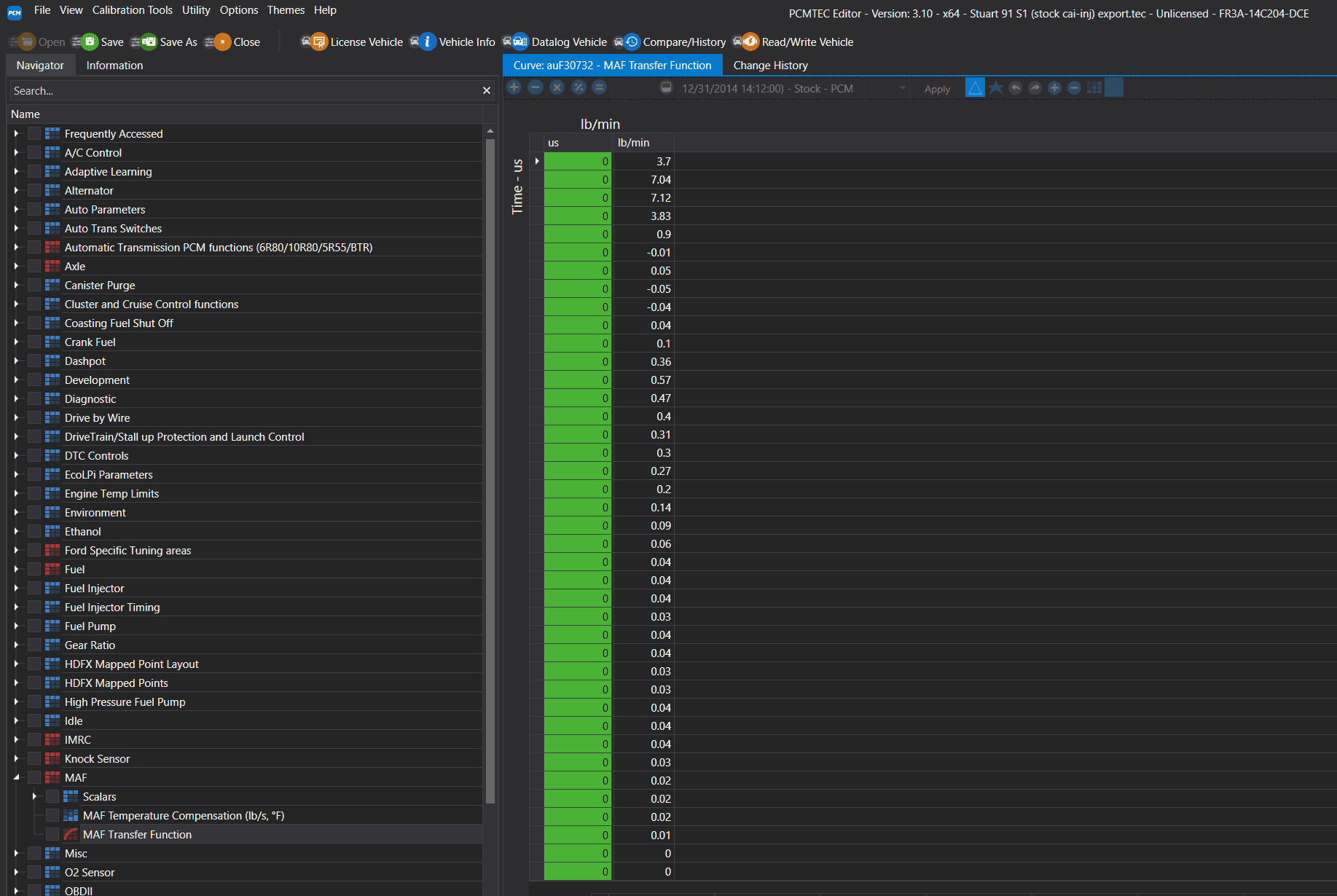

I should be able to use the ford data and not touch it because the slope multipliers will correct for the pressure difference
Correct.

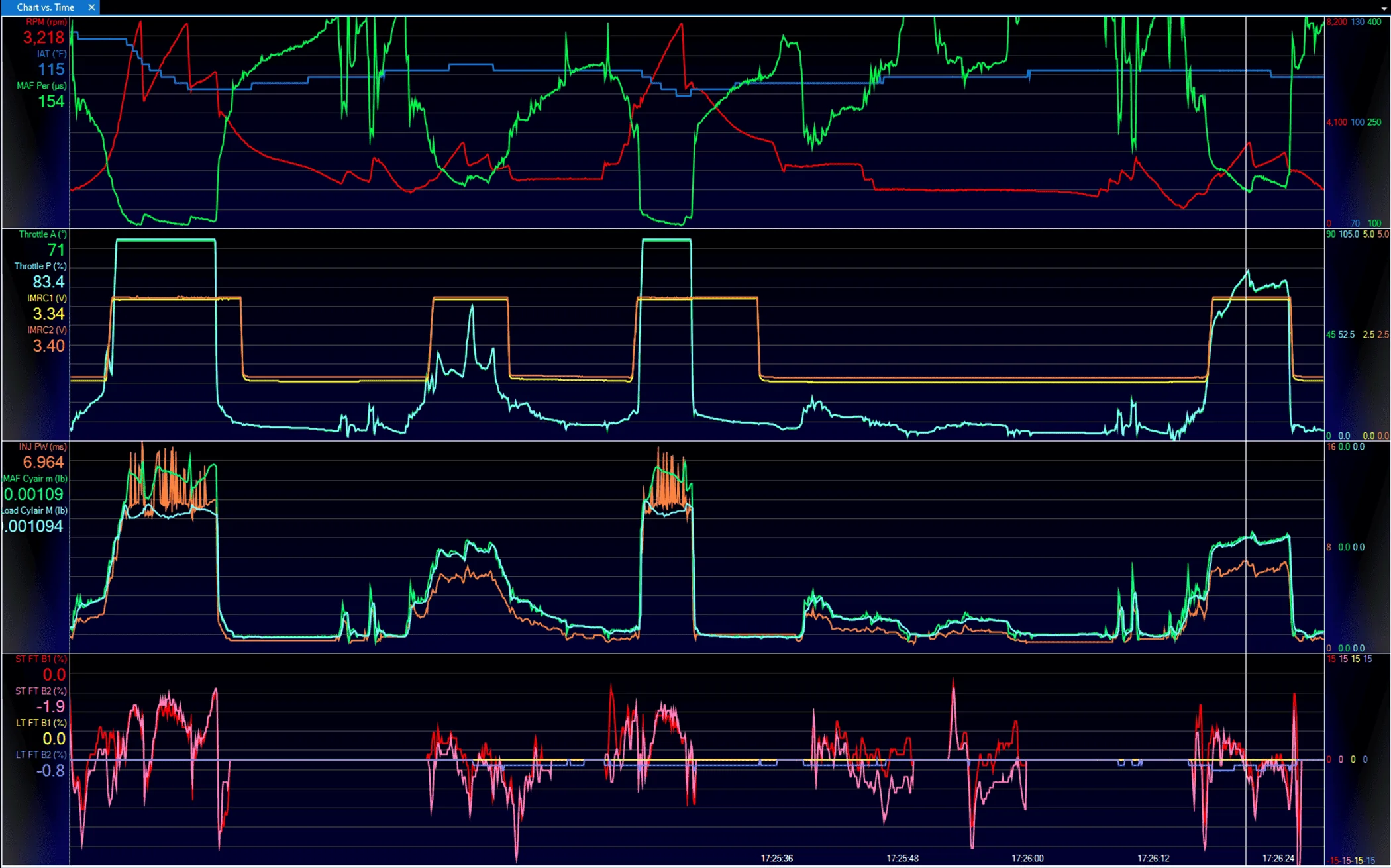

Put the car to stock injectors and cai and can't get the fueling dialed in at wot.
I am logging the maf and stft and then adding to the maf data but the lb/min keeps increasing but stft aren't getting better.
Doesn't make any sense to me... It looks like the car is just ignoring what maf data I give it for wot.
Attached is log and tune

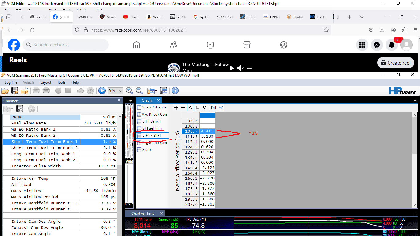

I didn't see any WOT difference. What you need to do is multiply the 111.3 and 106.6 cells by 3 or 4 %
I usually make corrections by half %. If the cell needs 5% I usually correct 2.5%
You have another issue at idle but I (after chasing my tail for months) just get it close and live with it.
Rest of the curve looks great.

I like to tune using the math parameter LT + ST
Exactly there is no difference.
Go look at the tunes. I added like 5% 3 times. Look at the maf in lb/min between the the logs. One is like 50 one is like 43 but the fuel correction is the same

Yup just stay under 80% throttle LOL.
MAF and Load are not agreeing once pedal and throttle go above that. I see you added 3-7 lb/min in the WOT area of the transfer.
We know the cylair filter is causing this.
Its either throttle body or something to do with a speed density limit. Hack at it and go down with the MAF values and the injector values?
You didnt have calculated manifold pressure or much of the throttle position voltages in the logs.
So I can really tell you much else beyond what we already knew.
