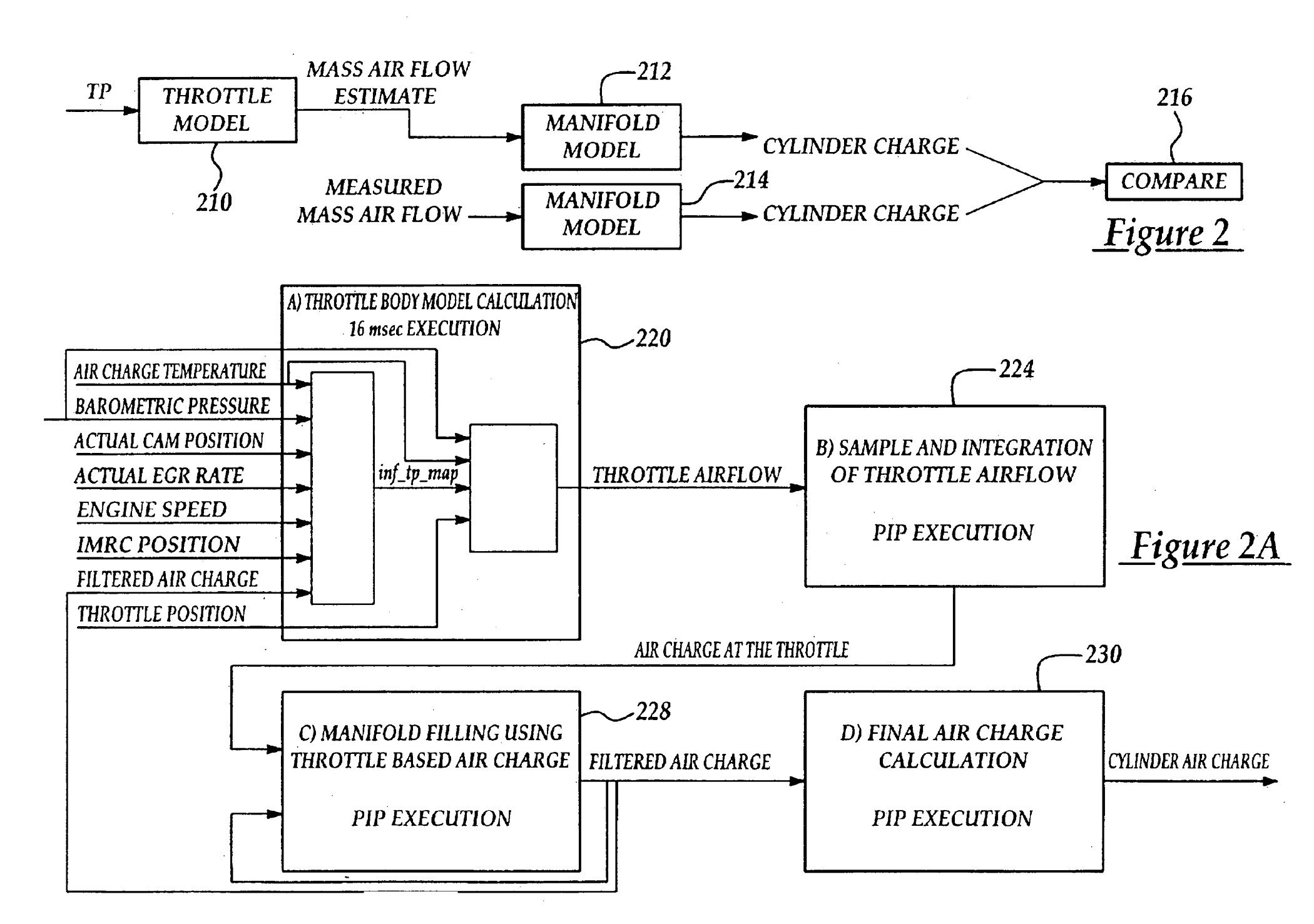

Figure 2 is the simple explaination of the "aircharge Filter"
2A block 220, as much PIDs that will cover most of them going into or in that block as you can.
For throttle I want to see position sensor voltages if possible. I think you may get pedal voltages, but I want throttle position voltages.
