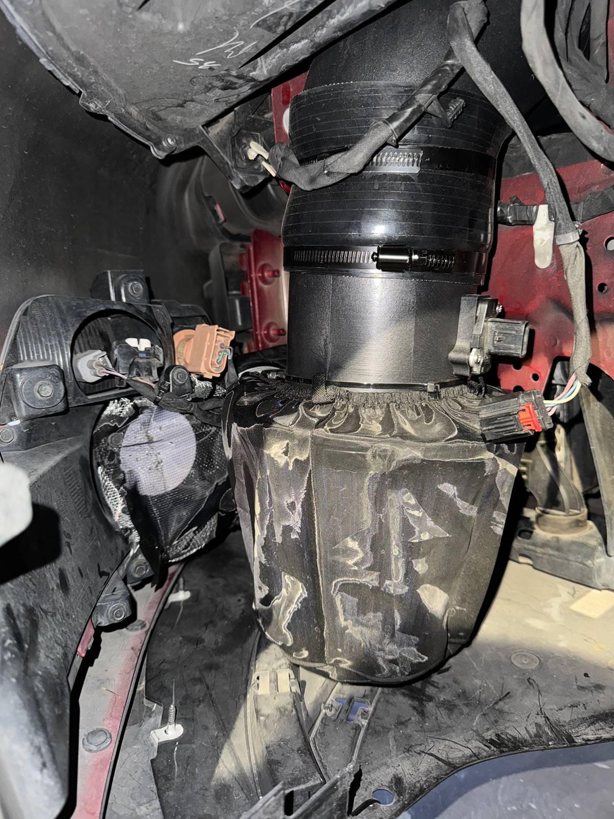

Top black PMAS hose clamp isn't positioned correctly or seated correctly on the rotary formed/blow molded plastic duct. Not a good situation, possible air leak post MAF sensor.
I don’t know why you think that but it’s seated fine. There is a groove in the plastic that the hose clamp is in. I can re do it tomorrow without it being in the car and it will look the same

That's wild they basically have the MAF sensor in the air filter. Surprised there isn't more turbulence.
Because of this picture:
The top worm clamp doesn't look seated right. The bottom one looks right, but the top one looks like it squeezed off the edge of the hard plastic and is pulling into the silicone coupler.
Seems odd given your issues with fueling.
The top hose clamp area towards the the front of vehicle appears hourglassed. It’s looks as though it’s slipped off the duct tube end. Your photo could just be the camera angle and some shadowing ?

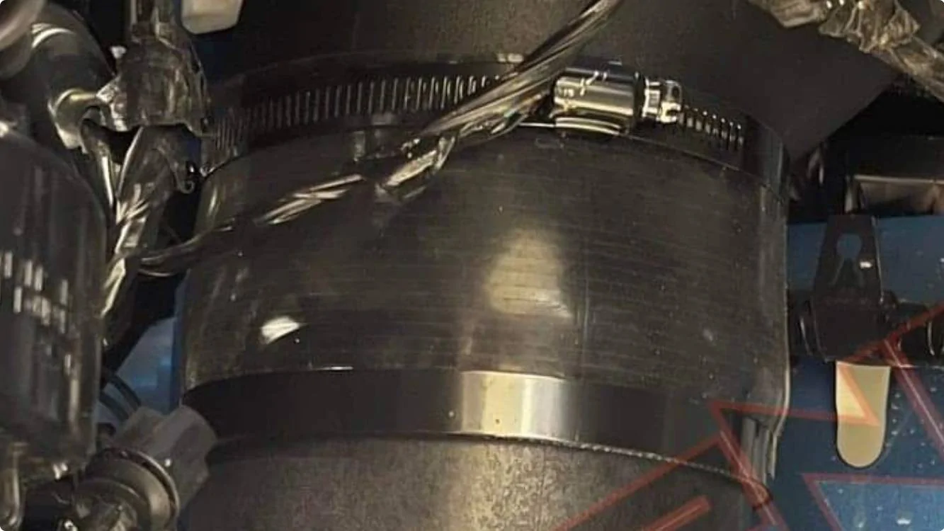

This image appears properly seated on both ends.

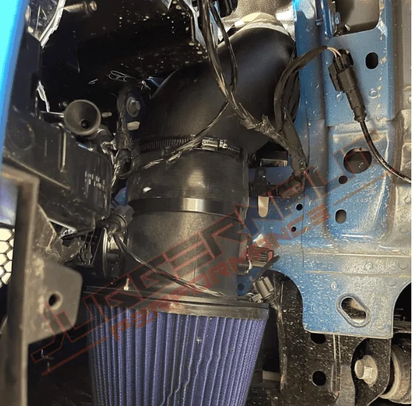

here's a picture from juggernaut:
This is what we'd expect to see

The top hose clamp area towards the the front of vehicle appears hourglassed. It’s looks as though it’s slipped off the duct tube end. It could just be the camera angle and some shadowing ?
Issues with fueling is not a mechanical issue with the cai atleast something I can control.
I’ll put it together for you out of the car. The silicon adapter is a little big and the plastic tube is at a weird angle and being pushed to the side to help with engine bay clearance
