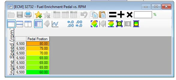

Your 32732 table is strange and may be the reason you're having inconsistencies there.
If I were the ECU trying to figure out when to go into PE I would be confused as in should I make the switch at 80%, 75%, 70%, 65% or 60%? Change the axis values to different RPM ranges or make all the values there the same. It may help.

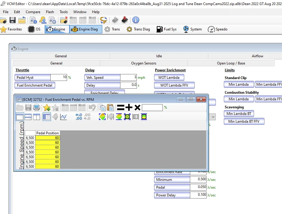

Thank you very much for looking. However, hmmm.
My 'Aug 15 AM' calibration had it that way. The one I just posted and zipped (zip Aug 31/calibratino file Aug20) looks like this, at least when I open it in my editor.
I may have downloaded an old file then. Anyhow, if you want PE to come on sooner, adjust the axis values and pedal position values. That way you can have it ramp in sooner than later if that's what you're looking for.
