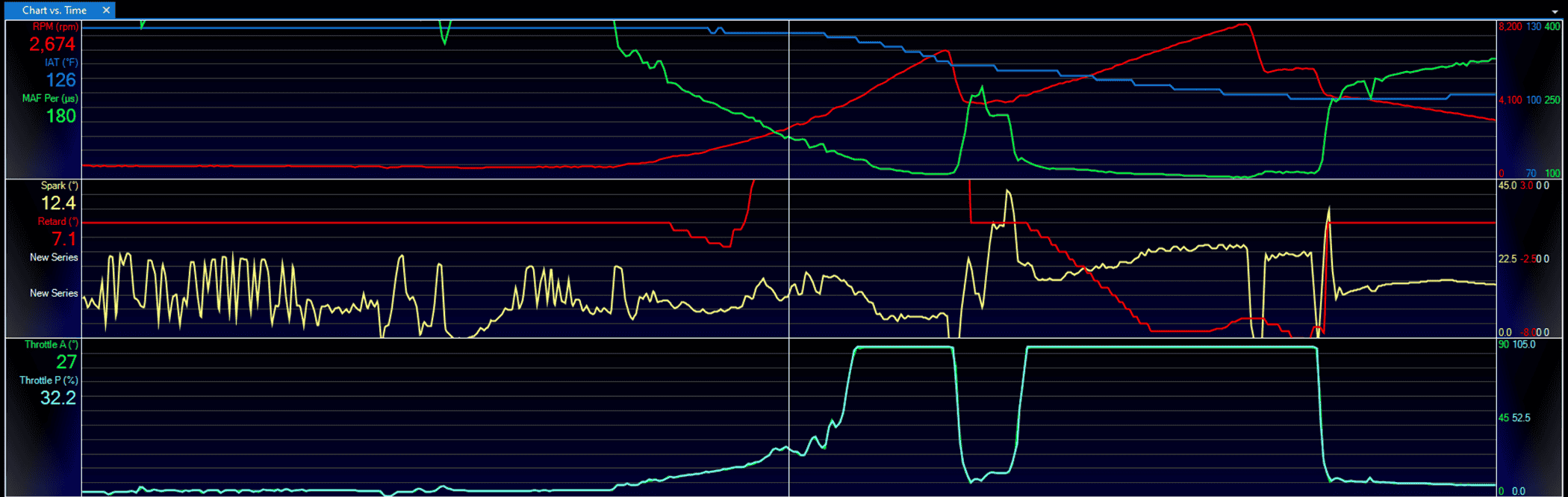

He's logging knock retard and it's all negative so it's adding timing. He needs to add more timing to his tables.

Hes worried about this part in 1st where it spikes to 10 before he even goes WOT.
I hesitate to say its false, but im not worried about it.

Ah I see it now. I was only looking at the log near WOT. Looks like it was during wheel spin possibly? Strange.
