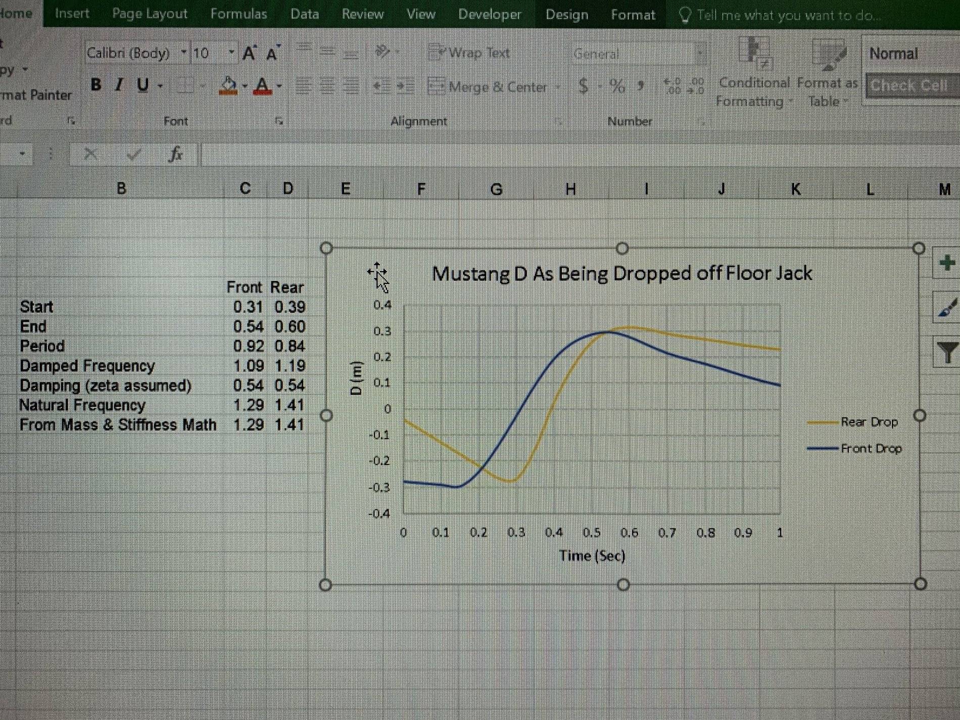

Adjustables can be nice for people who use for performance driving regularly, and need to go from rebound damping ratios of 0.3-0.4 on the street to 0.6-0.7 for autocross/track, but nicely matched fixed is a better option for the road. It's easy for people to muck things up with a knob to turn, and it's just more parts that can break. It's easy to sell knobs.
Compression damping ratios of Koni yellows is ~0.54 with stock PP GT springs. Rebound isn’t measurable any easy way. I measured this by dropping my car off a floor jack and using a cell phone accelerometer + my nerd skills.
There were other plots, but I’m not near the computer.
How did you do that independently F/R? That also only gives you damping at one shock speed and rebound definitely still comes into play at the end. Nice work though, I appreciate people doing this.
I jacked up the car from the pumpkin and then dropped the jack while a cellphone was mounted to the rear glass.
for the front I jacked from the front cross member with the phone mounted to the hood.
Most people would prefer not to jack up a car that way, but it works.
The vehicle responds at the Damped natural frequency. One speed, but also the most critical speed where the shock has to work hardest.
