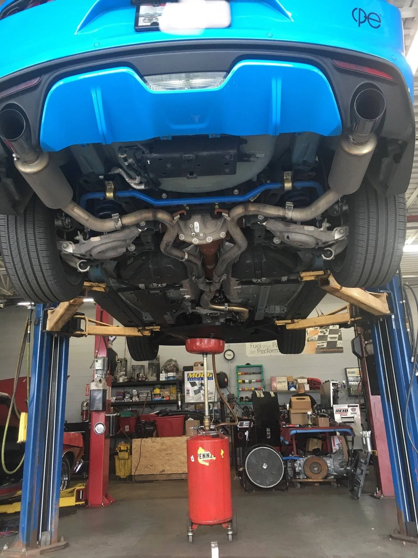

had some new bg shift fluid tossed in recently snapped a photo. Here’s the sways and you can see the blue springs
