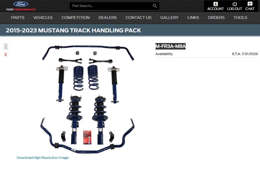

Option 2 (Wait for FP Track Handling to get back in stock and order...):
  • Ford Performance Track Handling Kit (M-FR3A-M8A)
  • Maxim Motorsports Caster Camber Plates (Mm6CC-10)
  • Steeda Stop the Hop Starter (or BMR alternative?)

FYI, I just followed up thru the Ford Performance Portal on the M-FR3A-M8A, since I've got a few orders and the date has been pushed back a few times. It is not looking good.... as of Today, 7/31/26.

There are people who have been waiting on the Track Pack from FP to go back in stock for like a year+.. so i would find an alternative. I had to piece it all together separately (didn't cost all that much more, maybe 100$?) but couldnt find the sway bars so i did the steeda sway bars which turned out fine.

Following - in the exact same spot on the FP Track Handling Pack. I am a base non-PP, still on stock rims. FWIW, I first started calling around back in late July/early August and was told it was on backorder until mid-October. And now it's July 2026 😞
