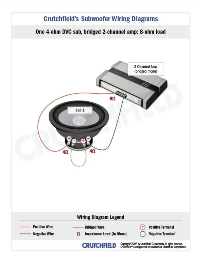

Quick question, I installed a shallow mount rockford fosgate p3sd2-8 in my stock 2017 premium box, direct plug and and play. Isn't enough power I believe so I'm hooking a amp into it using a loc, can I tie the speaker directly into the sub wires to the amp? Also a dual voice coil but my wires are blue- blue white on one side and red- red white on the other. Can I just put the 2 positives together? Thanks

Hey Tyler,
I don't have the wiring diagram for the 2017 audio system so not sure about the wire colors you have. Also I cannot say with your system that you can join the two positive audio sub wires together like I did with the B&O system. Do you have a B&O audio system in your 2017? I'm really only familiar with the B&O system that are 2020 and up and don't want to be giving you any wrong info or advise.
I don't think it's the same as the b/o system, I believe yours came with a 10". Same concept i believe, Mine came with a 8" so I replaced it with a rockford 8" dual voice coil. It has an amp on the back of the box I'm gonna tie my positive and negative from my loc to the 2 preamp wires at the box and was gonna tie in my speaker wire post amp before the box to the amp, I just didnt know if I need to run them separately or tie the positives together? Or I seen somewhere that you use 1 side neg and one side positive.. I'm not an audiophile by any means just know the basics thanks

When you mention you want to tie the two positives together, are you talking about the two on the dual voice coil speaker or the ones coming from the audio system that will be supplying the signal to the amp?
[/QUOTE
Well I'm actually grabbing signal pre amp from 2 wires going into factory amp and wiring those into the loc, tieing the the positives together on loc and negatives together on the loc. Then I've got 4 wires post amp (speaker wires) that I need to tap into to run to my aftermarket amp. I wired everything up yesterday just waiting on the loc. Finally got in touch with Crutchfield and he gave me this.. so I might have to go back and rewire the sub wires (I guess to get the right ohms?)

Looks like since I'm gonna have to use a jumper wire from post 1 (negative) to post 2 (positive) on the dual coil sub I will only need to use 1 negative and 1 positive coming out of the box? And just put wire caps on the unused wires? Still waiting on my loc so I'm gonna rewire the setup and see if the speaker still works not being hooked up to amp
You would connect it this way if the amp is rated for an 8 ohm load like the one in your diagram because it's bridged. If it is not a bridged amp and a standard mono 4 ohm amp then connect it up to the dual voice coil woofer but don't use the jumper.
