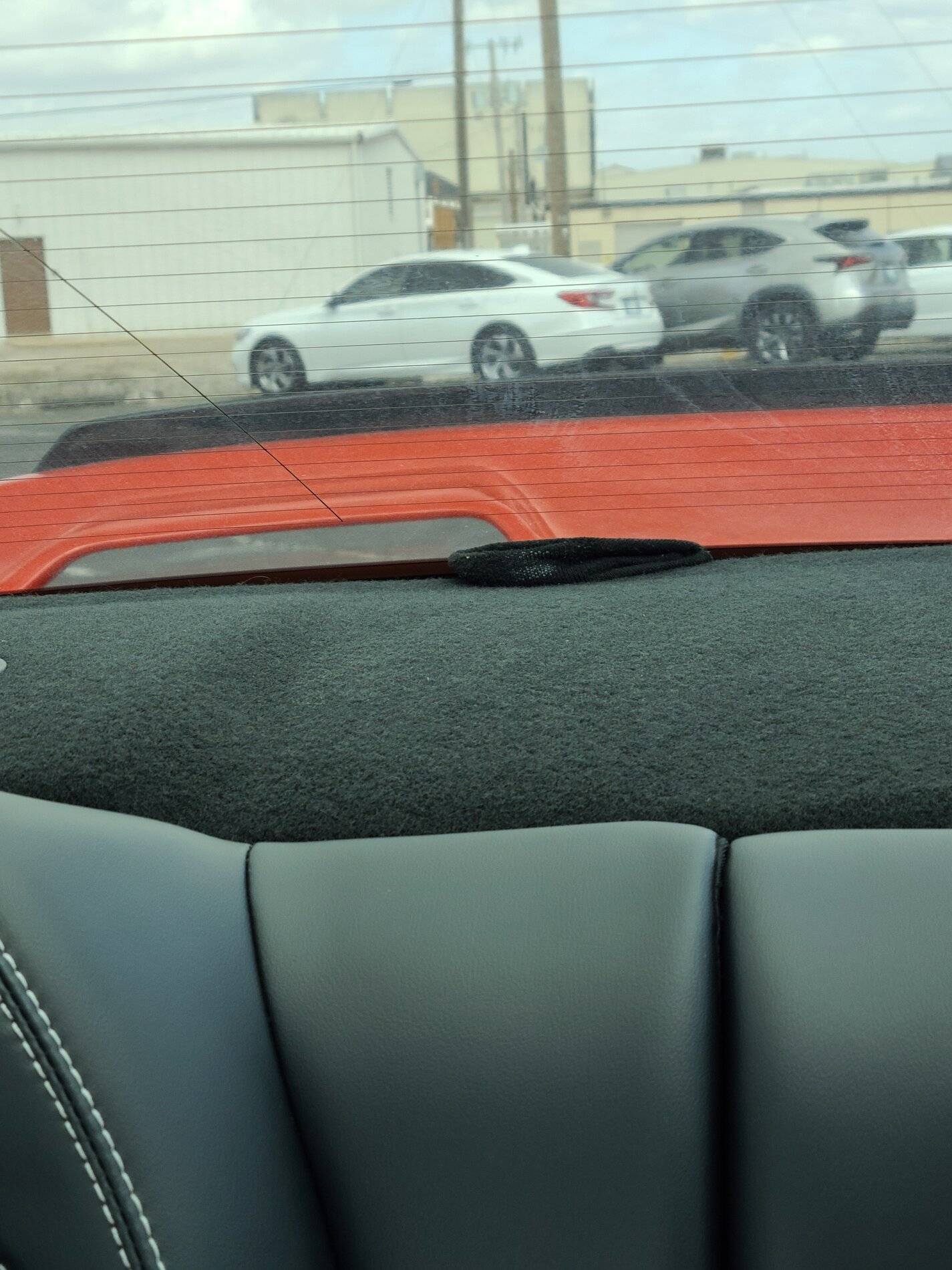

Well sometimes you have to improvise for the short term. The rear shelf rattle was unbearable in my car so i wedged a sock between window and package tray. 95% fixed. Researching shows to dynamat the area really well, even double, seal it up, and possibly sometime of weather striping at edge where it touches window. I am up for suggestions, remember my bass is at miniscule levels right now so once i get the subs/gain figured out its just going to get worse. Not sure of the exact model but mens large sock works pretty well. :like:
