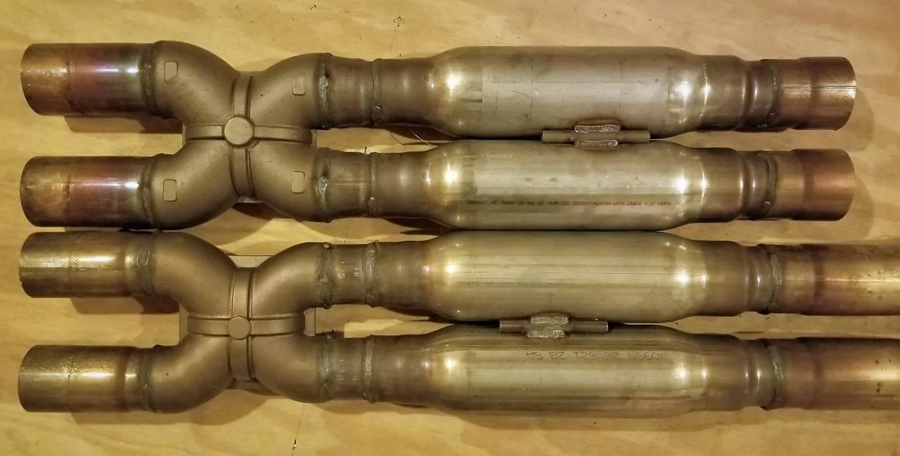

OP, in case you didn't see it I did a writeup on Lethal's resonator delete.
https://www.mustang6g.com/forums/th...t500-stainless-steel-resonator-delete.136134/
Little known fact, the resonators on the GT500 are the exact same resonators that are used on the GT350.
GT500 top, GT350 bottom.
The X sections are different with the GT350 diameter coming in at 2.5" and the GT500 diameter is 2.75". The GT500 gets necked down just after the X (GT350 doesn't), goes into the resonator, and then both bump back up in diameter for the remainder of the cat back.
