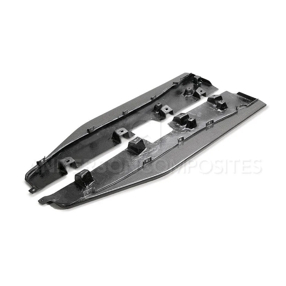

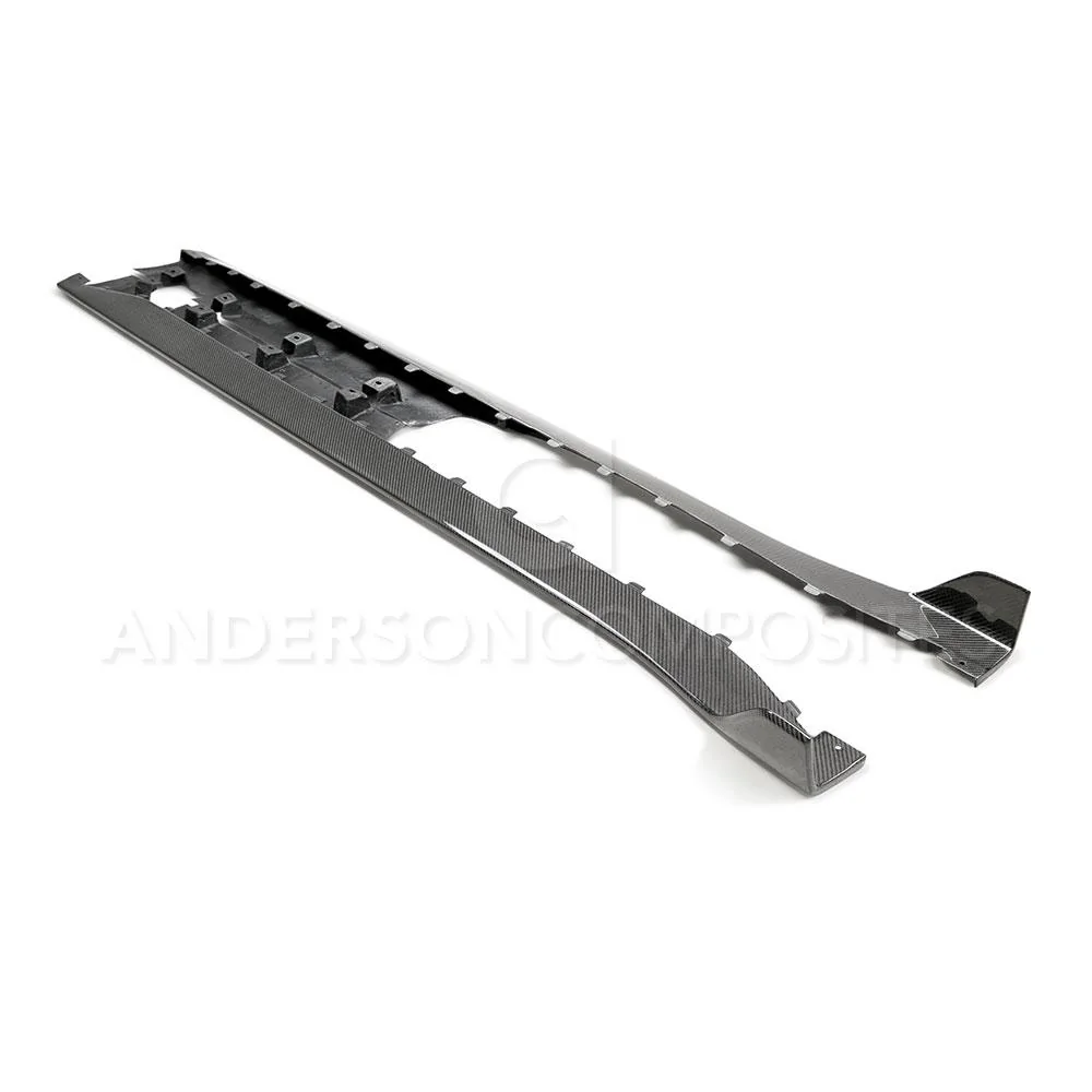

Thank you for sharing these. I had seen them in my research also. It made me think the factory piece would come in separate pieces. I’m surprised the Anderson Composites just replace the factory ones if they are supposedly all connected to the lower rockers as one piece from the factory or at least they is how Ford sells the replacement part.
Has anyone here tried these Anderson Composite lower pieces or taken the factory piece off? Just curious what is really involved.
Thanks again for your help and suggestions.
This is one of the few areas on the car I haven't really looked at. I thought it was two piece. In fact, Anderson Composites sells the pieces separate from each other and they are supposed to mimic the factory parts here - or so I thought.
We tooled from actual GT500 model. The rocker assembly is two pieces. The cutout area as shown in this thread and our website is where the splitter extension goes. Thus, you cannot simply add the splitter extensions to a GT350 or S550 style rocker that fastens in the factory locations. Here's link to our GT350 style rocker installation video for reference.
