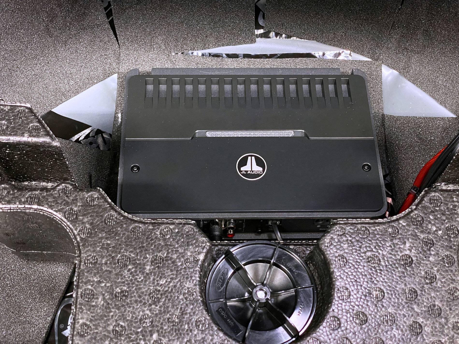

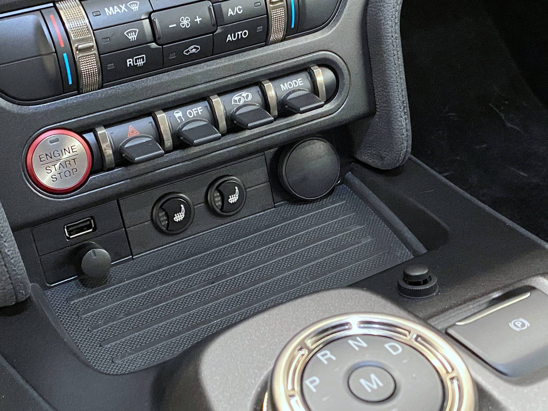

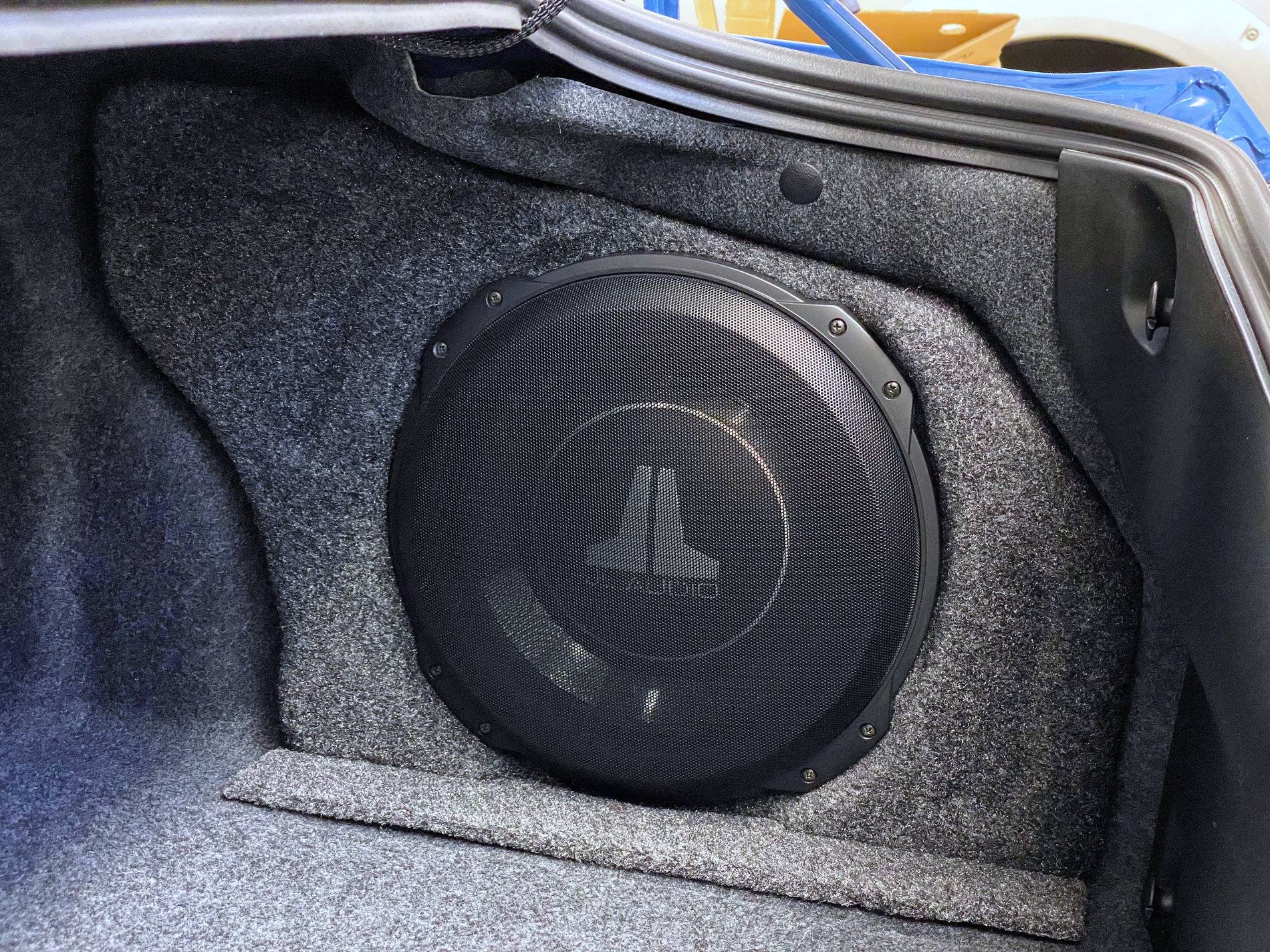

I was going to post this on the mod's thread but I can do it here. I installed the JLAudio Sub that Bulldogs22 posted above. Along with one of their 500 watt mono amps. Added their remote volume control and I have great sounding bass now. I have used this particular woofer in a different enclosure in my Escape but this one sounds better for some reason and I had more power going to it (750 watts).
The install did not take too long but you do or should remove the right front tire and part of the inner fender liner to gain easy access to the boot behind it to run your power wire from the inside to the battery.

Markus, you are a class act, my friend. Gorgeous install of all the components and roger on the tire and fender well for power.
..and I have great sounding bass now.
I should hope so! <smiling>
Questions..(of course)
I couldn't find a 500w monoblock on their site, just 600w and up. Did you already have that amp?
Why didn't you go with one of their subwoofer amps, not enough output?
The amp install won't work for me as I PLAN to give her a real spare tire, just don't know if it'll fit or not.

JL has several 500 watt mono subwoofer amps. This is their low end model: https://www.jlaudio.com/collections...d/products/jd500-1-car-audio-amplifiers-98362. The next one is a step up and the one I got: https://www.jlaudio.com/collections...roducts/rd500-1-car-audio-rd-amplifiers-98618. It is a good workhorse and I did not need to get anything crazy as it is not like I will be in any audio competitions. Then their upper end models, and they make four more at 600 watts and above, are overkill for what I wanted. They are all subwoofer amps.

Yes you can stuff the box and I did and not only that, I covered the entire back end and sides with dynamat so the plastic box would not vibrate so much. While this helped a bit to make the bass tighter, there just isn't the volume there nor doesn't go very deep. You can however, replace the OEM speaker with a JLAudio 10W1-V4 or similar shallow 10" sub and it will make a much bigger improvement. The problem is, then you will want to add and amp to get even more volume. I decided I only wanted to do this once so when with the Stealthbox and a dedicated sub amp.

I picked up the signal from the existing wires going into the OEM sub. There are 4 wires as it is a dual voice coil speaker. There is a green and black wire to one side, yellow and purple to the other. I could have used just one side but I combined the green and yellow (both are +) and black and purple (both are -) and ran them to the input on the JL amp.

Oh, and KB, there is plenty of room in the trunk area for an amp even if you add a spare tire. You can easily mount the amp under the package tray between the two speakers or even behind the Stealthbox there is room if you want to hide it. You can also mount it on the opposite side of the Stealthbox behind the trunk liner. That trunk surprisingly has lots of room.
